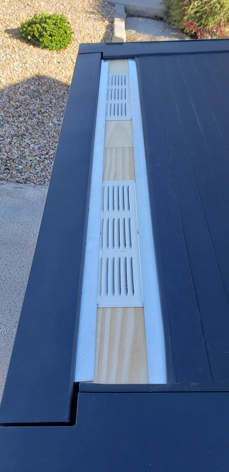

I'm going off-roading in the Tonto National Forest next week with three overnight camping stays planned. Since flies and mosquitoes are likely to be a problem with water nearby (Roosevelt and Apache lakes), I needed a way to ventilate the vault when sleeping to keep the CO2 level down. I made this device to allow air in and keep the bugs out. I made it using two 3/8" thick pine boards, hinged in the middle so it can be inserted into the tonneau tracks on both sides. Common screened soffit/gable vents cover cutouts in the boards. I borrowed the aluminum angle irons from my A/C Lexan insert to add strength to the vent panels. Here it is installed.

Nice engineering!
Some black paint and a small usb powered fan and you are done!

Nice engineering!
(y) on the black paint. I'll be testing it without a fan next week while camping. Hopefully no fan is needed.

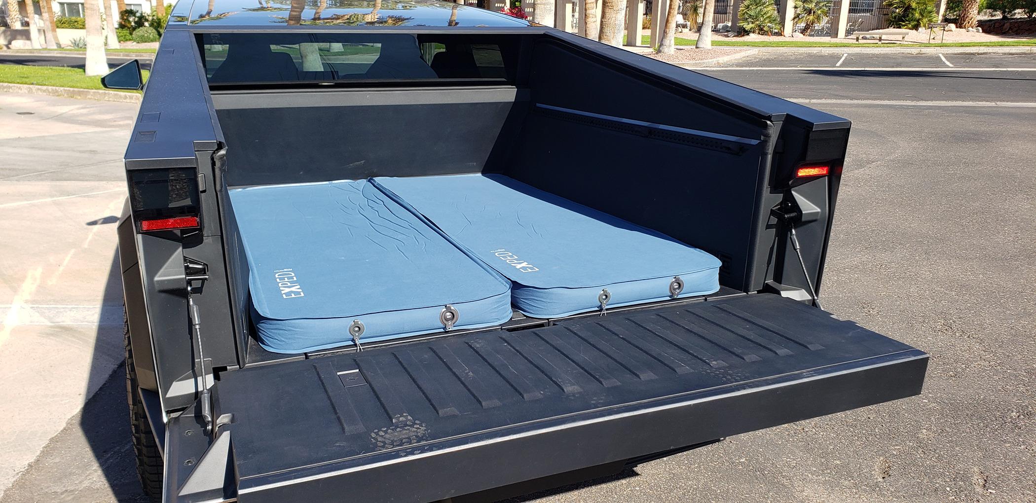

Very cool! I am curious about which mattress you are using. Seems like the more comfortable ones are thicker so could be an issue as far as headroom?
Thanks for sharing!
A.
I use two ExPed 3" thick air mattresses that fit nicely in the vault.
Tesla Cybertruck Vault vent for sleeping CT Air Mattress

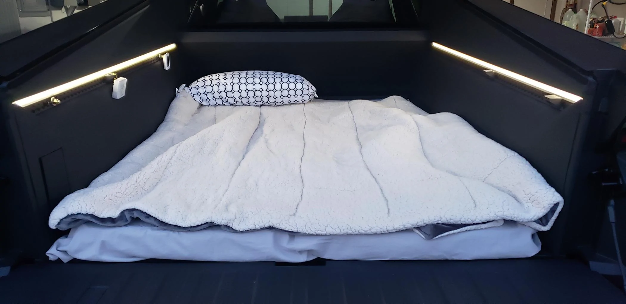

Headroom is not reduced much. After setting up for the night with the tonneau cover fully open, we settle into bed and close the tonneau over us. There's enough room inside to prop up a pillow and read with the bed lights turned way up.
Tesla Cybertruck Vault vent for sleeping Vault Bed 1
