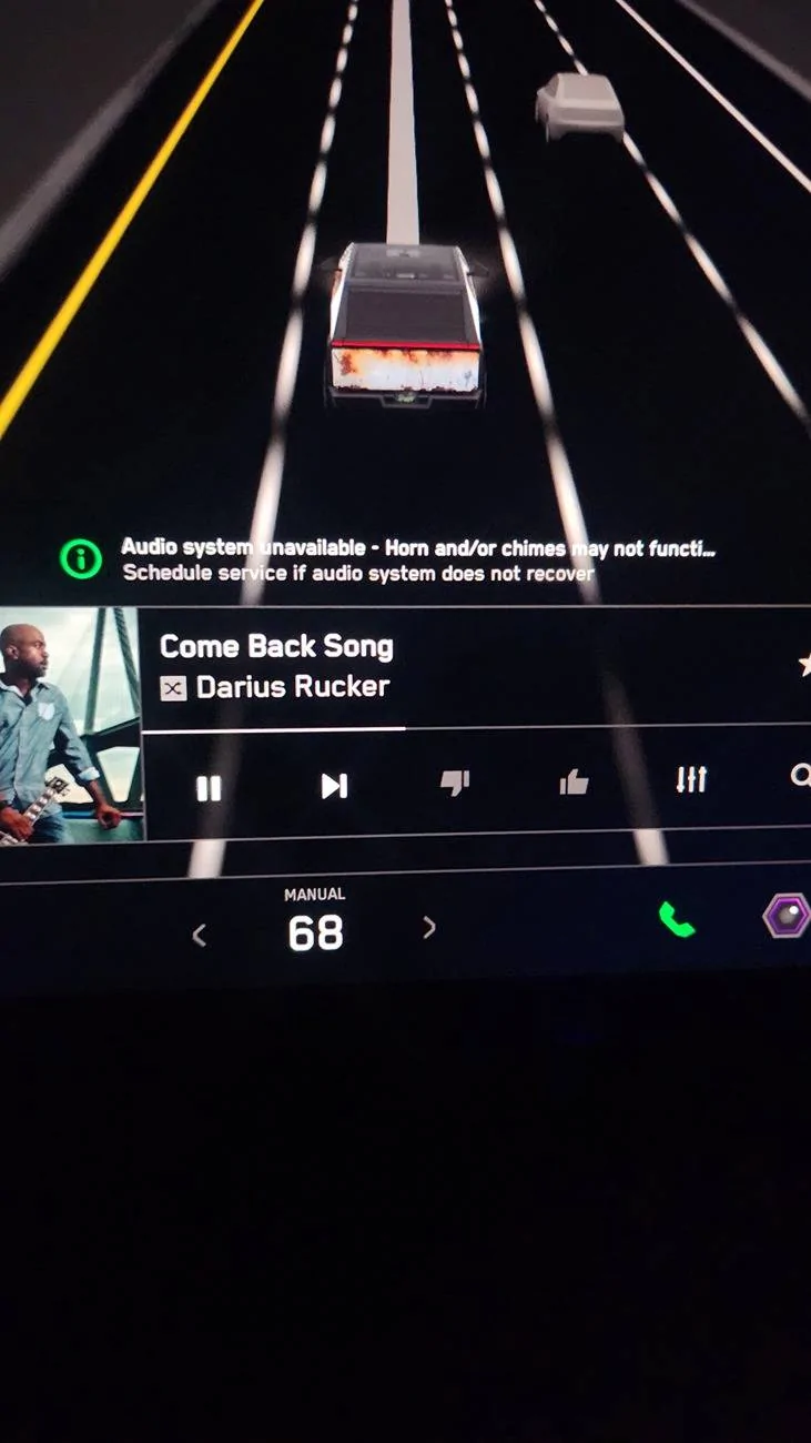

Working with Tesstudio now on issues of sunshade with ambient light.
Caused audio warning in picture which goes away when harness removed
Lost voice commands from steering wheel(got back with scroll wheel reset)
Has squeal when closing
Does significantly lower the temperature
Lowers the roof height where my(5'10") head touches in back seat but plenty room upfront.
Did you get feedback on the audio/horn message? I still have horn and audio - have not checked boombox yet. No issues with the shade other than it is slow to close / open and commands are hard to memorize. Let me know.

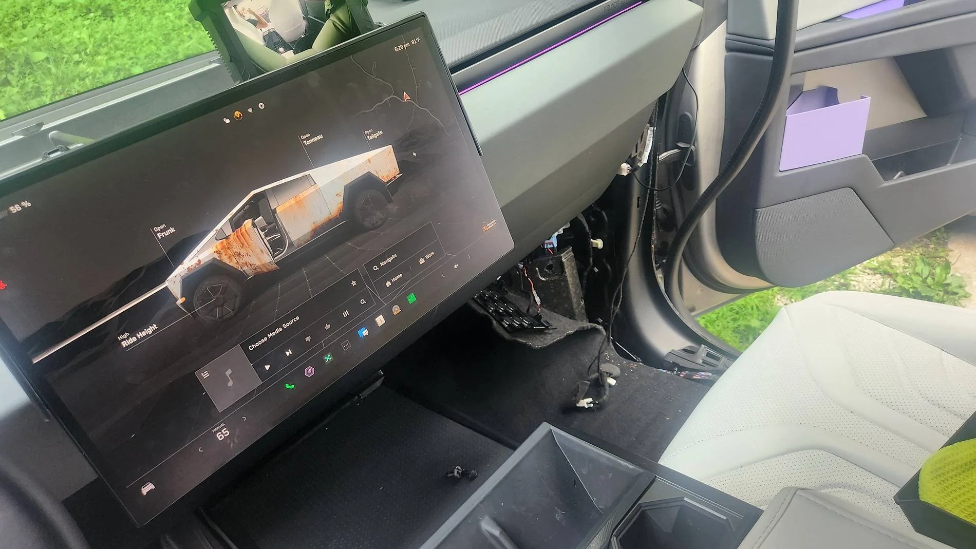

No feed back yet for the warning. I sent a video via WhatsApp because it was to large to send without compressing through email. It does seem like a total disconnect between email and WhatsApp.
Im pretty sure my side mounting brackets are to long. I have to really fight the frame in place and I think it's pinching the frame causing the squealing. They must be millimeters to long because I can still make it work.
I removed the screws and it still squeals but when I dropped the frame from the mounts it quit. Still painfully slow closing and opening.
