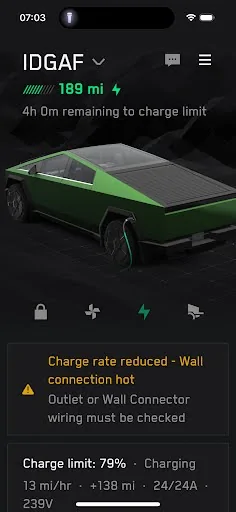

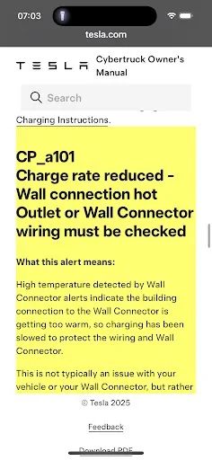

For the past 3 nights my CT slows charging from 48a to 24a reporting a "Charger Overheating" error. It's a 220v x 60 amp circuit attached to a 2018 Tesla wall charger installed for my Model 3 installed in 2018. The electrician installed a new meter and breaker box the wiring runs about 50 feet in my basement and goes out to the garage.
I've entered a SC ticket and called an electrician.

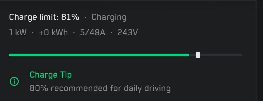

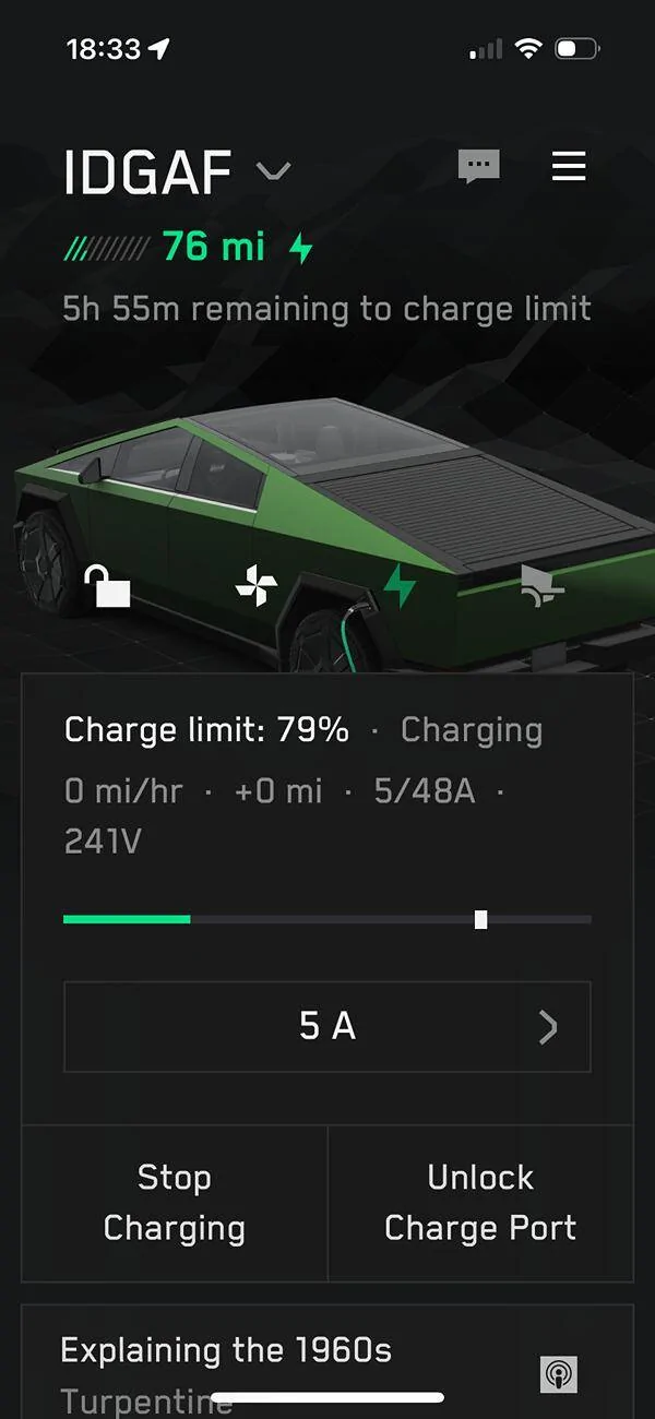

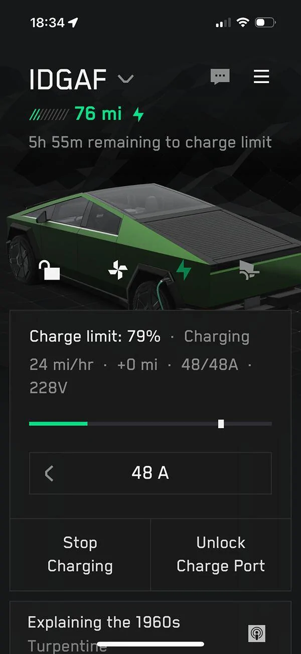

With the app or center display, crank the charge current down to 5A, note the voltage, then go to 45 and note it again.
Tesla Cybertruck Wall charger overheating, charging slowed SmartSelect_20250515_095804_Tesla
Tesla Cybertruck Wall charger overheating, charging slowed SmartSelect_20250515_095829_Tesla
I have a 9 Volt drop from 40A, so about 0.25 Ohms of resistance which isn't great, but it's a long run from the transformer.
A high drop can indicate a bad connection which creates heat.

I had this same issue. WC installed in 2019 and started getting the same error. Connections were torqued to spec and problem went away.

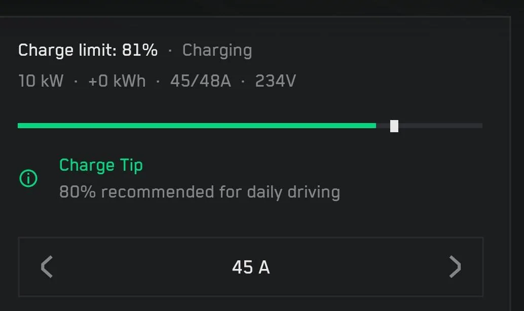

Thanks I have an electrician buddy coming by tomorrow and will look for loose connections as I did test and it dropped from 241v to 228v

That's a lot, especially if it's an attached garage. If the 48A voltage gets lower as it charges that really points to a bad connection.
