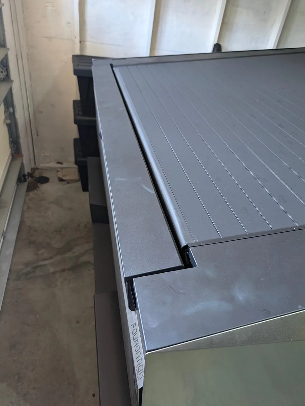

Warning to everyone about hauling items. I was hauling a load of 12 foot composite decking boards today. I made sure that the weight limit was not exceeded, however, since the load shifted, it obviously put too much weight on the tailgate and now the tailgate is warped. Fortunately still shuts but it clearly bent the stainless steel and it now has a gap.
So caution about this possibility. Perhaps I should have known, but alas I was unaware of the potential.

Warning to everyone about hauling items. I was hauling a load of 12 foot composite decking boards today. I made sure that the weight limit was not exceeded approximately 2200 lb. However, since the load shifted, it obviously put too much weight on the tailgate and now the tailgate is warped. Fortunately still shuts but it clearly bent the stainless steel and it now has a gap.
That sucks.
Was it on top of the tailgate or something? The bed has the weight rating, I don't think it applies to the tailgate.
At least it's a part that can just be replaced. Going to be $$$.

Boards were as far in bed as possible until the truck accelerated faster than should (using traffic aware cruise). I should have been driving manually very carefully which I did the rest of the way. However, I'm pretty sure when it lurched forward it shifted the load. Note to use chill mode IF using TACC probably would be ok. And yes I'm sure a new tailgate is not cheap...

So was the tail gate down or were the boards resting on top of the closed tail gate?

Tailgate was down and agree the bendy composite boards sliding further out was definitely contributory.

Yes hoping it will be possible to adjust the closure mechanism. There is also some bend in the stainless steel
