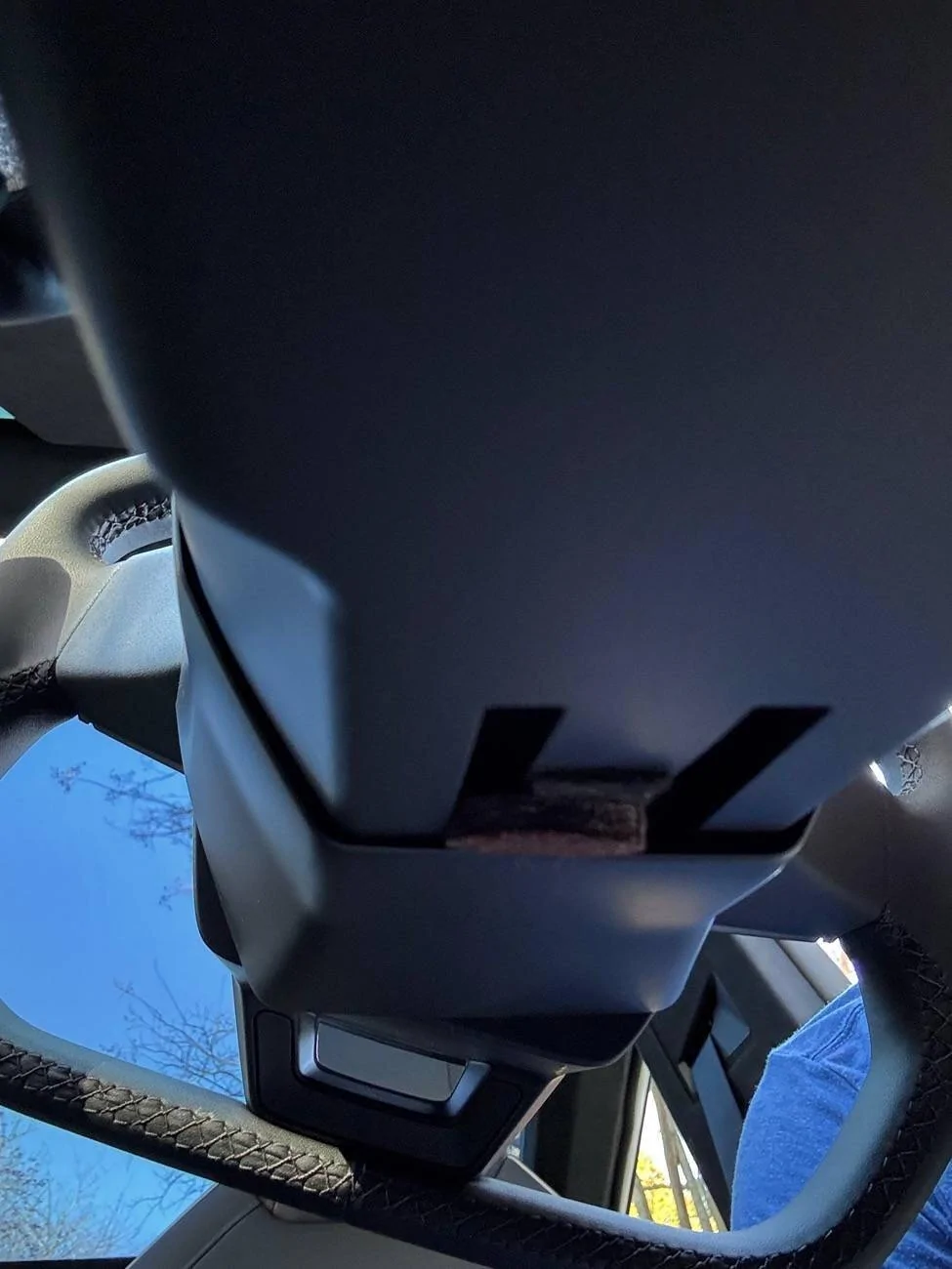

This solved it for me:
https://www.cybertruckownersclub.com/forum/threads/solved-a-rattle-issue.31159/#post-548104

I think the sound is coming from outside and doesn't sound like it's plastic rattling.
