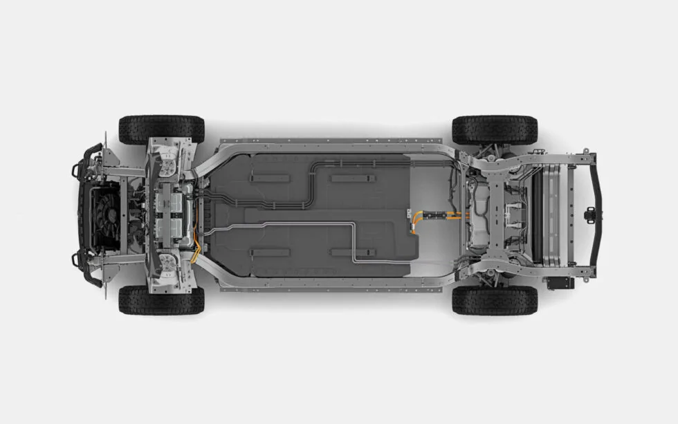

Is the Rivian body on frame? I’m assuming it is but as I started writing this I realized I don’t know this for sure.
I believe a main reason for going with exoskeleton was so it could weigh less. I would guess the weight savings to be significant to justify the radical change from the norm. With these assumptions I expect many of us will be surprised when we learn the actual weight.
Body on frame weight shifted to heavier SS exoskeleton. Can't see it being a huge weight saver.. Especially when you add on the larger battery, windshield and motors. Weight savings to get it to stay approximately the same weight and not be 1.5x heavier than the body on frame version, not to be 1.5x lighter than the body on frame version.
Rivianā€˜s design most closely resembles a body on frame design with the batteries between the widened rails.
