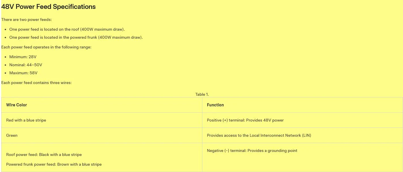

What is the max amp power rated for the 48v in frunk?

400W max for 28V or 58V? I hope for 58V.
What if I overload the feed? I guess there's a fuse box for it, right? Is it easy to access the fuse box to change the blown fuse?
If you don't already know the answer I would highly advise not fiddling with aux power on your own lol.
Tesla only uses fuses for HV.

There is over-current protection. I use the frunk 48V feed for my air compressor and it trips the breaker when I plug it in. Easy enough to reset it from the control screen. I've found that if I plug the compressor in first, and *then* enable the 48V power, it doesn't trip (must allow for some inrush current upon startup).

Interesting behavior. My Jackery Powerstation does the same thing with high current startup devices. I have a powerful shop vac, that I tried running with it. Had to do just like you found. I had it turned on; then I powered the 120vac circuits on the powerstation.

most likely 58v
