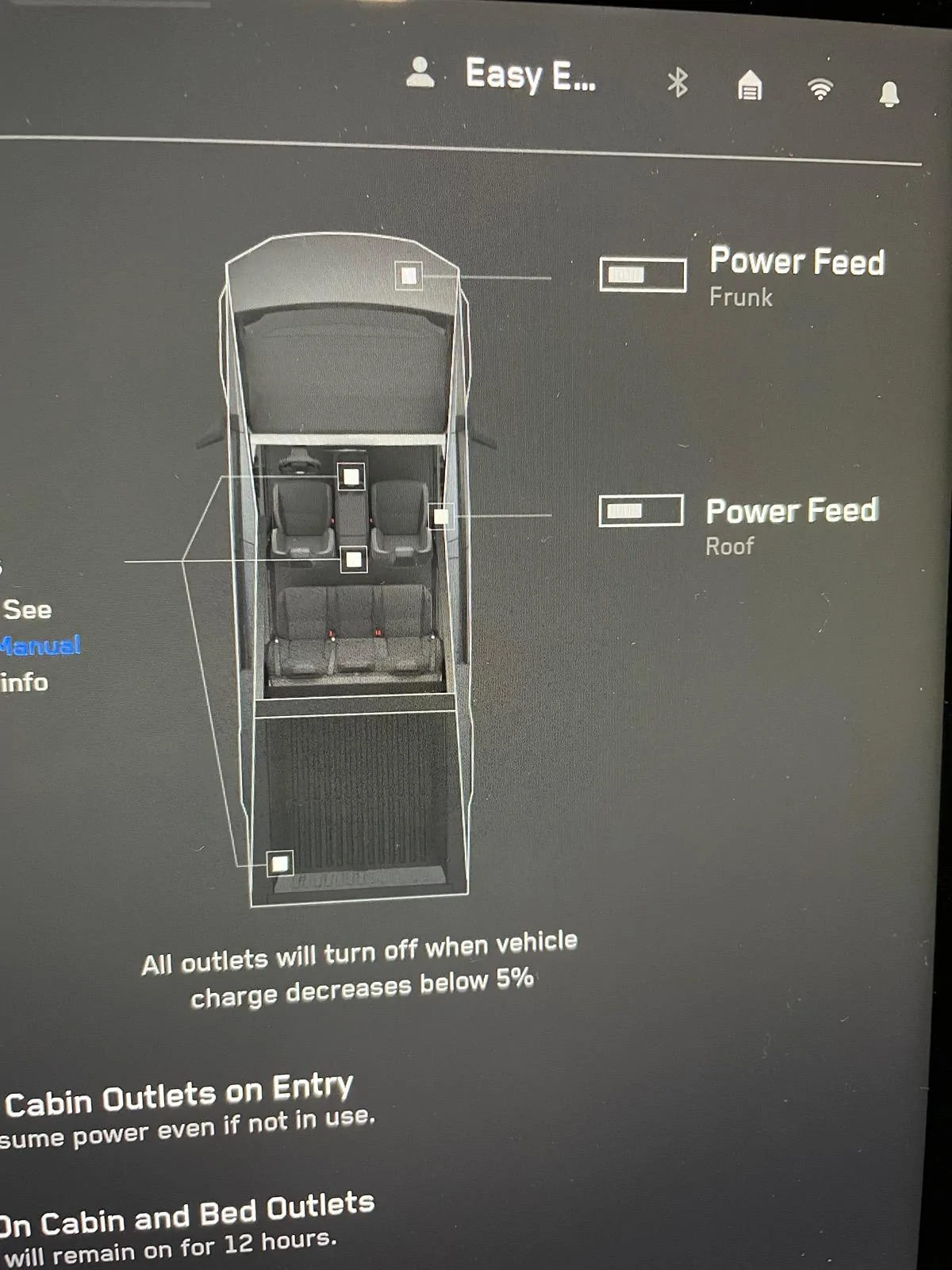

Don't see any outlets there. So what these power feed for? Thanks

This is a guess on my part, but I'd assume that the power frunk and rear cover power can be turned off? No outlets there that I've heard of.

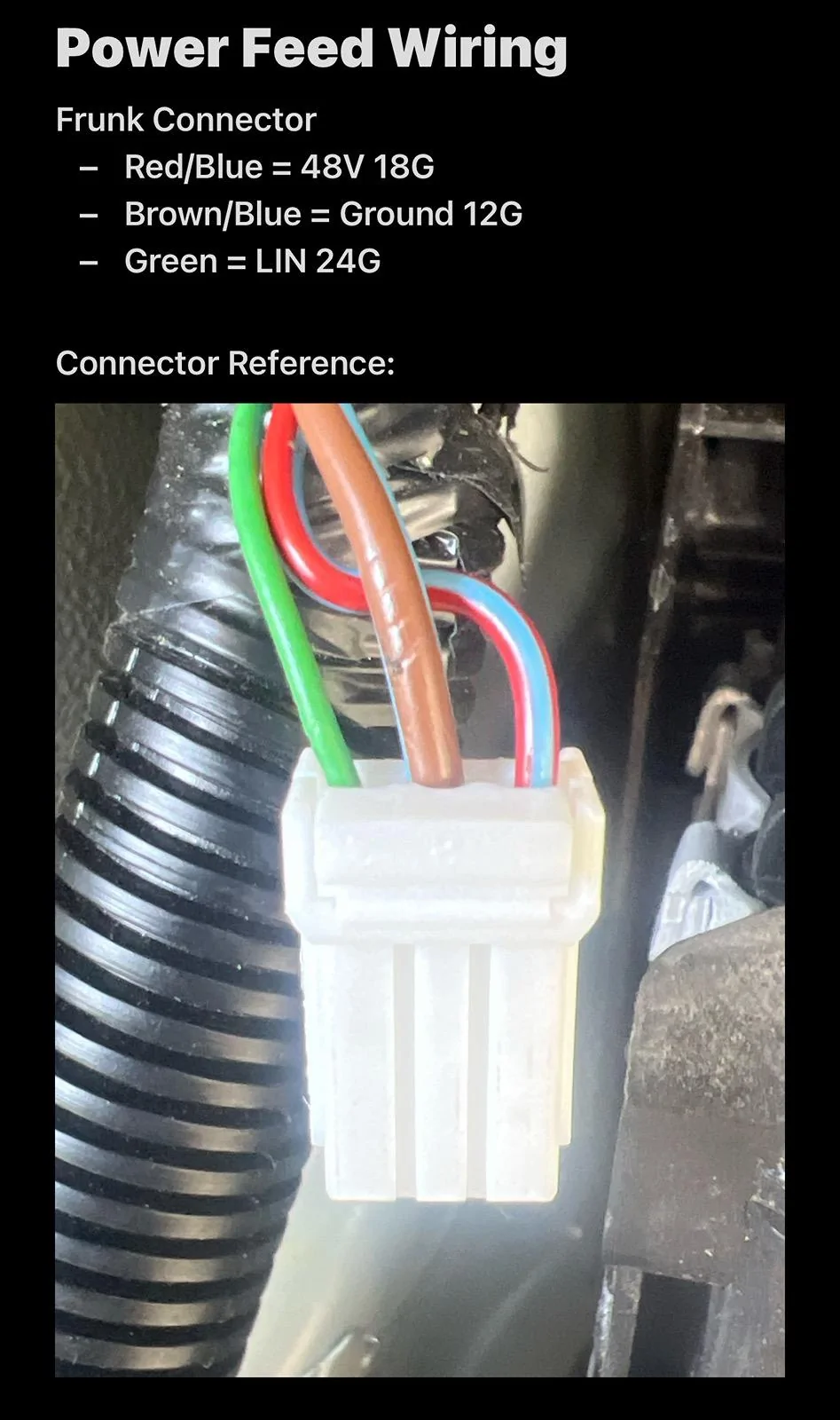

No outlets, just bare wires under the trim in the two locations shown that provide 48V power. The connector in the picture is my addition for quick connection to a couple of accessories I keep in the frunk. Not sure what can be done with the LIN wire yet as there is no documentation in the manual, but these are turned on and off with the power feed toggles in the screen or in the app.
