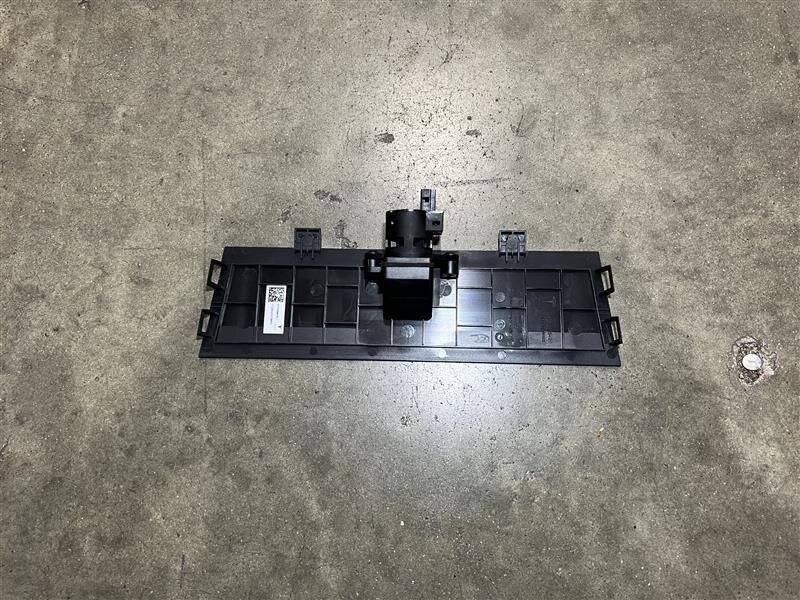

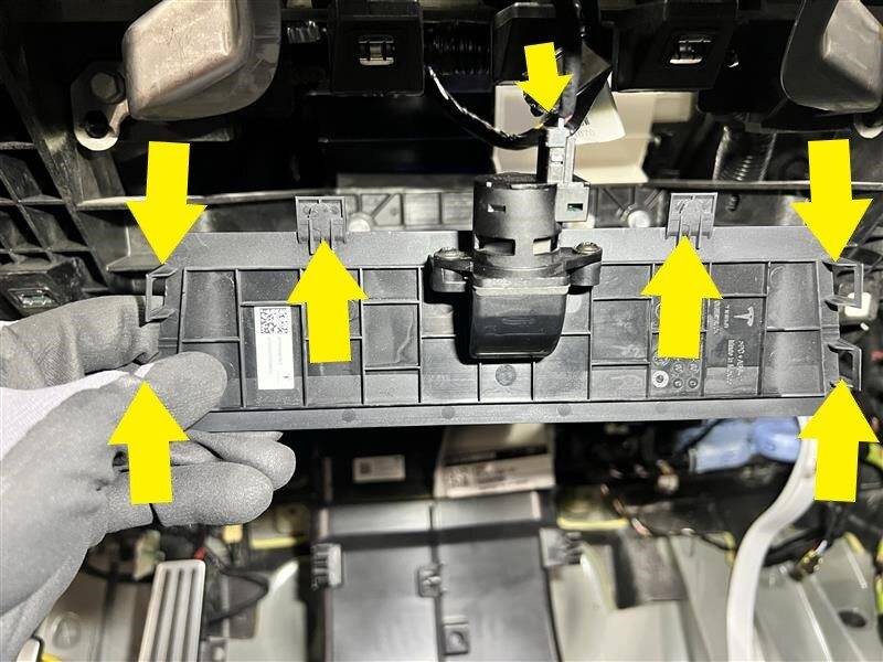

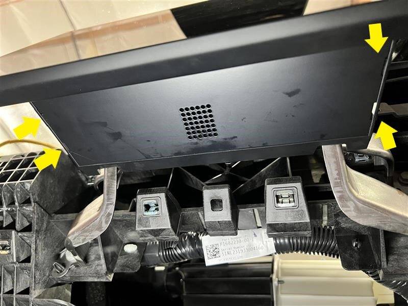

The Cybertruck Service manual has a whole procedure to remove and re-install the panel it's connected to, but doesn't say what the device is that it houses: https://service.tesla.com/docs/Cybe...UID-E86A9772-BDD3-491C-A1E3-41D16715C4C3.html
My first thought was cabin temperature sensor, but everything in the service manual related to cabin temperature points to that being a fan-driven sensor buried in the ducting inside the dash: https://service.tesla.com/docs/Cybe...UID-8CCBFA6A-540C-45D0-BDFF-D938C055BD64.html
So then what is this thing?

According to the onboard wiring diagram, it's a cabin temp sensor.
