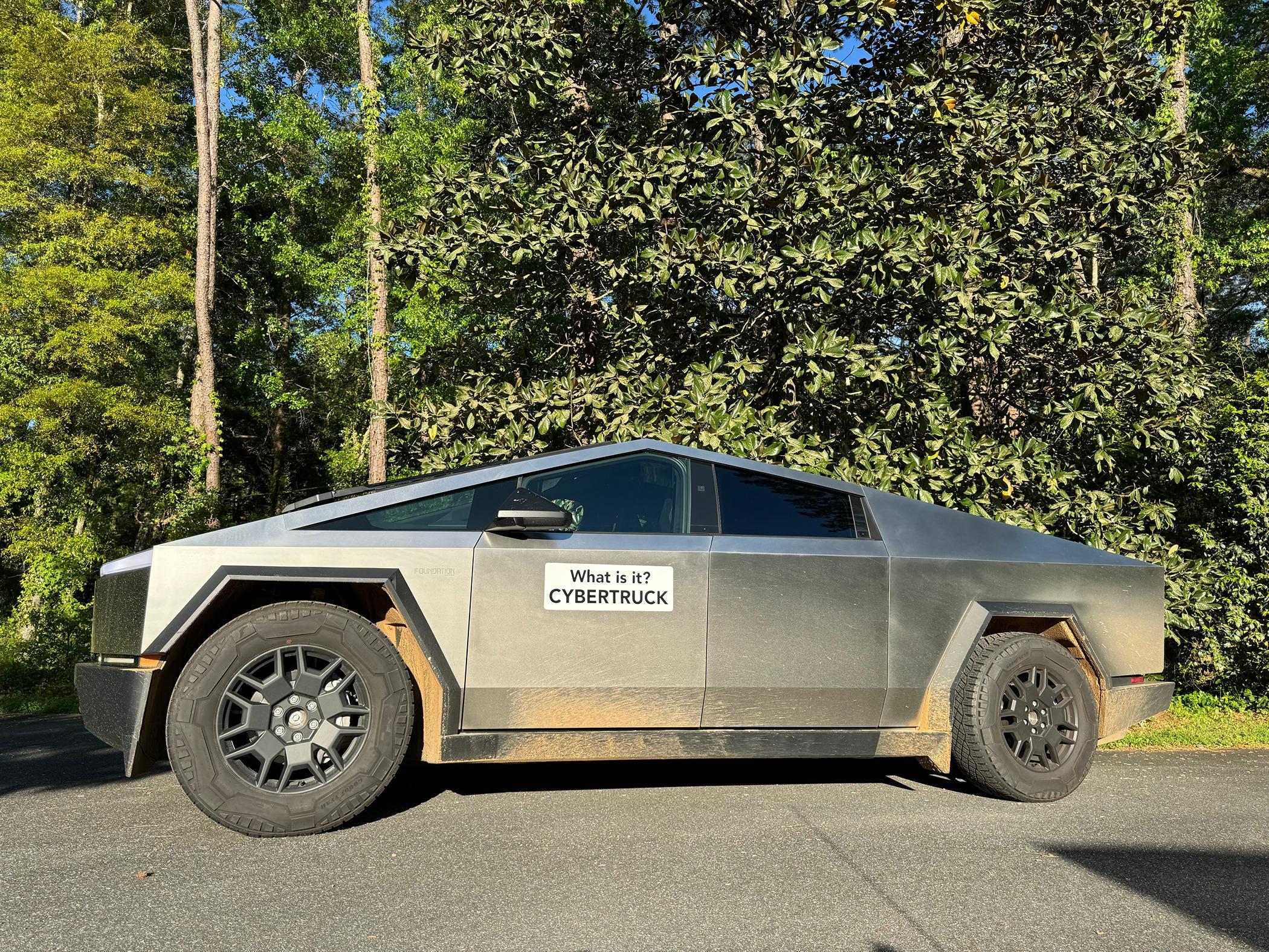

I've found that the doors, which are thicker, are more magnetic than the thinner body panels. I attached a magnetic sign to the door today and it has stayed in place while driving 24 miles at speeds up to 45 mph. I wouldn't take a chance though on something with high wind resistance.
