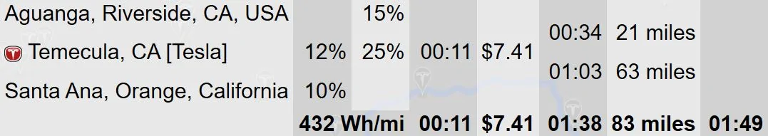

I used 'A Better Route Planner to figure a ballpark. A 13% charge (11 minutes) shows as $7.41 (68 cents per minute). 13% is very close to 1/8, so 0 to 100% (at this rate) would be about $59.
Tesla Cybertruck What will it typically cost to recharge a dual motor at a Tesla charging station? abrp.JPG
Seems really high, but that is what I get. Anybody want to check my numbers?

It isn't a question of checking your numbers. It is a question of where you charge and for how long. If I charge (X100D) from 14% to 54% at Robbinsville, N.J, ABRP says it will take about 17 minutes and the charge will be $4.57 for about $0.268/min. Noting that I have picked up 40% SoC that implies $11.42 to fully charge the battery (100 kWh) which means that this station sells electricity for about 11.5 cents per kW/h.
OTOH if I were to charge from 10% to 87% at Brattleboro, VT ABRP says that it would take 47 min and cost me $18.29 implying $0.425/min, $23.75for a full (100%) charge and, thus $0.238/kWh.
Now last time I actually did charge at Brattleboro is was 20% to 82%, took 43 minutes, consumed 61.1 kWh and cost me $18.29. That's $0.427/min and $0.299/kWh implying that a full charge would be $29.50.
A charge at Baie St. Paul from 47% to 89% consumed 41.33 kWh in 40 minutes and cost USD $14.37. Thus this station sells electricity at effectively $0.347/kWh or $0.359/min so that a full charge would be $34.21
All these numbers are appreciably less than what ABRP shows for you but electricity in California is expensive!
Your approach using ABRP is the only way to answer your question until you actually operate a BEV.
