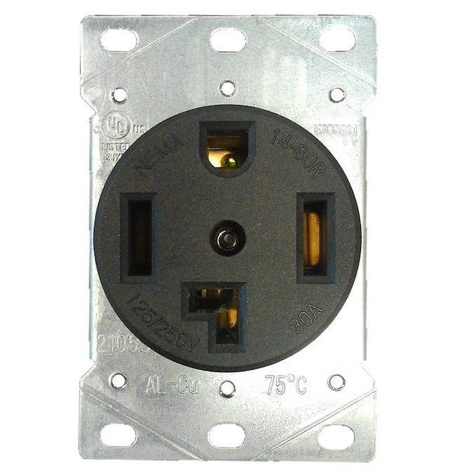

We own a Model Y and I completed the electrical installation myself. I was lucky that I had a 30 amp, 220v outlet in the garage that wasn’t being utilized since we have a gas dryer that uses a 120v outlet. This is basically what I did and it cost me under $50;
-Purchased a NEMA 14-30 220v, 30 amp outlet at Home Depot for around $10
-Turned off the circuit breaker for the 220v dryer outlet and verified with an electrical tester that it was off. I removed the old outlet and installed the 30 amp NEMA 14-30 outlet.
-Purchased a GEN 2 14-30 adapter from Tesla online for $35
-The Model Y comes with a 120v outlet with the car. You simply unplug the short 120v connection and plug in the 220v 14-30 Tesla adapter to the Tesla electrical box that comes with the car
-Your now ready to charge your Cybertruck!!!
I have set our Tesla Model Y to charge the 2170 battery cells up to 80%. Our Dual Motor model is rated for 326 miles so it charges until it hits 260 miles of range. That is plenty of range for our driving needs. Battery experts claim that the Lithium Ion batteries should only be charged to a maximum of 80% for longevity reasons.
I also lowered the charging amperage from 30 amps to 24 amps (80%) so it’s gentler on the battery cells. You can change the settings very easily in the display under “charging”.
My current setup charges our Model Y batteries at roughly 20 miles of range per hour. I have attached photos of the 30 amp 220v NEMA 14-30 outlet and the Tesla GEN 2 NEMA 14-30 adapter that I purchased.
