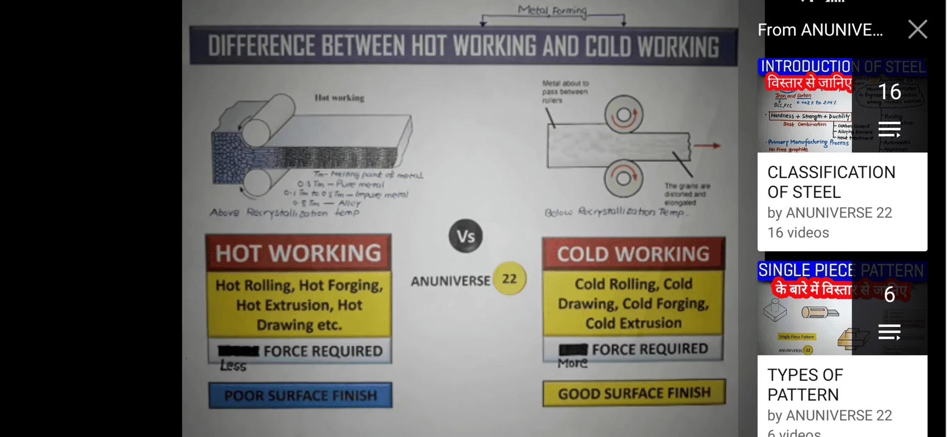

My impression was that it was cold rolled 30 times to both work harden and get the desired thickness.
Cold working stainless steel makes it magnetic
I also heard Elon say that they have to score the backside of the material at a fold for the machines to even be able to bend it.
Yes, think laser scored, bent and reinforcing weld at bends.
