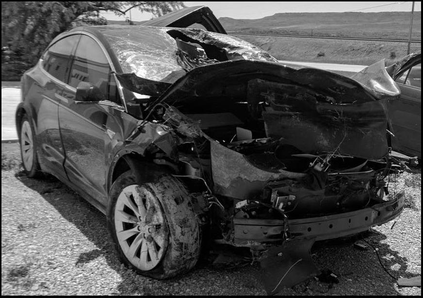

Wish it was in the Tesla Model X. Windshield cause: deer. Front end was ditch afterward.
