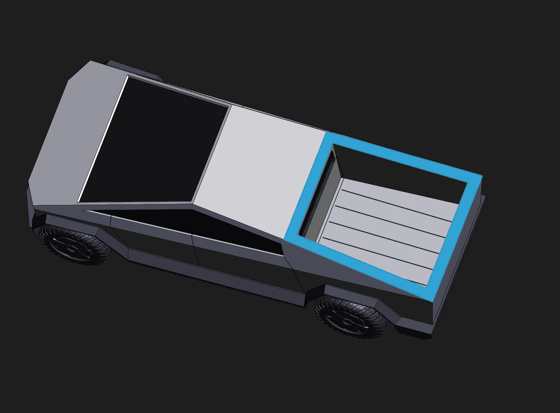

e.
Thinking Cybertruck might be semi-submersible, I am thinking of penetrating (with a drill, oh, no!) this area... Dunno about how one can fish a cable that route. :( Thanks, KN6KEZ

I am guessing there will be access opportunities, even if a drill is still needed, through the side sail compartments. Guessing, no actual knowledge.
Oh, that's a good call!
164
10,719
26,998
Side sail doors are mysterious in terms of sealing/opening/closing. My guess is that there will be a big surprise in that compartment, mostly electric-related.
This is the big problem with trying to plan for a car nobody has driven. We haven’t even seen them actually open the sail pillar doors yet. For all we know the frunk, sail pillars, and under vault storage don’t work at all on the prototype. (This is my assumption actually)

As a radiodummy I would try to use entire body of CT as an antenna. Or at least some lids/covers insulated from the main body.
Also the metal strip, connected to the cable inside, could be tape insulated on both sides and attached with double sided tape passing outside under the lid of the frank or side compartments.
After all antennas always look ugly.

Not a dumb idea at all. You are talking about a "slot antenna" in which is slot is cut out of a conducting sheet and the sheet driven appropriately. The radiation pattern is the same as that of a metal structure of the same shape as the slot.
