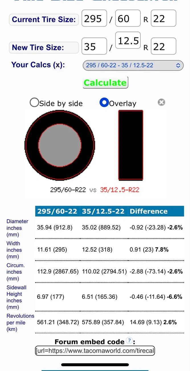

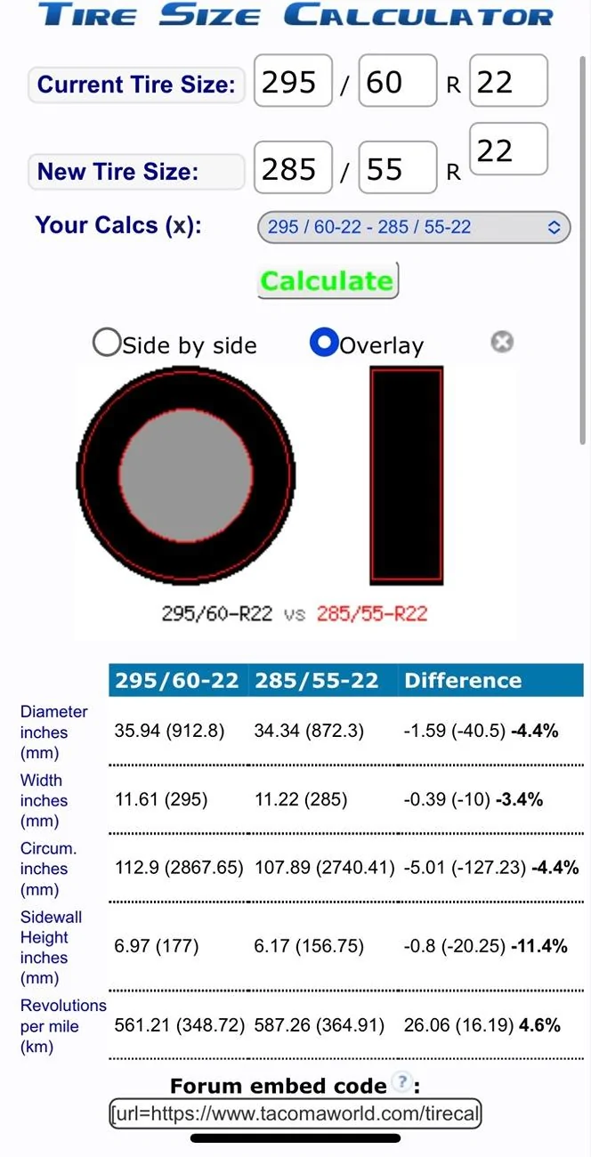

Has anyone Ran a 295/60/22 ?
Looks to be almost an inch bigger than the 35x12.5/22 and the 285/55/22 . Both of those I’ve seen on the truck and most of the aftermarket CT put those one, guy at the tire shop that’s done a few CTs said 295 should fit

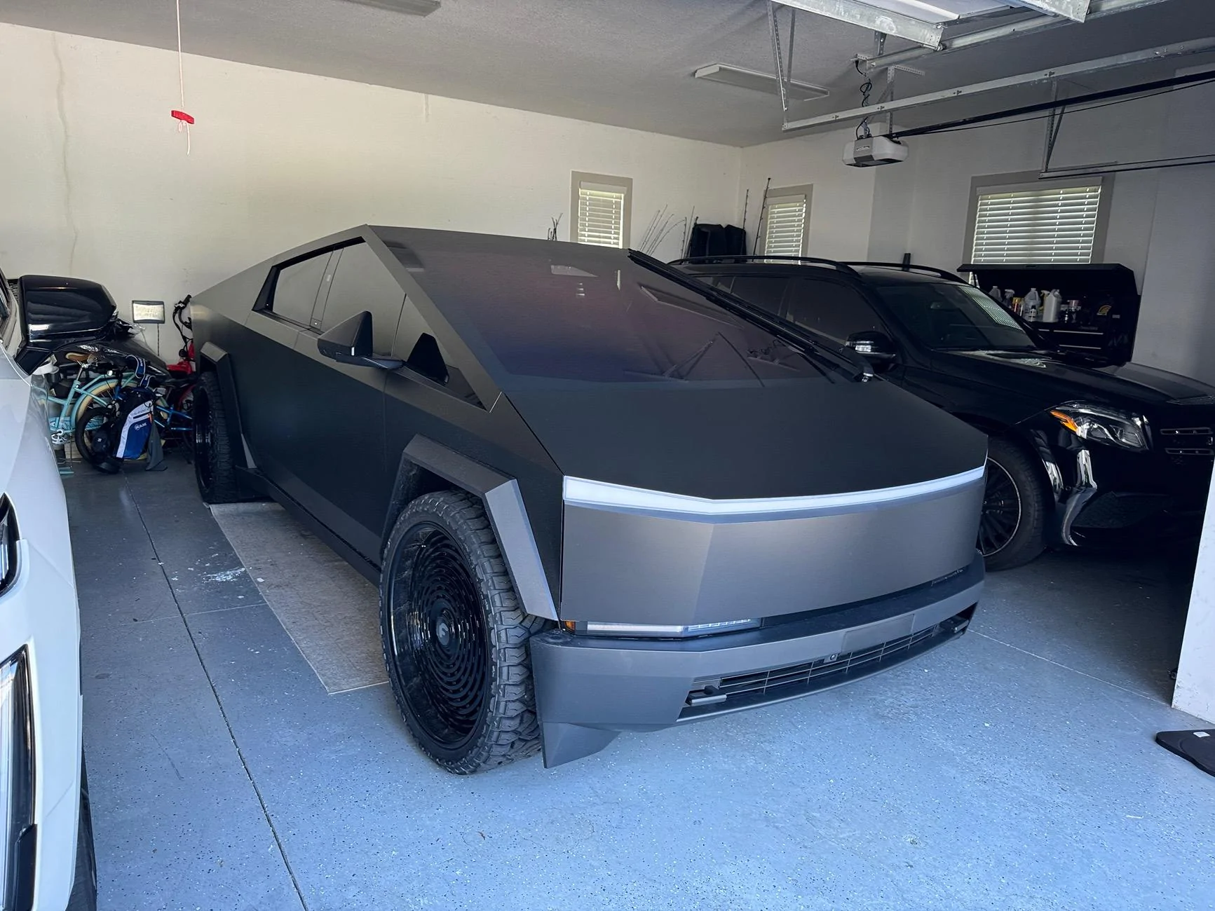

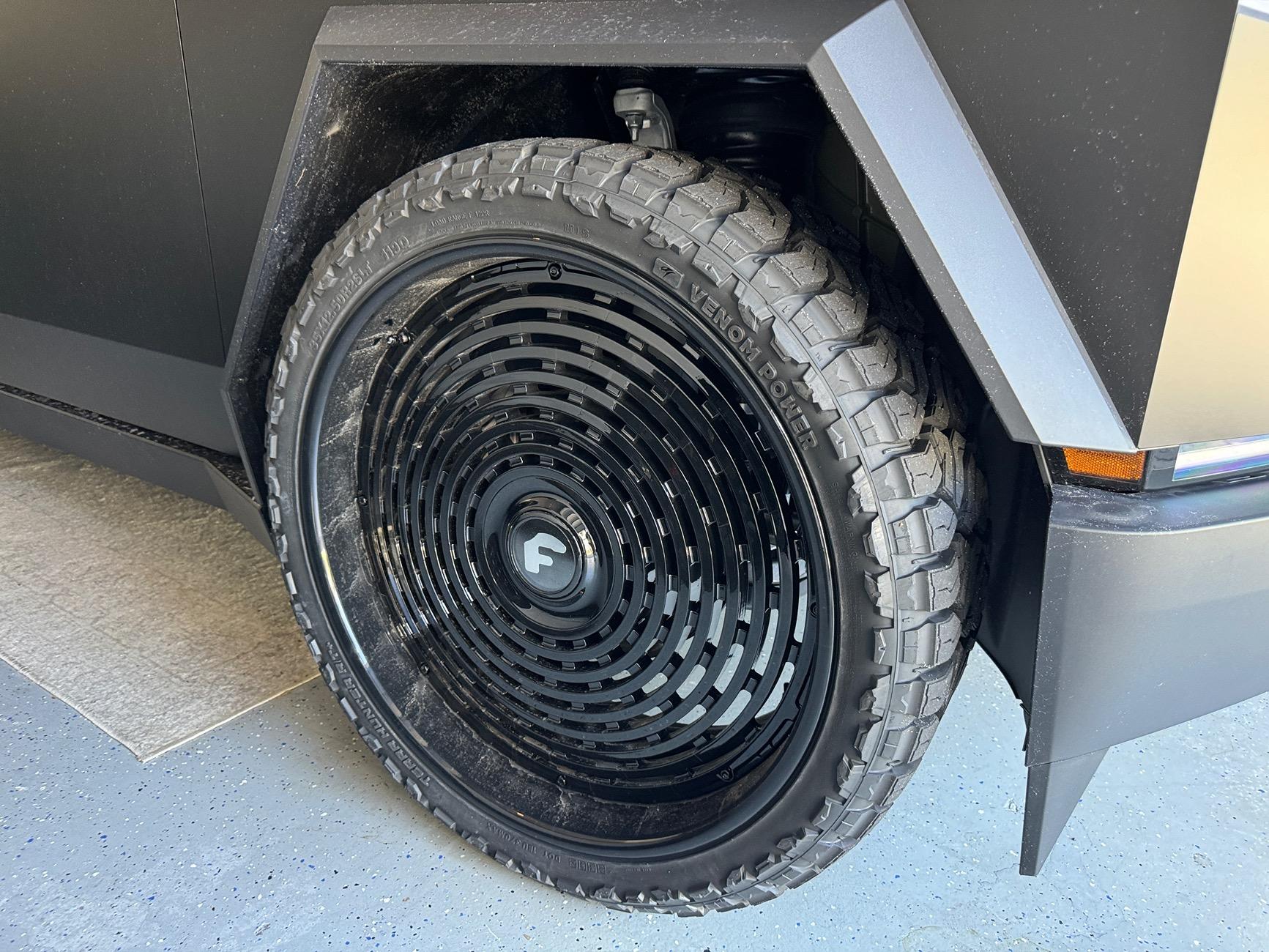

My buddy is running 26’s on his, here is his setup. I don’t know much about wheel and tire setups, but hope this helps
Those low pros will probably give much better range. But those are some of the ugliest wheels I’ve ever seen.
Na those are just 26” wheels the tires he has are still 35x12.5. Thanks though. That’s definitely a different look.

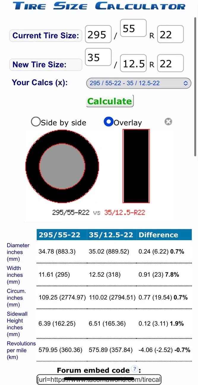

I am not aware of any 295/60r22 tires, are you sure you didn't mean 295/55r22? This would also be a much closer total diameter to stock than 295/60r22 and should fit without much issue. This is also a very expensive tire size. Are you aware you'll be spending $600 per tire for that ratio? It's just not a used size. 285/55r22 will also fit well and be half the cost. Just food for thought

Offset and wheel width?
Well that might explain why I don’t see them 😆. I just assumed because on my 2500hd I have 295/60/20 that they would have a 295/60/22. I guess you are correct a 295/55/22 is 1/4 smaller in diameter then a 35x12.5/22 and almost 1” not as wide. Just was on the fence if I liked the 35x12.5 but think maybe that’s going to stick out a little bit to much for me
35x12.5 is a classic! Nowadays I never run 12.5 unless I'm planning on doing deep snow, slush, or serious mud 😂. I've converted to the pizza cutter crowd despite swearing I never would. Good luck!
Those wheels are quite nice! I would love to see the holes as cybertruck triangles though.
