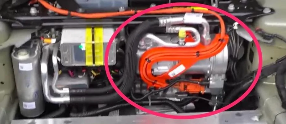

A heat pump is a device that pumps heat against a temperature gradient. An air conditioner is a heat pump! The only difference between what the layman calls a "heat pump" and what he calls an "air conditioner" is a reversing valve which allows the refrigerant to flow compressor exhaust --> heat exchanger A --> metering device --> heat exchanger B --> compressor suction OR compressor exhaust --> heat exchanger B --> metering device --> heat exchanger A --> compressor suction.
Your mistake is a common one. Teslarati posted an article announcing that a Y owner had discovered the "heat pump" which article contained this frame from the guy's video.
Obviously he thinks the thing he has circled is the "heat pump". It is actually the compressor which is, of course part of the heat pump system but my X has one of those too (also located behind the frunk tub) and so do the S and 3. If you follow the two tubes/hoses from the top of the compressor to the left you will see them attach to another component to the left of the square box with the yellow tape. That is (I assume) the reversing valve which is what distinguishes the model Y heat pump from the ones in the other models (they don't have it0. Because of it the Y can not only pump heat from the interior of the car to the outside but can also pump heat from the exterior of the car into it.
What distinguishes the heat pump in my X from the heat pump in the Y is that the latter is the first application by Tesla of a reversible heat pump. Thus the person discovering the heat pump should have circled the reversing valve.
So I am thinking that it is you who should have looked up how a heat pump works (Wikipedia would have straightened you out in the first couple of paragaphs). Had you done so, of course, you would have deprived me of the opportunity to post the picture.

He kind of stumbles and bumbles a bit. The thing he calls a compressor at the right end of the cylinder is the motor/inverter. You can see the battery wires going into it. He says that the left part of the cylinder is the "body of the heat pump'. It isn't. That's actually the compressor. The compressor takes low pressure gas from the large (suction or suction) tube and compresses it to much smaller volume and consequently much higher temperature which it pushes into the exhaust (high side) tube which is the smaller diameter one. The two tubes then go to a valve assembly which directs the hot gas to someplace to which heat is to be delivered. The hot gas condenses to liquid there and the valves/plumbing send that liquid to wherever it is the heat is supposed to come from where it boils and the gas from there gets sent back to the suction port of the compressor through the large tube which he does say later on. , sends liquid from that place to another from whence this heat is supposed to come At least that's the way it is on every system I've ever seen but that's really not that many. The only thing that strikes me as being strange here is that the thing with the yellow cap is a service port and right at the compressor output strikes me as kind of a wierd place to put it. Where's the low side service port?
Just another observation: the battery looks bigger than the little motorcycle batteries in the other Tesla cars.
