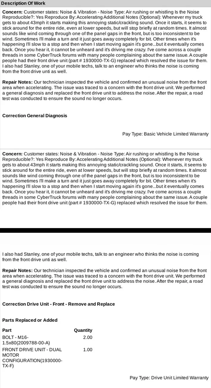

Can you post the invoice from when they replaced the FDU? I’d like to see the tech notes and also how you worded the symptoms.
Black306
Oct 18, 2024
774
1,606
Sacramento
‘26 PAWD CT | ‘23 M3 RWD
This is what I put down in pretty much all 4 invoices….
Concern: Customer states: Noise & Vibration - Noise Type: Other
Is the Noise Reproducible?: Yes
Reproduce By: At highway speed
Additional Notes (Optional): A metallic noise, like a bad bearing, is coming from the front drive unit area. This is not the normal gear/motor sounds. The noise is heard at approximately 35-55mph and most prevalent at approximately 45mph when the motor is cold. Noise is heard when cruising or regen. Noise is not heard when accelerating.

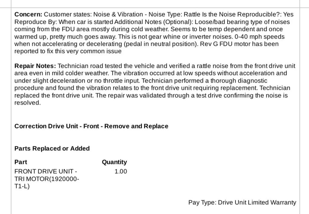

Update on my Beast: Tesla replaced the FDU to the latest FDU rev L and I can confirm the bad bearing, flutter, crackling noises are gone, plus it’s much quieter overall. South County St Louis Tesla did a GREAT JOB!
New Update: I can confirm after driving with the new FDU the last several days what I noticed immediately, it feels like I have a new Truck. Since the Cyberbeast’s primary mover is the FDU, this new FDU REV L makes the Truck feel night and day from the original! The POWER DELIVERY is totally changed in all the best ways. Smooth, quiet, more efficient, and faster. Immediate linear power right from the start. The original FDU while also making all the extra noises was Jerky and slower to react especially when it wasn’t warmed up. That’s my 2 cents. Get this new REV-L if you have the issues I had and are described in this post, and have a Beast, you will love it.
