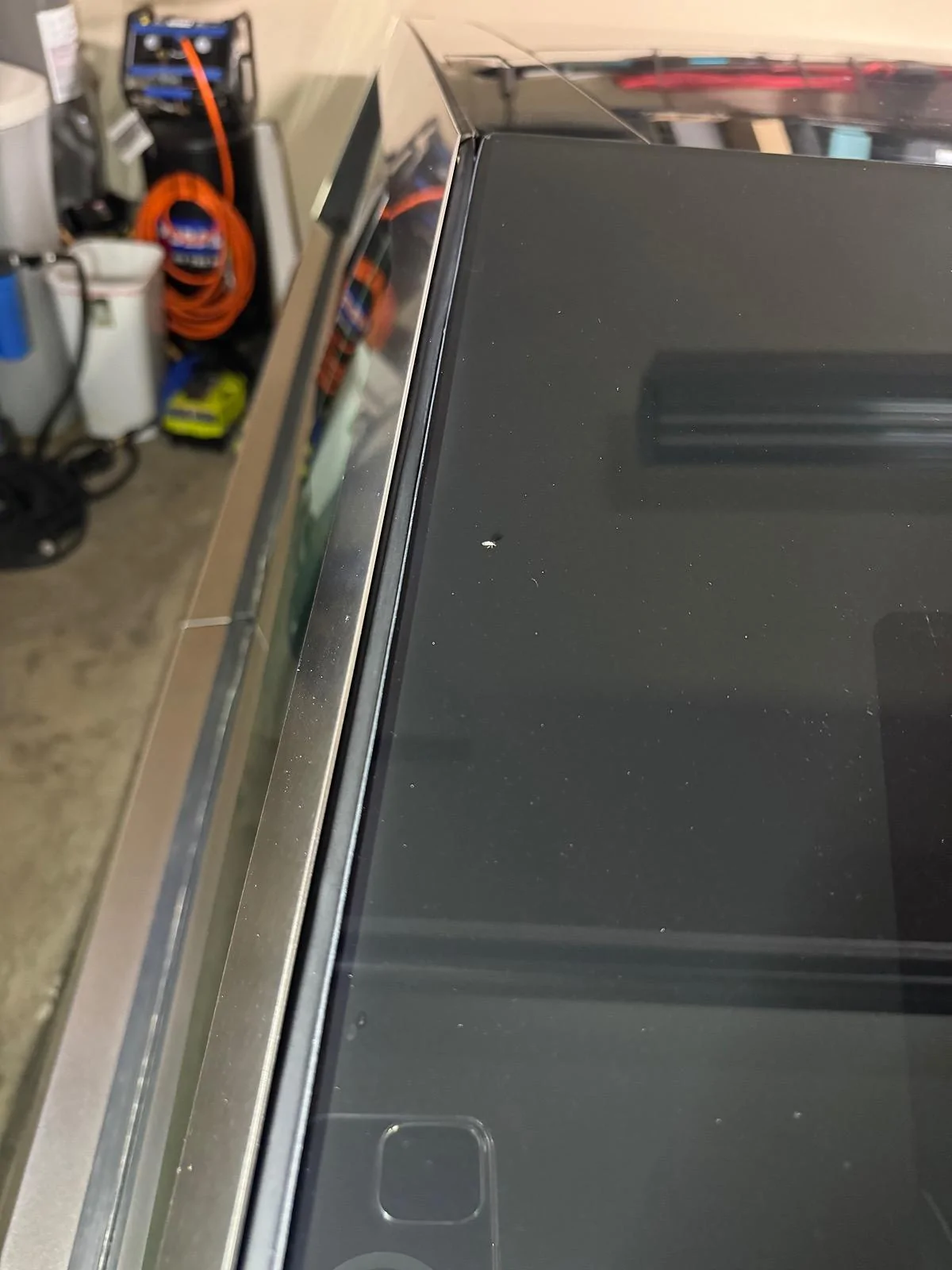

I have the same issue, on delivery I noticed the rubber seal on the upper right side of the windshield looked deformed.
Took the truck to California and on the freeway for the first time and at 80-85mph is was really annoying and super annoying Tommy passenger.
On the way home, I put a strip of painters tape and wedged it in where the seal was deformed and was way better but still could hear it some.
My appointment has been pushed back twice as they’re waiting for parts.
I’ve pressure washed the truck 3 times already and no water is leaking in that I can see.
just have to wait for the appointment and hopefully it’ll get fixed.

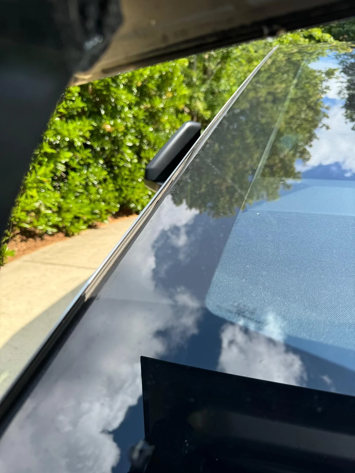

On the lower right side of my windshield I noticed the rubber seal has sunken in between the glass and the stainless steel. I suspect this is the source of the wind noise

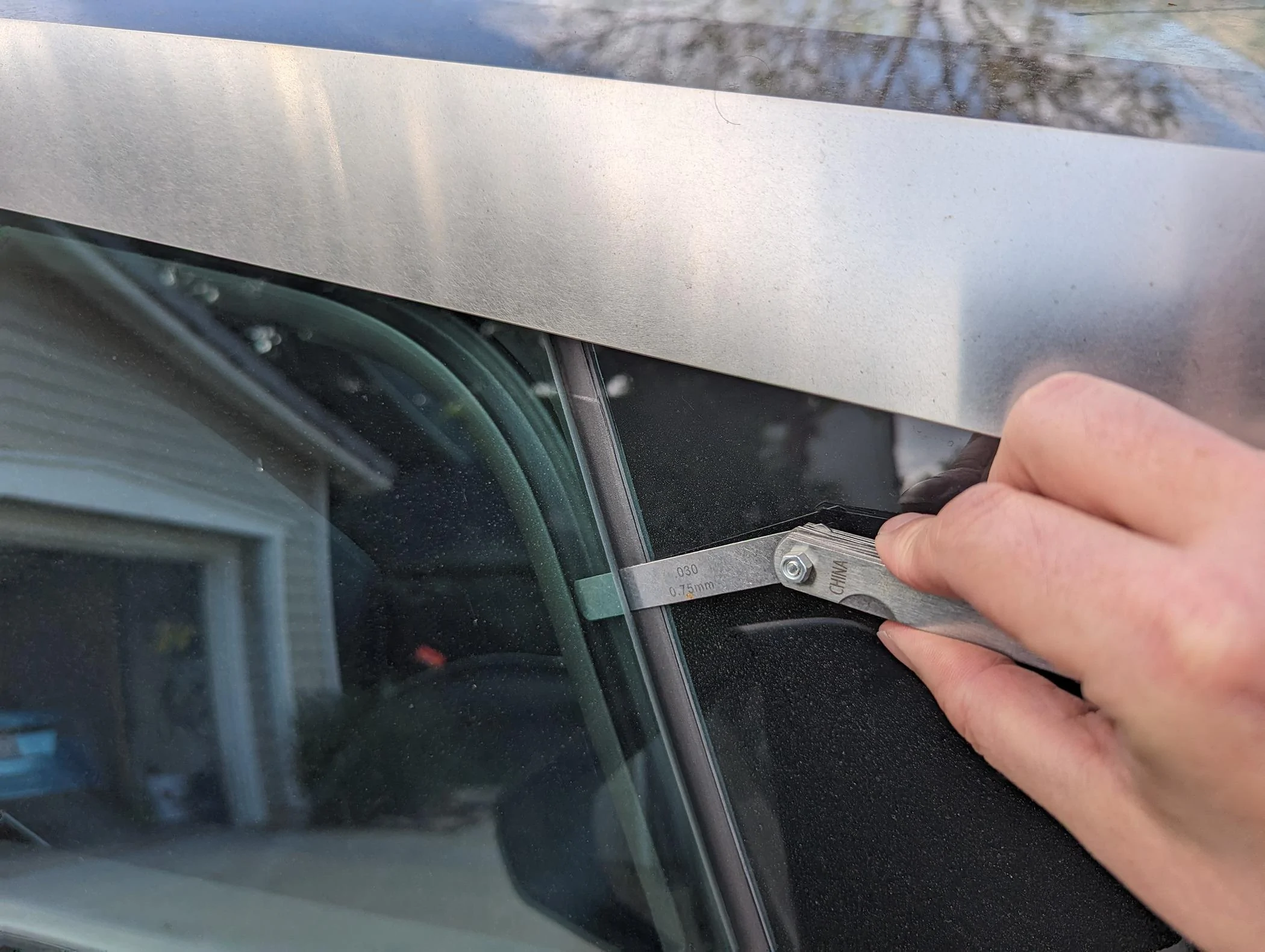

I noticed wind noise coming from my passenger side window as well. Driver's side is whisper quiet. I noticed there is a gap between the window glass and the seal on the passengers side. Enough so that I can fit a .75mm feeler gauge in between the window and the seal without making contact almost all the way up and down. There is a secondary seal behind it but it does lead me to believe this has something to do with the noise.
I can also easily fit the feeler gauge in on the drivers side as well, but it is pushing the seal away and there is no visible gap in resting position unlike the passenger side.
Haven't taken it in yet, but was curious if anyone else noticed any gaps on their windows.
