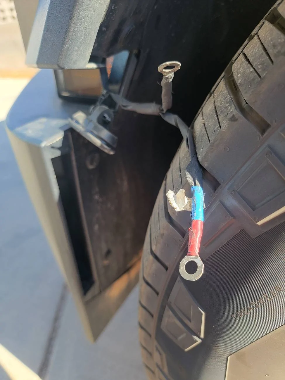

What is this? I electrical taped the leads and put them back in and re-seated the plug, I think.

Pop in back in you might need it one day

OK, service forgot to replace. It went into repair because Power Conversion System failed completely at 443 miles and first Supercharger visit. R&R. Charge at home before.

Emergency jump if totally dead. SC guy said they are using it on CT off train. They are dead. Jump to wake up truck.
