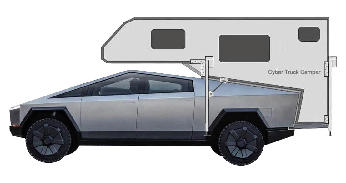

Would the wedge style camper below be better?

Sure! All that matters is that to maximize range, it needs to present the best curve while traveling.
For some people, yes. For other people, no. It really depends on your use-case and where you camp.
Both hard-sided and popup truck campers are available for conventional trucks, and folks choose the one which fits their needs.
Personally, I would prefer a hard sided camper because one of my use-cases with my TT is quick R&R at highway rest stops when crossing the vast distances of prairie which exist between me and interesting geography. Having everything set up and ready for a quick break is important, as is the non-tangible feeling of being separated from what's happening outside as the big kids come and go.
However, it's easy to imagine that someone else might camp exclusively in remote places and wouldn't care about my use case.
