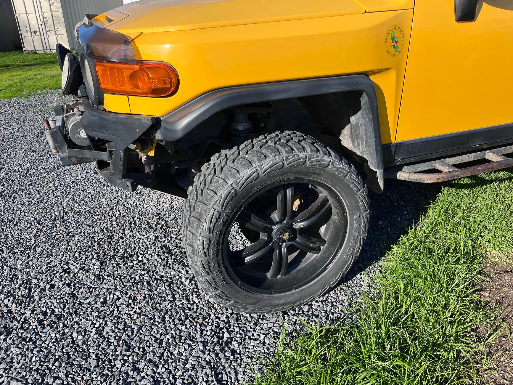

22 x 9 American Racing Trench wheels 35” mud hogs. Poor FJ averages about 2k a year and tires will rot before they wear much. Bolt pattern matches but hub is different.
Tesla Cybertruck Would these wheels fit on my cybertruck IMG_4230

Please don’t try that. Even if those wheels are lug centric, proper hub size still matters. It will put a lot of strain on a lot of parts if the wheels aren’t supported by a hub and it will make for a shaky ride that will cost you way more in the long run than a set of tires.
