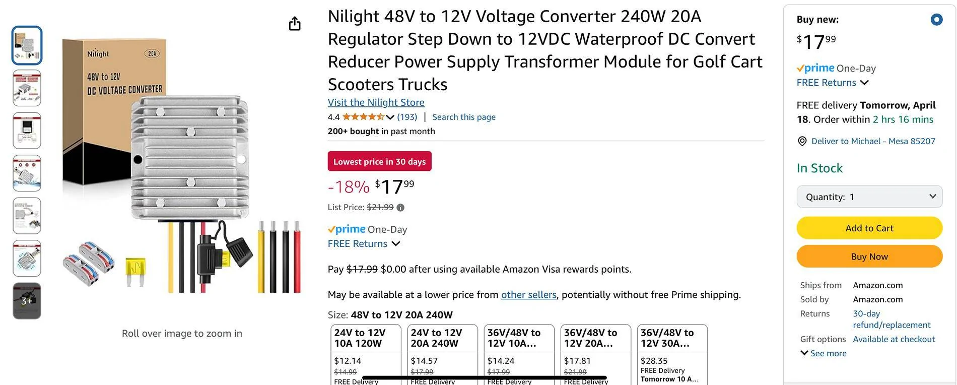

Well, not sure if this will help you or not but I just swapped out the 48v to 12v stepdown they provided and installed a new one. It has only been a day but it fixed my issue (so far).
Before, a few seconds after turning the frunk power on, it ALWAYS went to reset. I could trick it by un plugging the power to the running board control modul, turning the frunk power switch on, and then plugging the power back into the control module. That would last anywhere from a few hours to a day but the switch on the screen always went back to “reset”. When I installed the new step down and then turned the switch on it stayed on and did not go into “reset” mode.
I will need a few days to see if this is a permanent fix.
Below is what I swapped it out with.
Yes. I literally ordered one on Amazon 2 days ago and switched that out earlier today and it works now!
