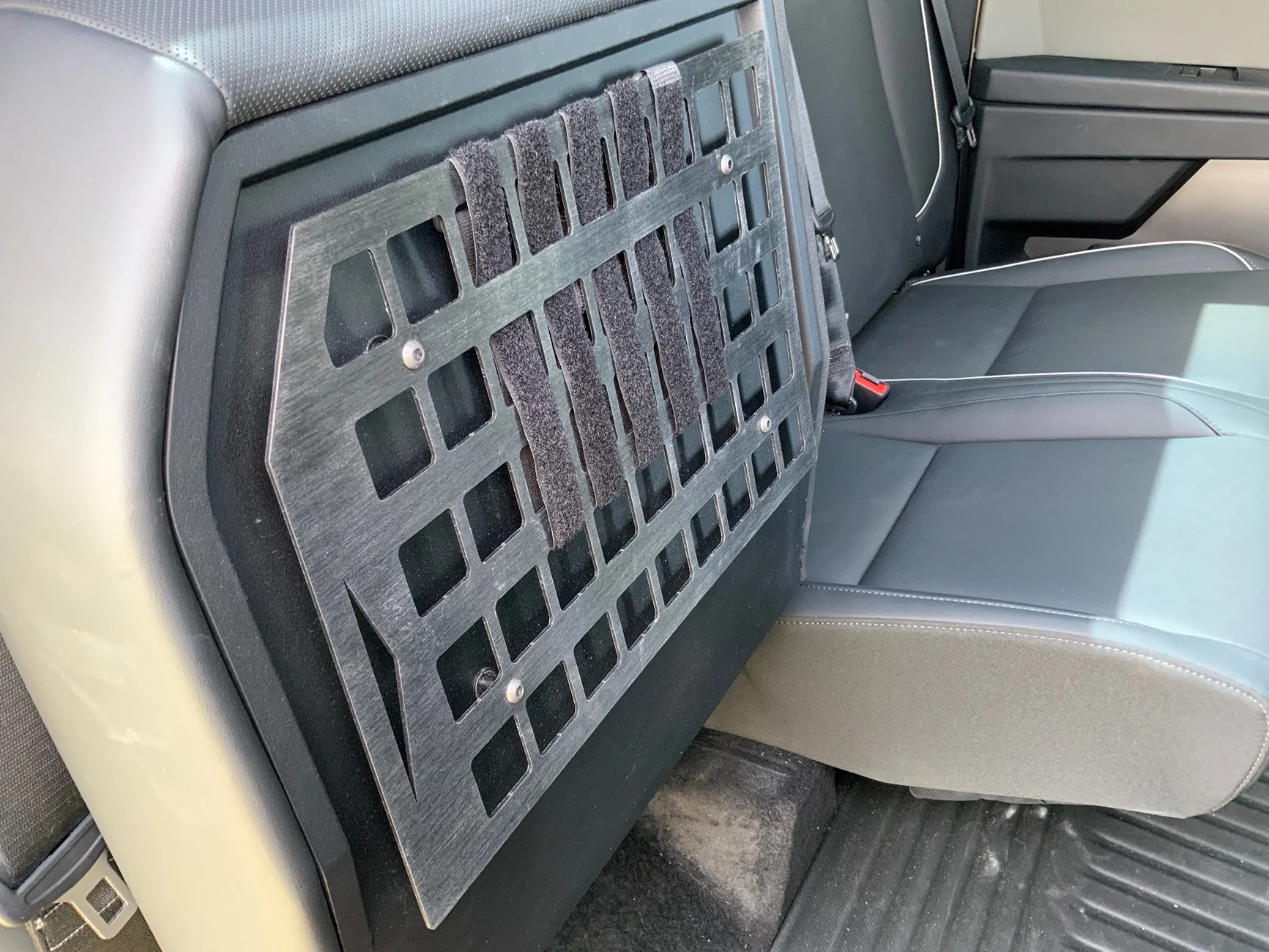

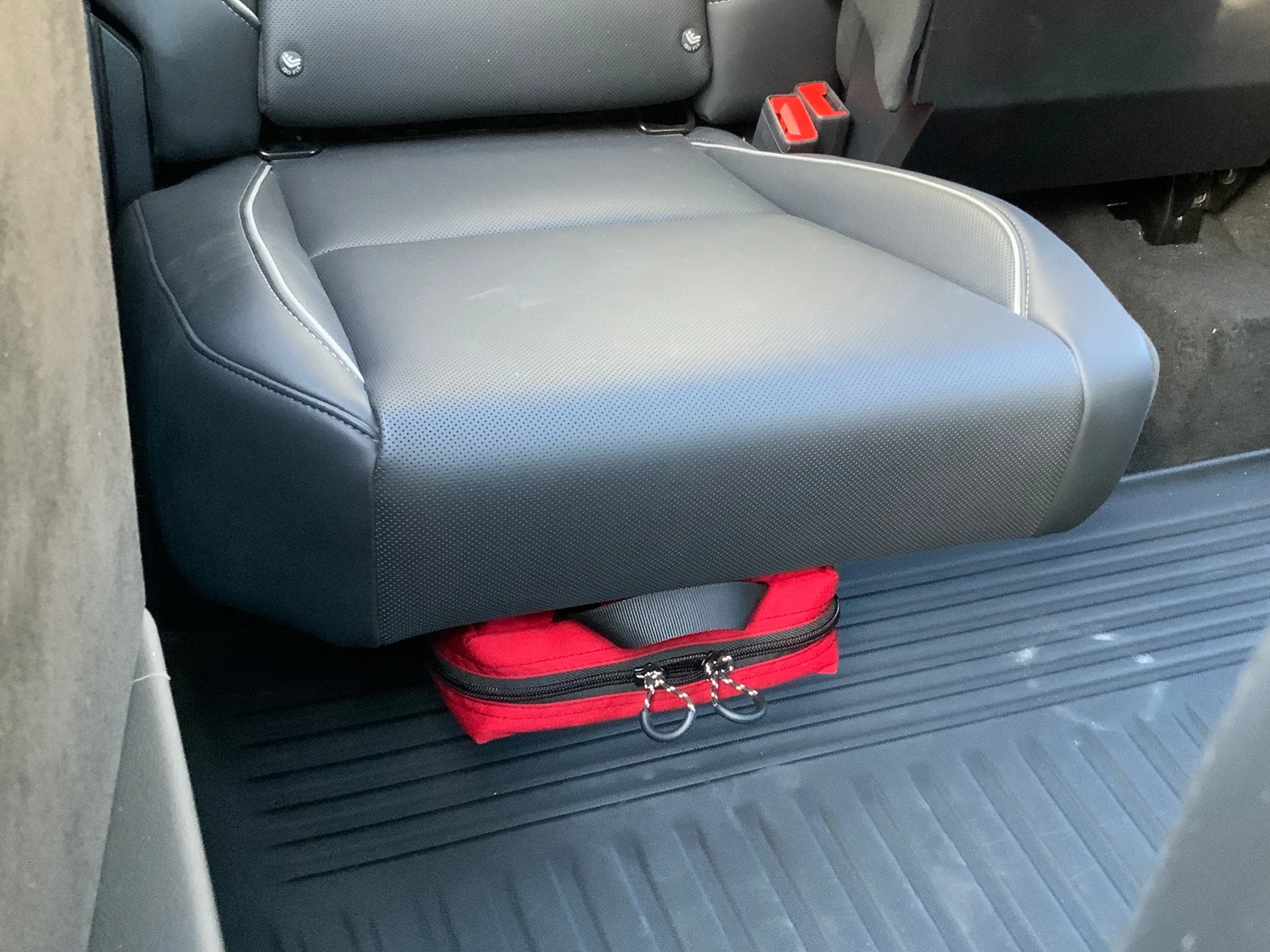

Inspired by DIY others on this site, I decided I wanted underseat 2nd row storage for a IFAK and other travel necessities (air pillows /lightweight blanket).
Solution was underseat molle/pals panels:
Tesla Cybertruck 2nd Row Underseat Molle / PALS Panels Storage DIY 118740-9f57e263675175559fe471b0a9eae3f9
The storage is convenient, doesn’t take up floor space, and is close at hand.

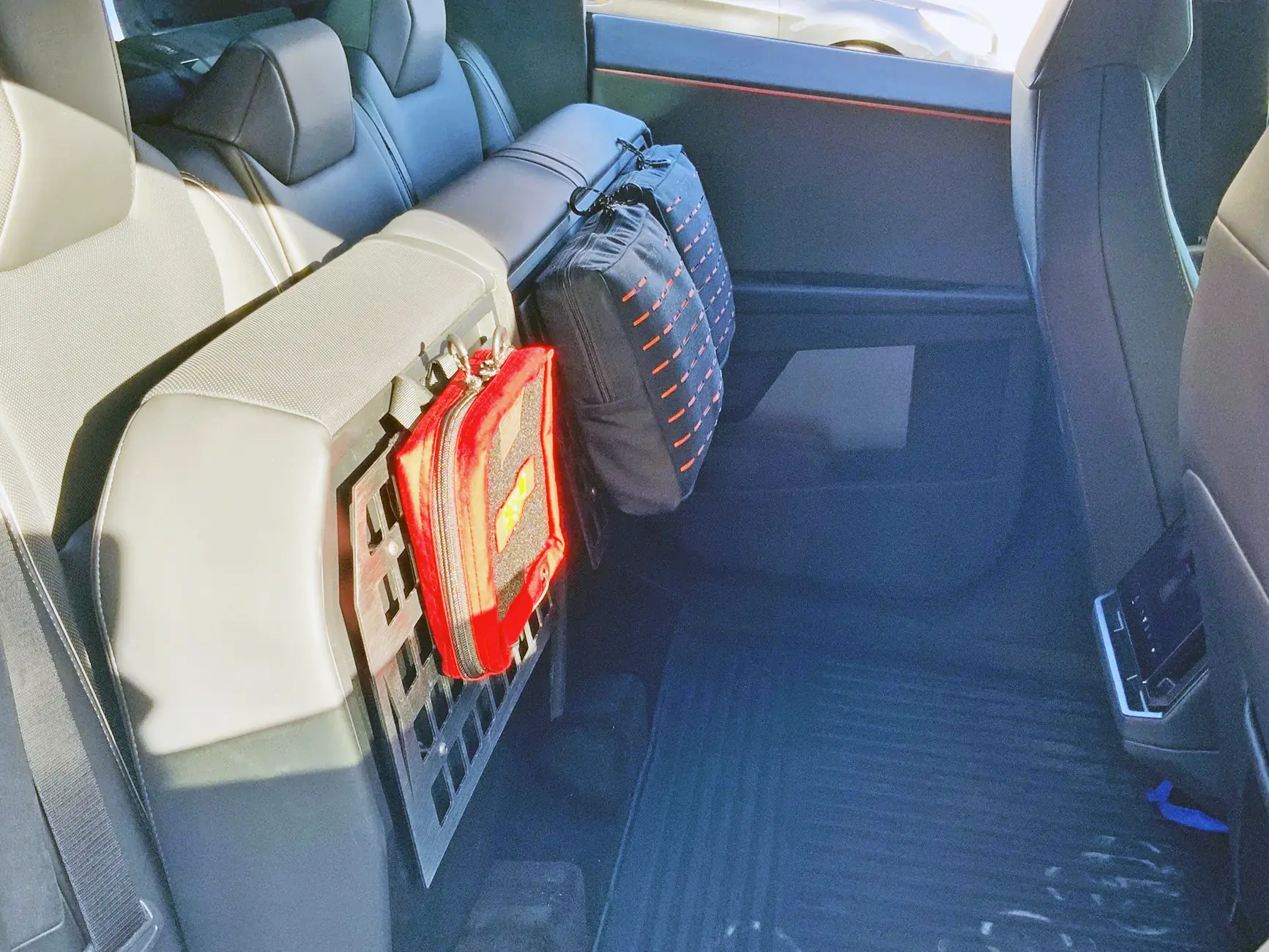

Tesla Cybertruck 2nd Row Underseat Molle / PALS Panels Storage DIY 1777870205654-kq
I used cheap hook&loop straps through the molle/pals panels to ensure the IFAK was grab/go in an emergency.

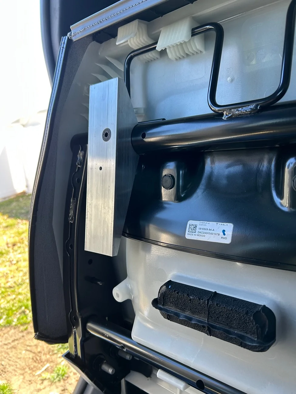

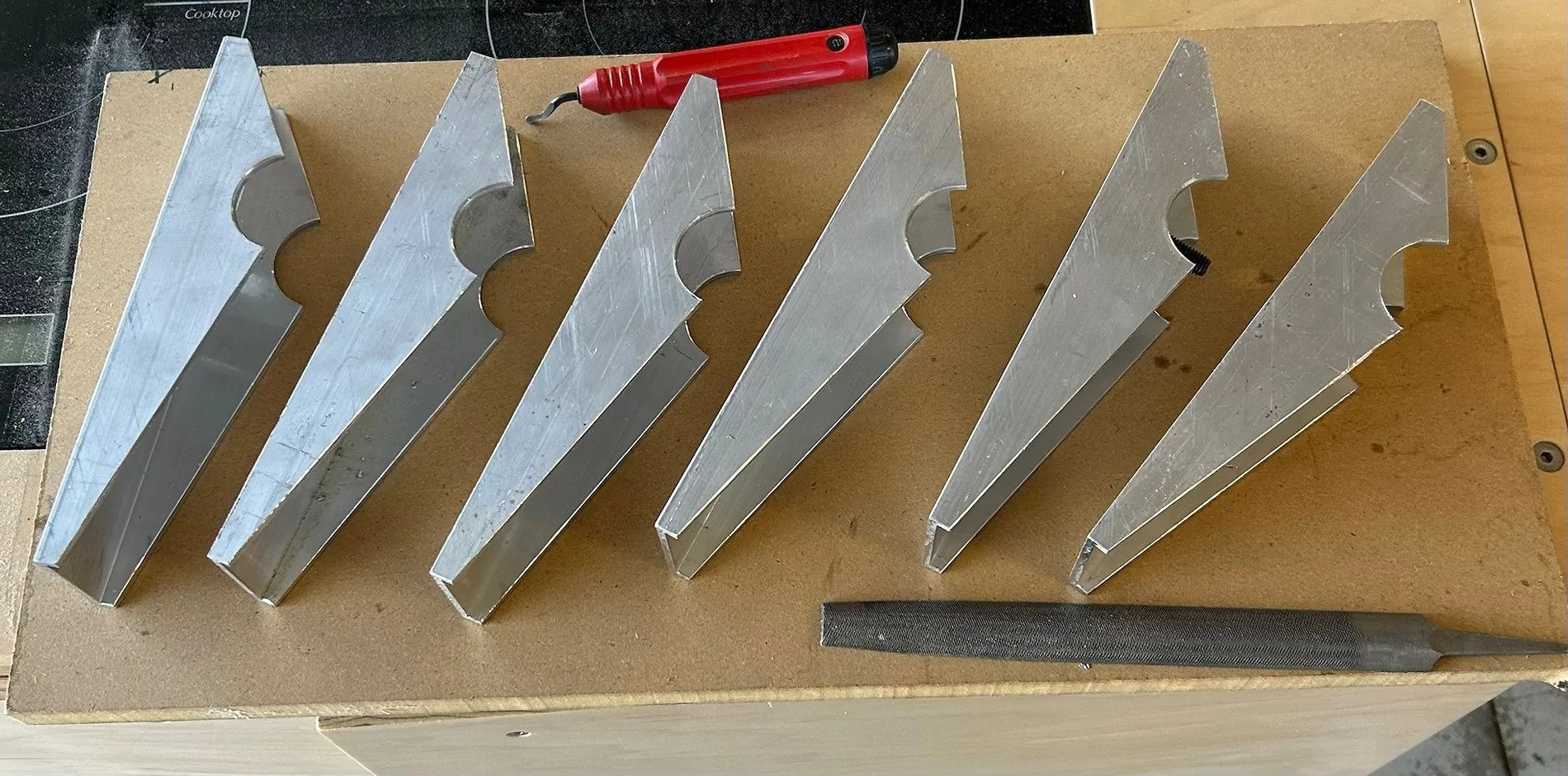

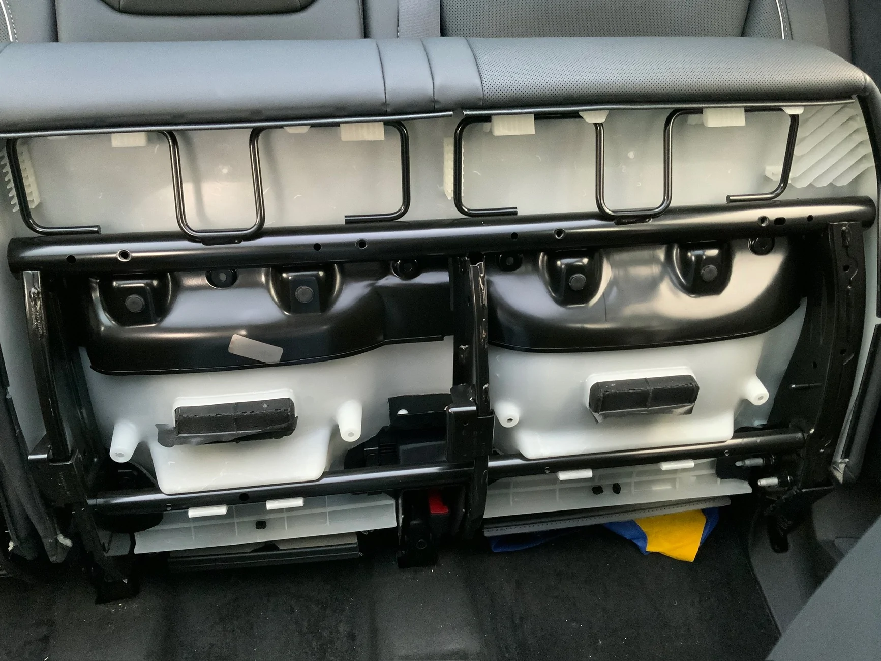

The project was significantly more difficult than expected, but yielded adequate results. The rear-seat support frame has mounting bosses that were be re—purposed for additional bracketry. So that was the plan.
Tesla Cybertruck 2nd Row Underseat Molle / PALS Panels Storage DIY 1777870656700-ri
Tesla Cybertruck 2nd Row Underseat Molle / PALS Panels Storage DIY 1777870697527-g0
The fixturing bosses are M8x1.0.

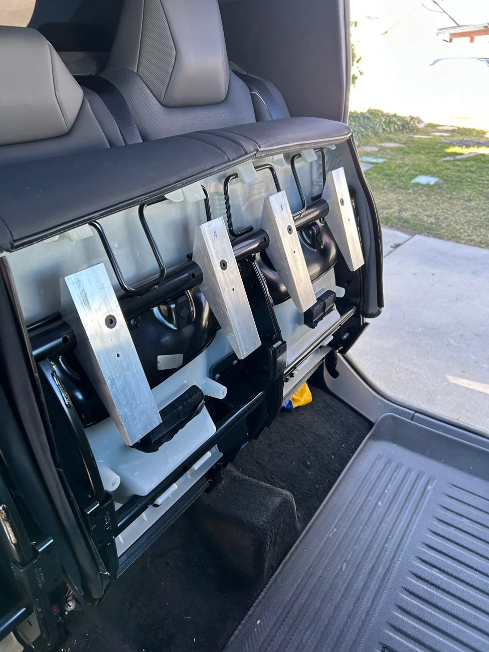

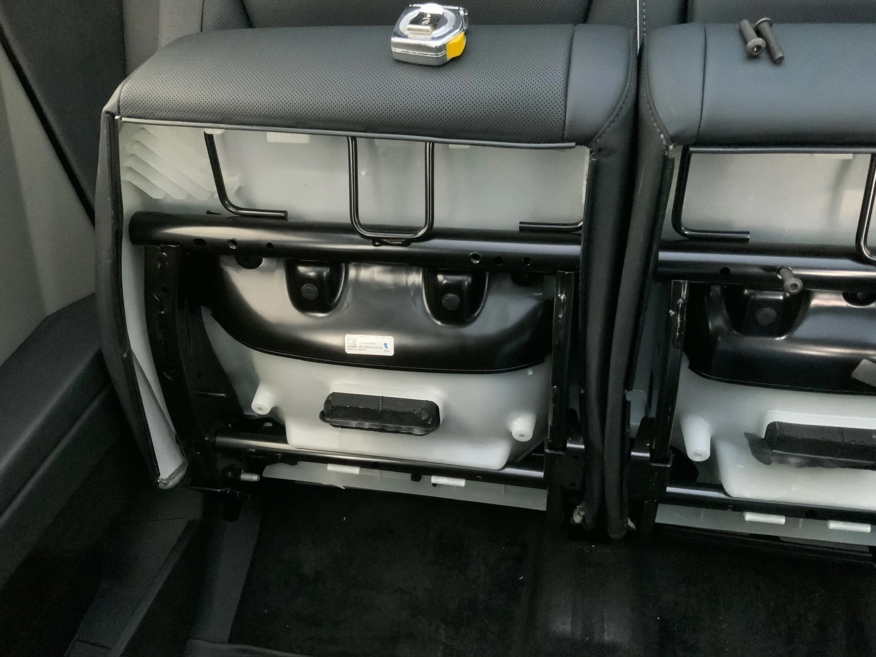

This is what the supporting structure (in general) looks like.
Tesla Cybertruck 2nd Row Underseat Molle / PALS Panels Storage DIY 1777870904840-vr

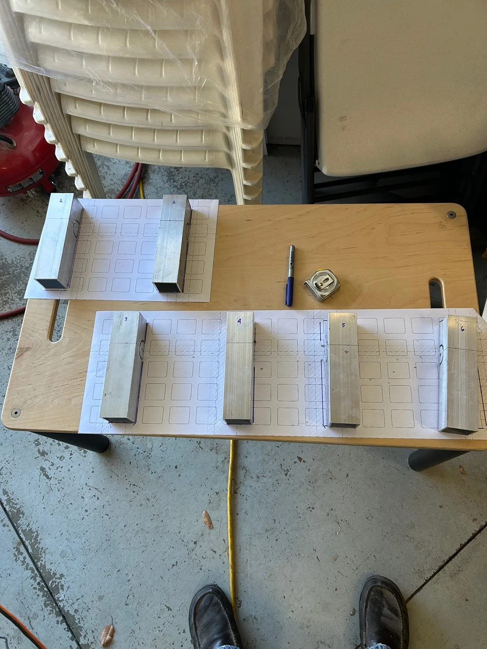

This is a detail of the support bracketing beneath the underseat closeoff panel.
Tesla Cybertruck 2nd Row Underseat Molle / PALS Panels Storage DIY 1777871088451-vu

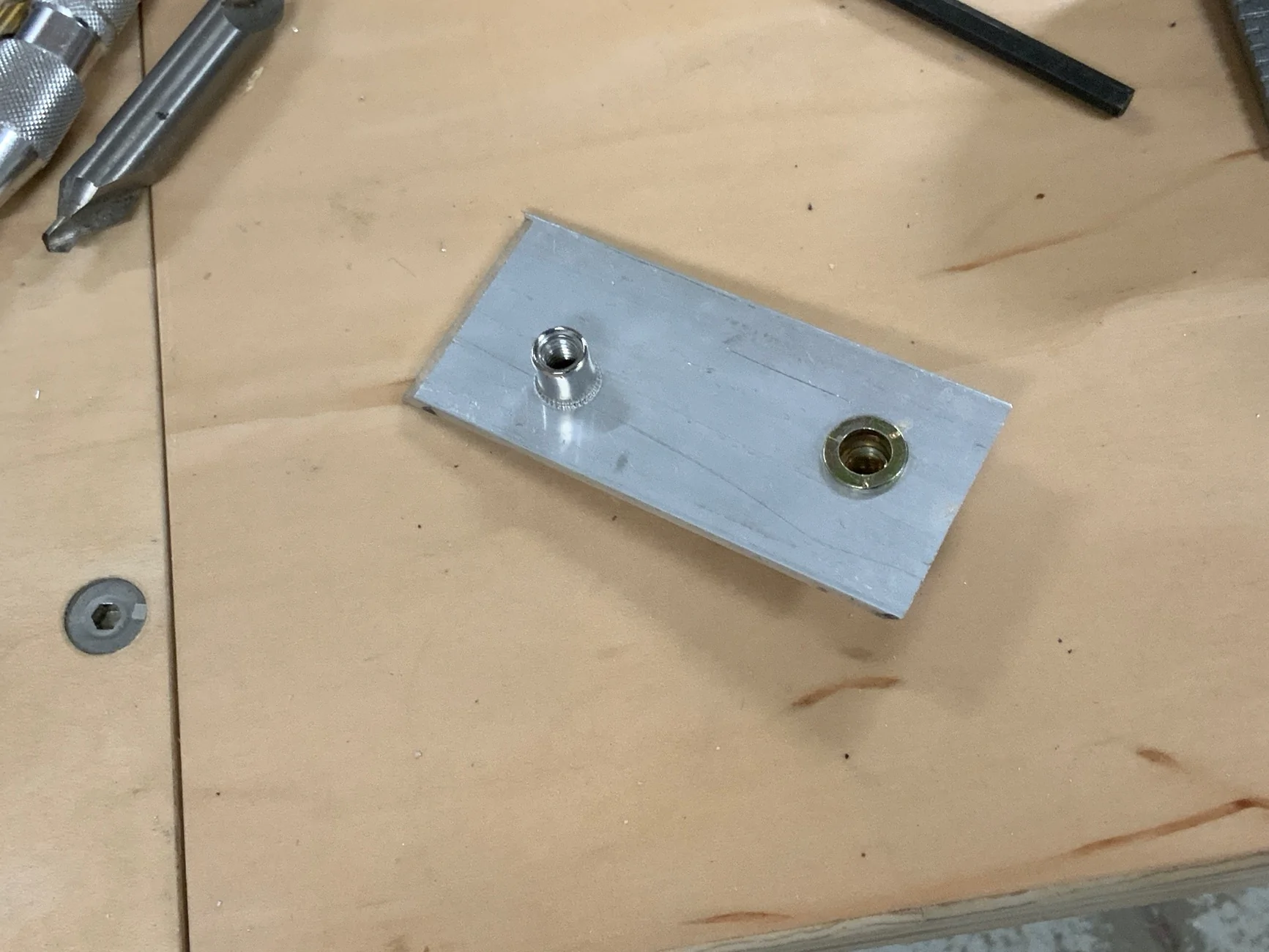

I was concerned about the M6x1.0 standoffs being so I put nut-serts/riv-nuts where the standoffs terminated in the new support

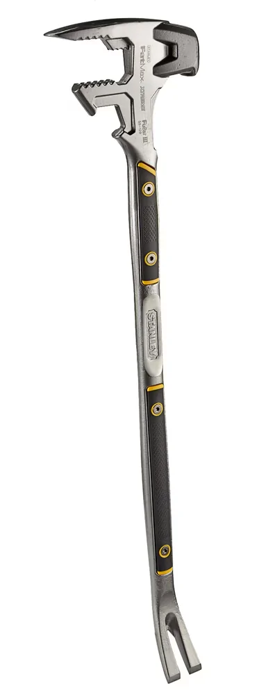

That looks like a good place to hang a fire extinguisher and maybe a glass tool.
since we have an up-armored truck, I keep this in my underseat storage for emergency egress. I'm not asking my truck permission to exit, I'm informing it of a guarantee:

since we have an unarmored truck, I keep this in my underseat storage for emergency egress. I'm not asking my truck permission to exit, I'm informing it of guarantee:
Link to that please!
