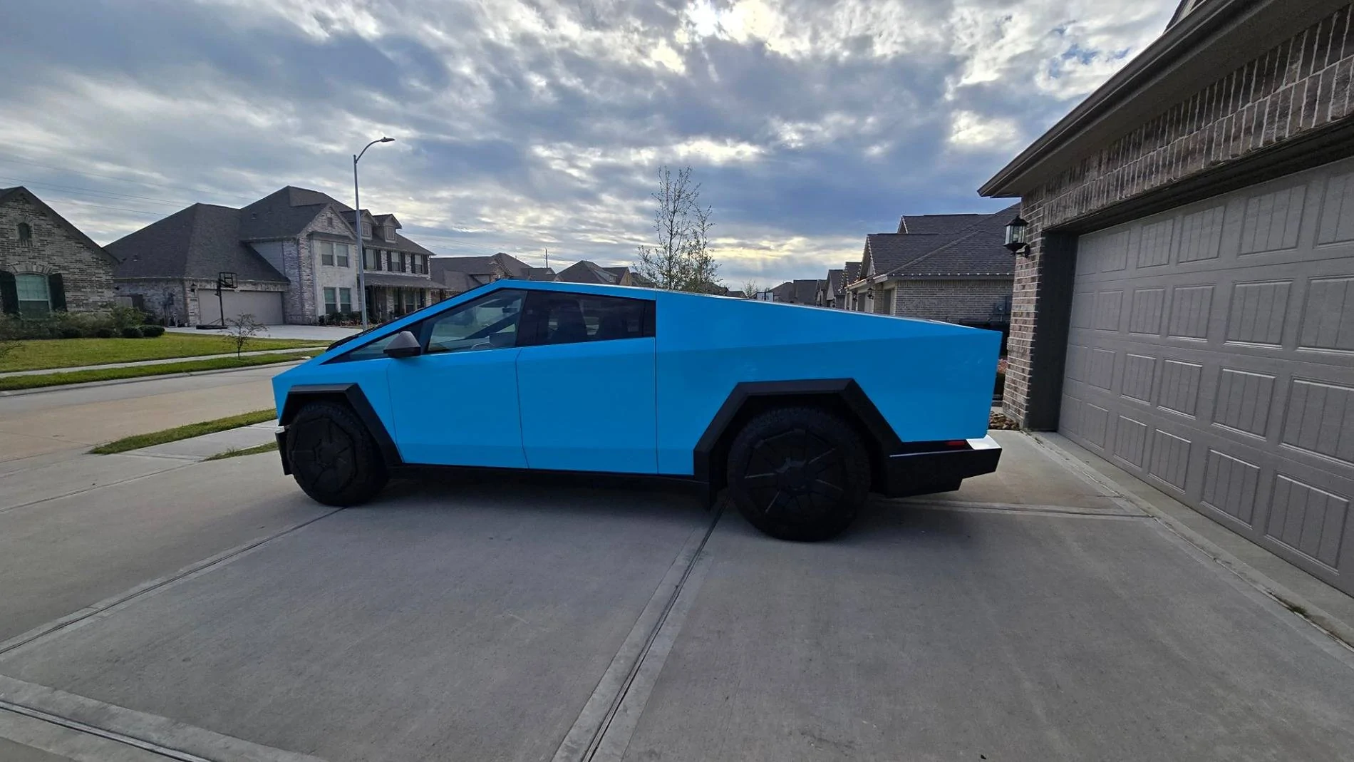

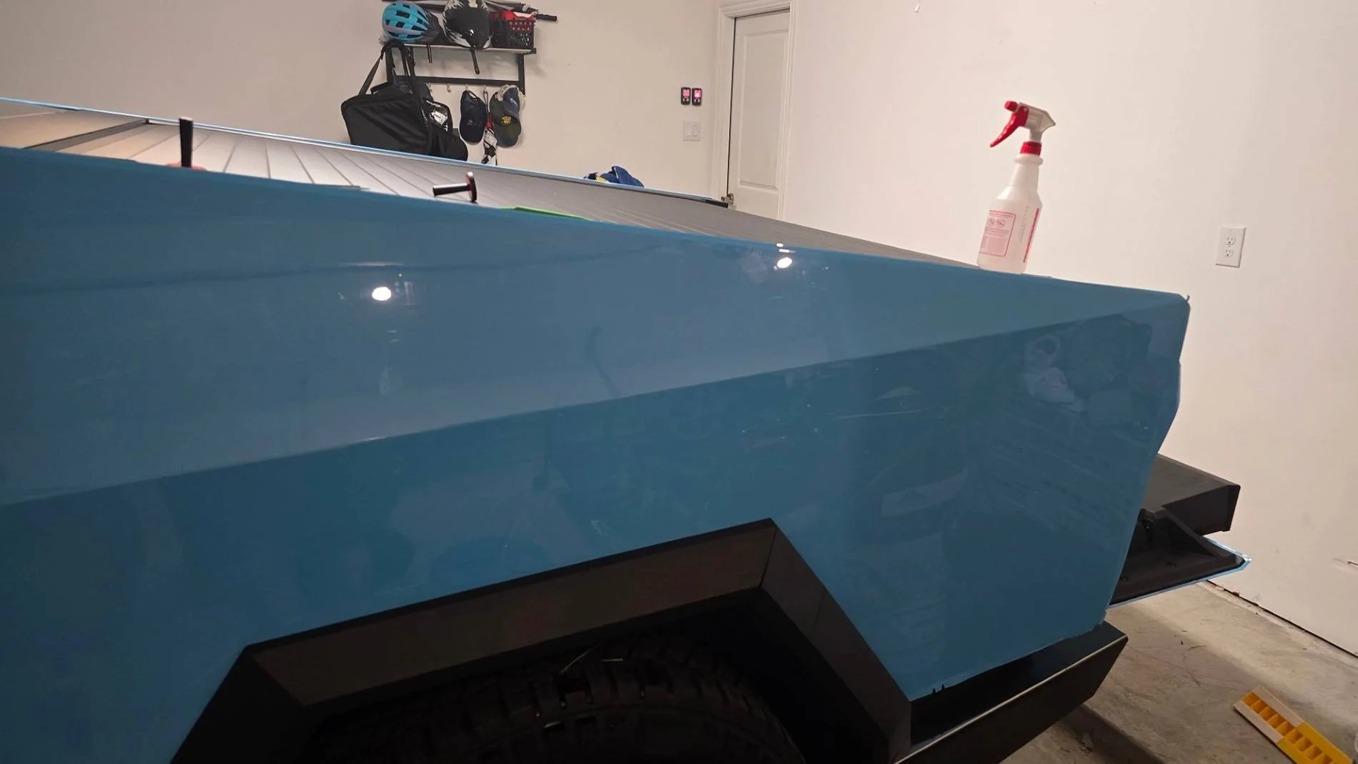

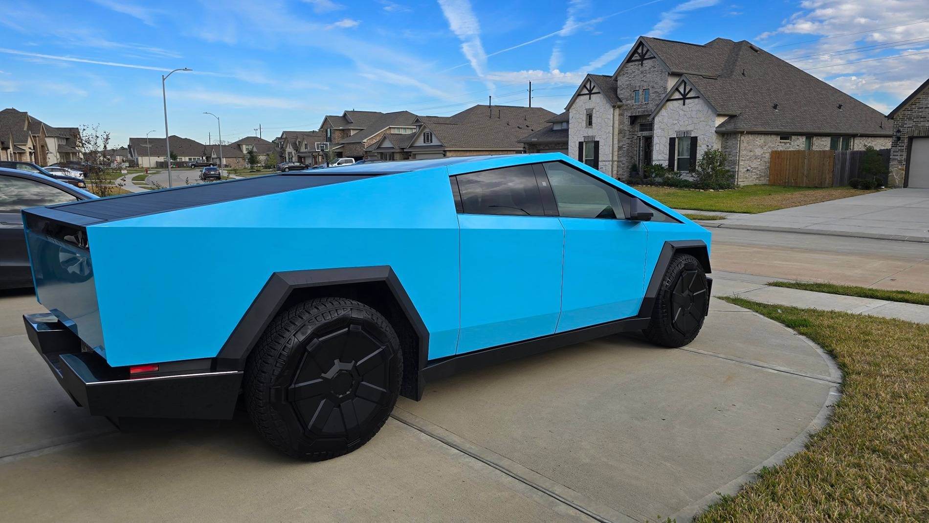

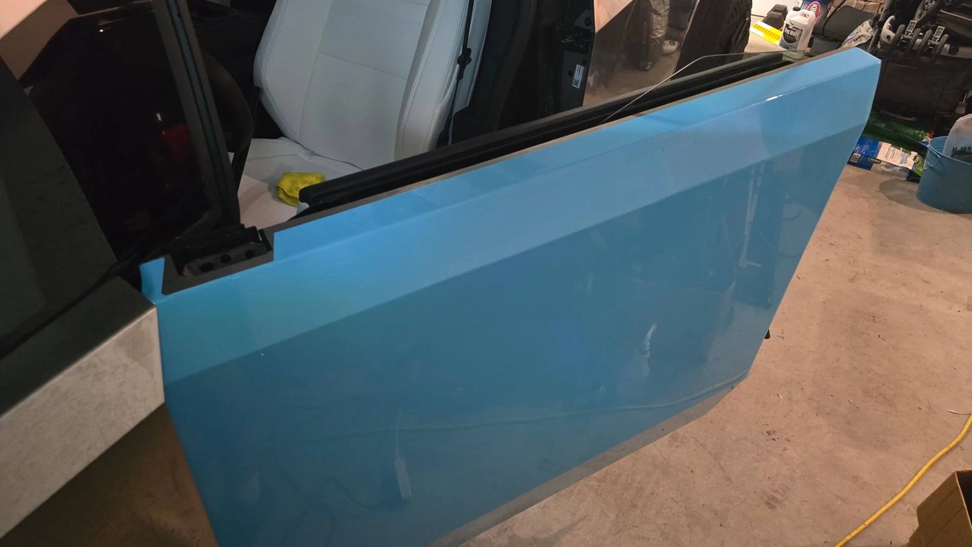

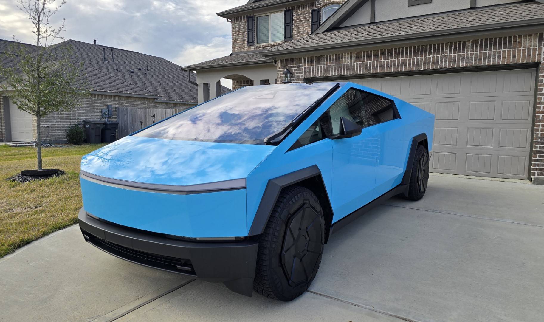

I just finished a DIY PPF wrap from @TWRAPS, and it was a lot easier than I expected, I love the way it turned out. Over all it took me about 8 hours (about 1 hour per panel) and I finished it over a few days. I highly recommend it if you want to PPF your Cybertruck and save $4k+ doing it yourself.
All you need is:
  • The PPF precut kit.
  • A wrap toolkit (~$30 on Amazon)
  • 2 spray bottles with soapy water and rubbing alcohol (bought 1 electric and 1 manual)
  • Lots of microfiber cloths
TWRAPS has a great video to explain the process and it covered everything, but I made a few mistakes that would be easy to correct the next time I do this. These were my errors and the video clearly explains how to avoid them.
  • I didnt have a very clean area to work in, so I had dust and pet hair under the PPF that I had to remove.
  • Better lighting to see bubbles easier. I made the mistake of doing it at night after work.

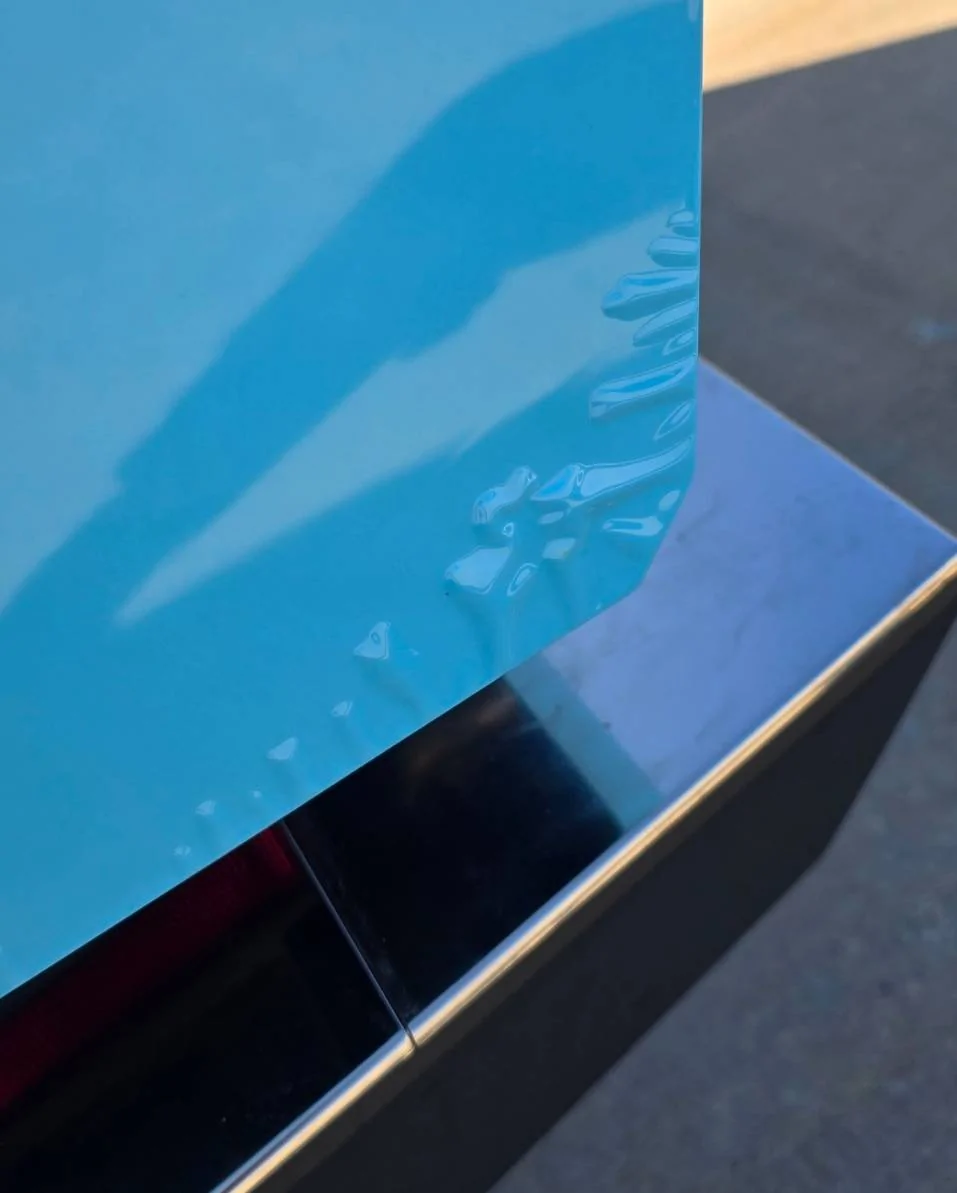

  • I got too aggressive with the rubbing alcohol and it got under the wrap in some places, creating bubbles as it evaporated. It was easy to resolve, but it added more work. Next time I might use pure water, or more diluted alcohol to rinse the edges.

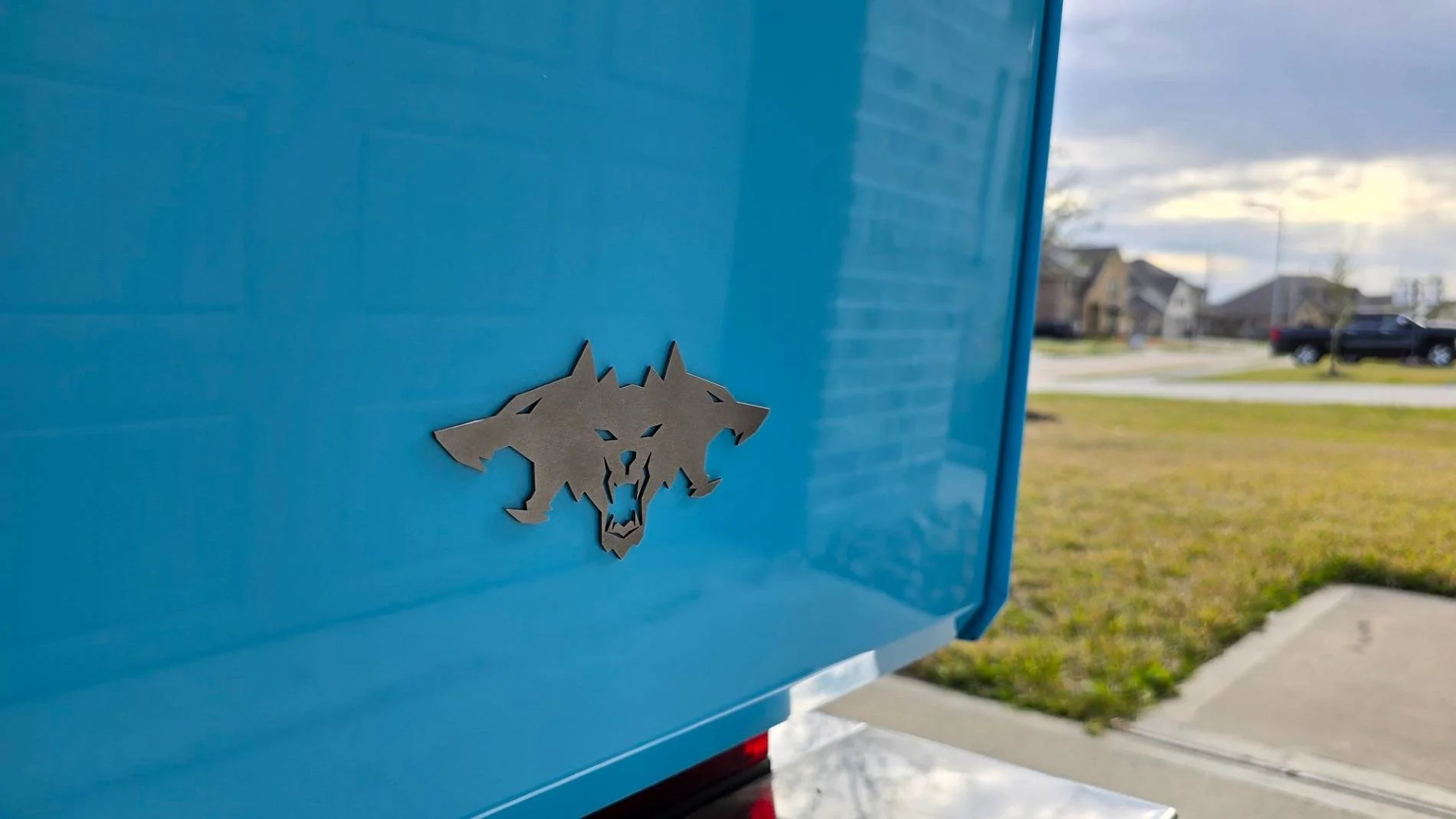

Bonus Stainless Steel Cyberbeast logo on top of the PPF, by @Cybertruck.Supply

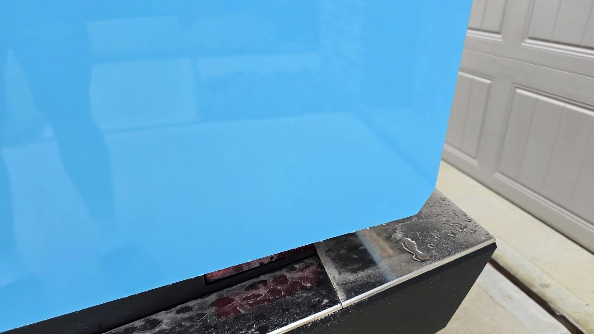

Thanks for this! Considering going the same route. Can you elaborate more on how you sprayed too much alcohol solution? Looks like you removed mirrors, did you also remove any other items like the wheel fenders or the stainless pillars over the windows?

The alcohol is meant to wash off the soapy water from the edges. Once the alcohol dries you can wrap the edges around. The issue I ran into is it was cold outside and I got a little bit of alcohol underneath the wrap on the panel in one spot. Well once alcohol starts to evaporate it turns into a gas and that created small bubbles under the PPF. To fix it I had to peel back the edge rinse with clean water and reapply once it was dry. Easy fix, but easier to avoid it, this only happened in one spot.
Tesla Cybertruck DIY Sky Blue PPF from TWRAPS installed 1000014156
I did remove the mirrors but it wasn't necessary. I did not remove the wheel fenders.
I removed the gasket/seal on the passenger side front window and that was a huge mistake. Not only was it unnecessary I damaged the seal and now it is bent. I will need to buy a replacement. The kit is already cut so you don't need to remove any trim.

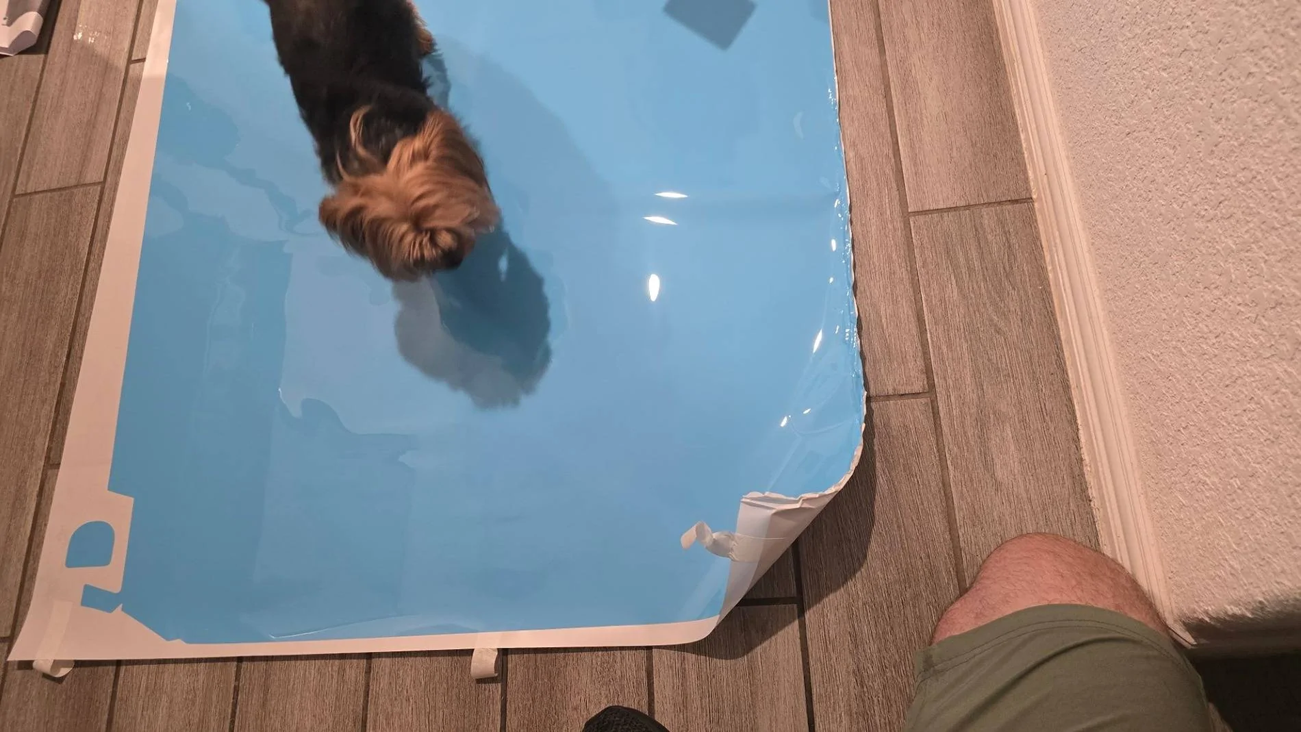

Thanks so much for the info! I’ll be doing in my garage as well, and am also worried about the daily dust and hair. What would you do differently next time if you still needed to use the same garage?

Buying one of those large foldable plastic tables would have been enough to avoid all of the dust and hair. I picked up most of that on my tile floor inside the house. See the picture of my dog walking on the PPF.

Yup, easy install, 8 hours of work and the material is very forgiving. You can remove and reapply, shift around to get perfect alignment, clean off dirt from the adhesive, and even reheat to remove stretches/tiny holes. I highly recommend it.
At first I was afraid of wet installs, now I wouldn't do it any other way. You can even slide the material under the edges of the trim, so you do not need to remove any trim.
