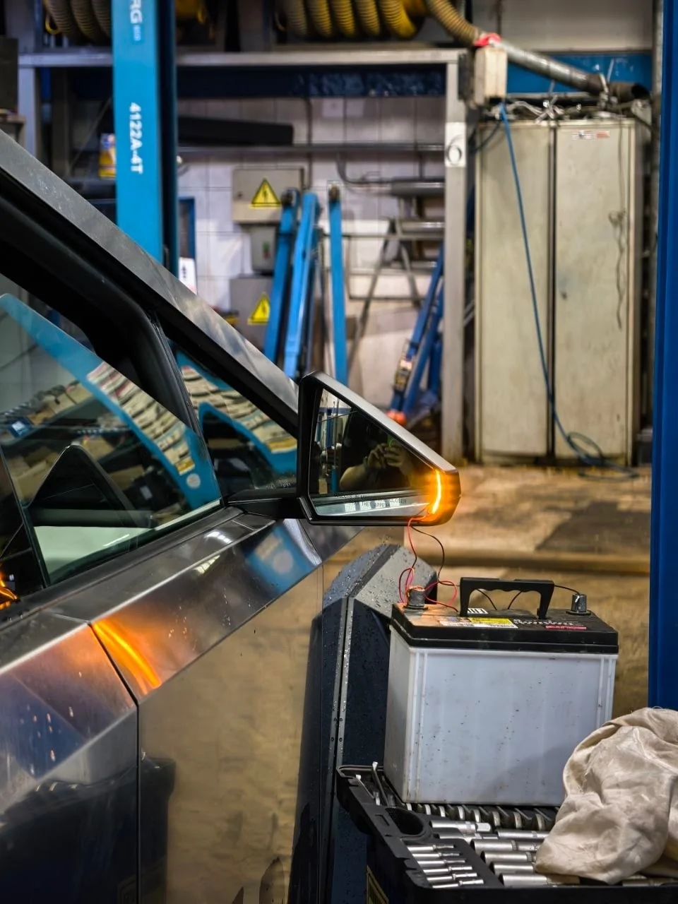

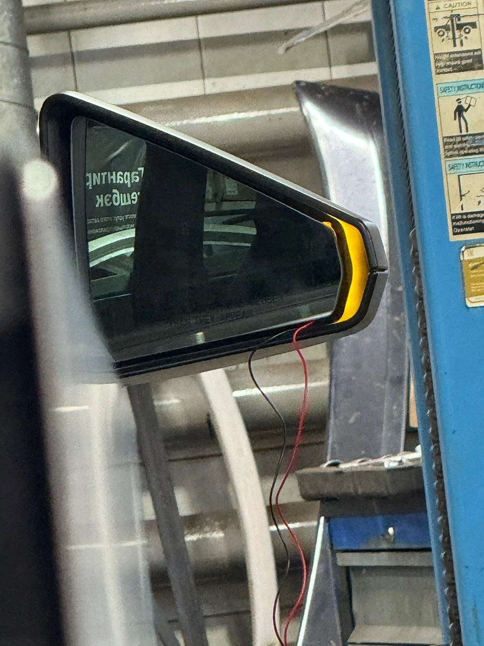

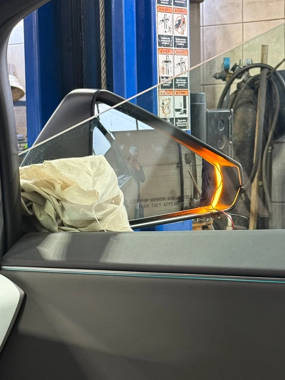

Hello. My friends and I sometimes drive several cars at once. We noticed that sometimes it's hard to tell from the side whether I'm turning or not because there are no turn signals on the fender. I decided to fix this and installed turn signals in the rearview mirror. The LEDs aren't even noticeable until they're turned on.
Tesla Cybertruck Side Mirrors Turn Signals custom install 76
I wanted to connect these LEDs through the front turn signals, but controlling the lights in a truck isn't as simple as you might think. Do you have any ideas on how to connect these turn signals?

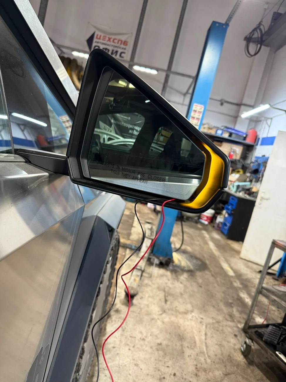

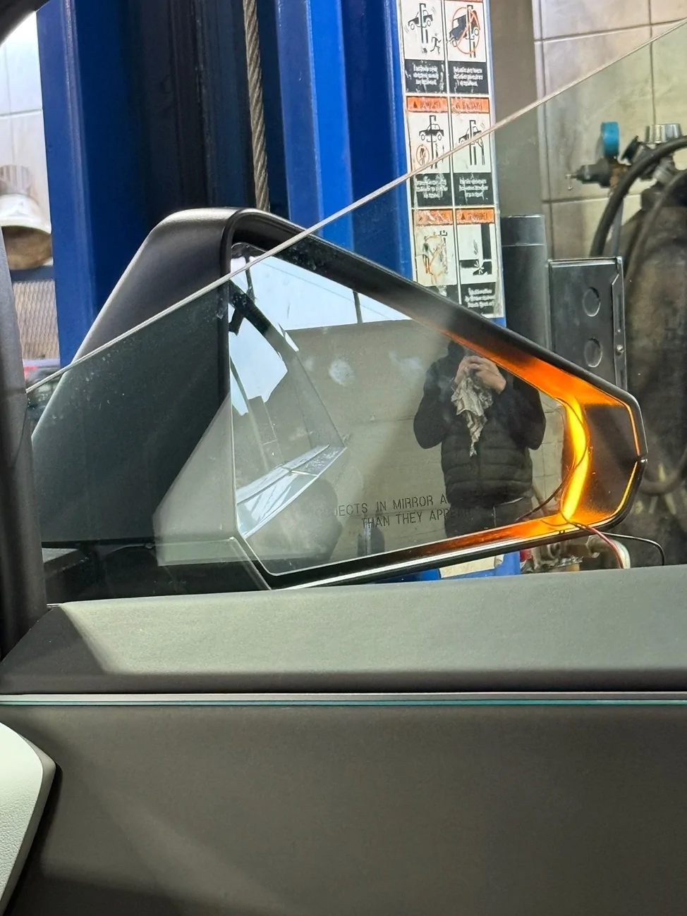

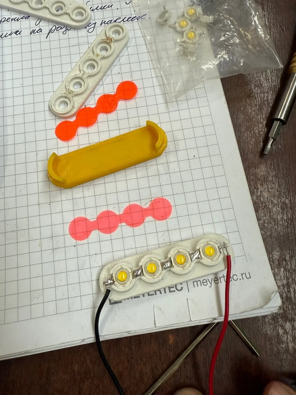

At first I used LED strip, but in the end I chose powerful LEDs of 3 volts each.

Looks awesome! How hard was it to wire?

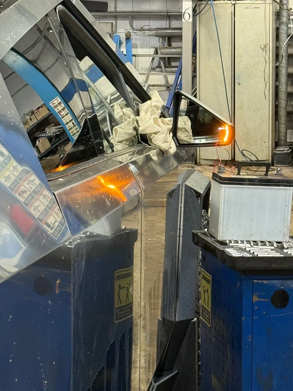

I haven't done the wiring yet, but I'm looking for a solution to connect the turn signals correctly. I was told to install a CAN hack and get the turn signal from it. I'll do that later. I'm taking the signal from the Tesla computer and connecting the turn signals to the 16-volt system.
