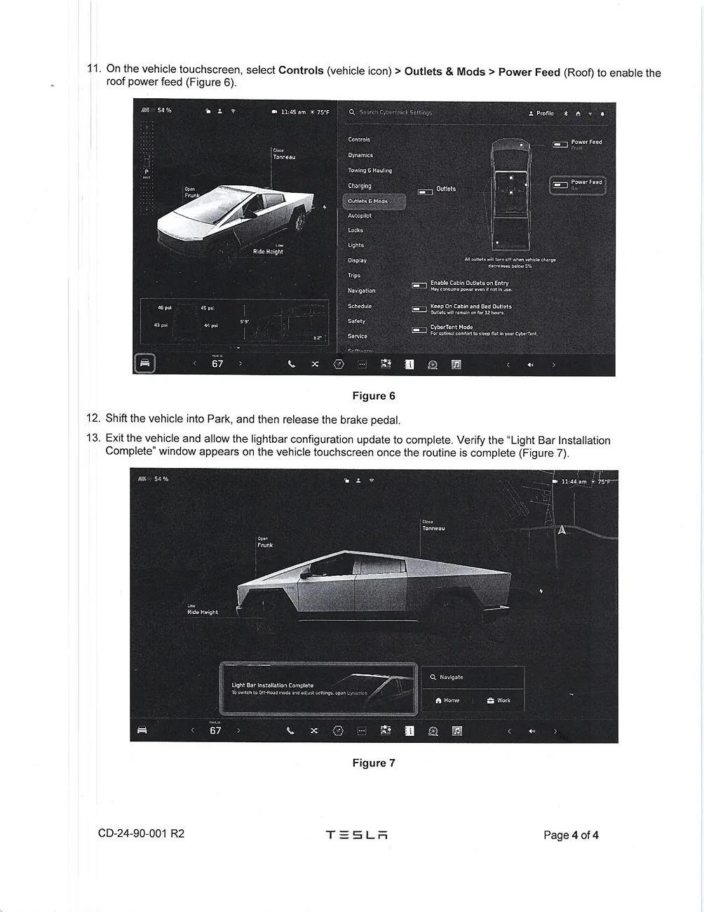

  3. Get in and make sure all doors shut
  4. Press & hold brake pedal, then shift into Drive (keep pressed until further notice)
  5. On touchscreen, touch Controls > Outlets & Mods > Power Feed (place ON)
  6. Shift into Park, and release brake pedal
  7. Exit vehicle and allow lightbar configuration update to complete (Doesn't mention how long. I waited a few minutes before reentering)
Boom, done!

Tesla Cybertruck Tesla Lightbar Install Page 3
