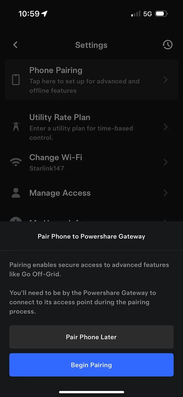

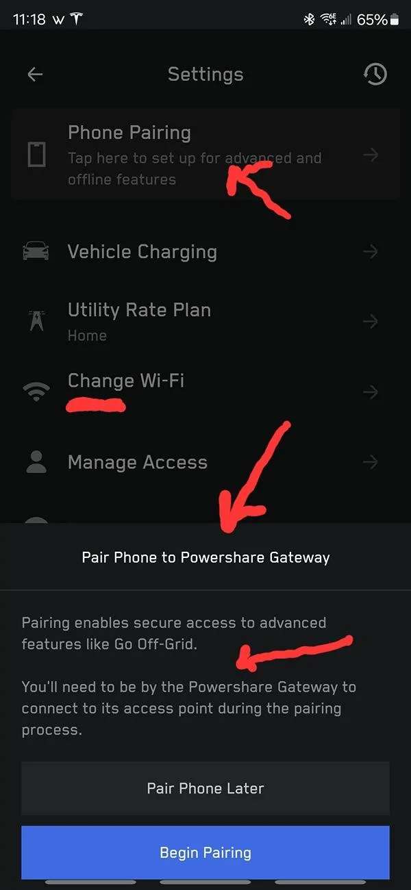

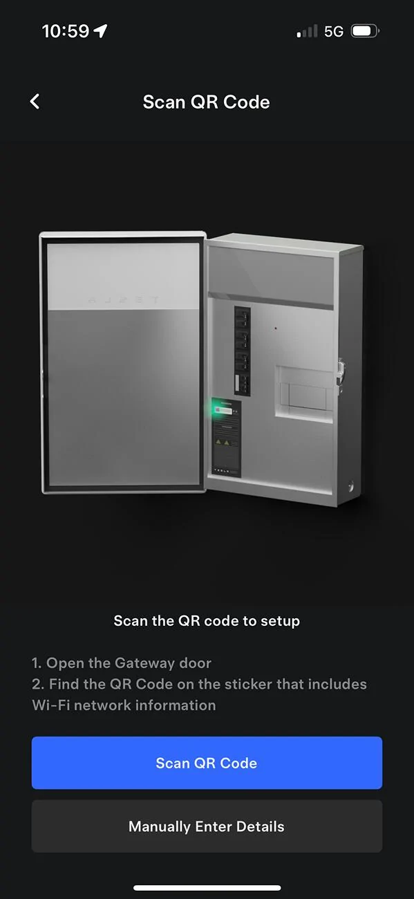

Anybody Pair their Phone with PowerShare?
Pulaski
Nov 17, 2023
310
530
Minnesota

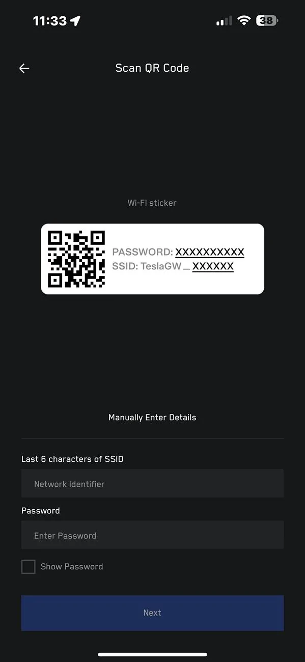

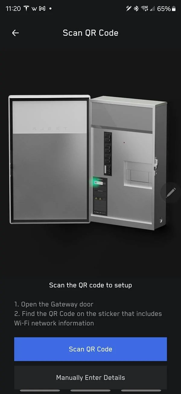

The WiFi sticker should have your ssid and password. My powershare had the stucker under the cover and its not visible by just opening the powershare outer panel. When my installers were installing the device i took a picture of the sticker so was able to pair my phone.
Clutch. Thank you for sharing. I've been trying to locate my WiFi settings all day. Mine was on the inside as well. Just had to undo the single flat head screw at the bottom. Lid pulled down. Then there is was like a Christmas miracle, top third of the unit, right in the middle.
