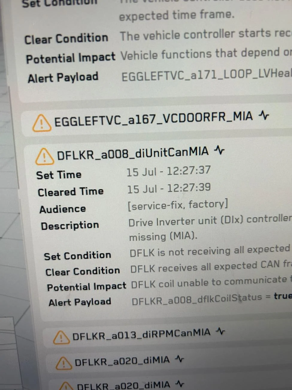

Curious if anyone else has looked at notifications in service mode ? Have a lot of errors almost all communication errors , not customer but “service _fix factory “, Going on road trip in a week don’t know if I should be concerned???‍♂

MIA errors can occur during powerup due to different initialization times. Nothing to be concerned about as long as they aren't active and don't get displayed on the normal screen.

it looks like it cleared itself 2 seconds after

Pic was example, has pages of them ??‍♂
