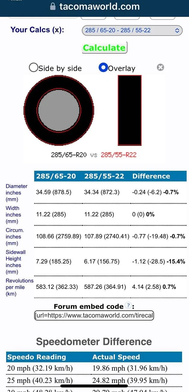

Keep in mind, the proportional change in sidewall height will be much less due to the much larger inital height.
Tire and sidewall height:
Model 3 18: 4.2"
Model 3 19: 3.7"
Model 3 20: 3.2"
Cybertruck 20: 7.3"
Cybertruck 22: 6.2" 285/55R22
Model 3 18: 4.2"
Model 3 19: 3.7"
Model 3 20: 3.2"
Cybertruck 20: 7.3"
Oh man, did you just bring some actual math into the mix for me to get deeper into my analysis paralysis. Shit, until now this was a “feel” and gut thing. lol
Seriously, though, perhaps our experience with our M3 isn’t a good one to compare. But I am concerned with ride quality. Maybe I’ve just aged out of being willing to tolerate lower ride quality for good looks. Just trying to find the right balance.

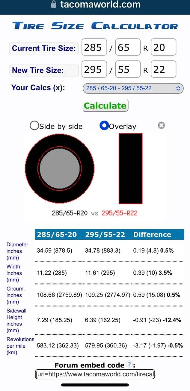

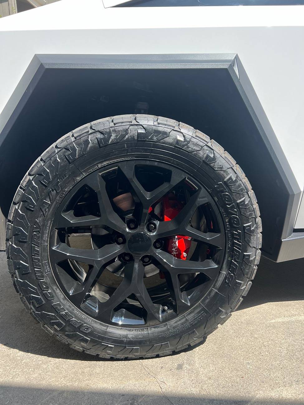

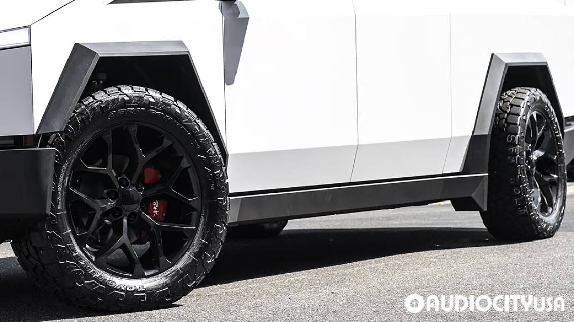

Stock is 285/65/20 . I did 295/55/22 here is a photo of the defense . The side wall is just under a 1” smaller (0.91)
we are talking about a truck that has a nice soft air suspension . Ok if you Drive around in silence possibly you will hear a slight sound difference with your ear to the ground but who does that ? Ride comfort I can’t feel a difference.
I would go with a 295/55/22 over a 285/55/22 also including a photo of the difference (1.12). It will fill up your wheel well just a bit more and also give you a little more side wall so less of a difference then stock

When filling wheel well, be aware of the clearance to the top bolt. It's about 0.6 of an inch away on stock all Terrains. You're only 0.1 closer, but a few percent shift could impinge.
All good here. I’ve seen many go with a 35.12.5 so I knew I would be fine.
