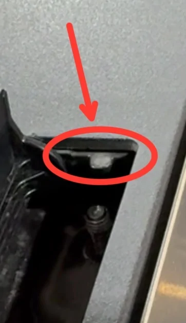

There’s a plastic piece under the applique that secures the door. Looks like that piece has become dislodged.
Tesla Cybertruck Appliqué door loose (crossbar mounting point) IMG_1182
Should be covered under warranty unless there was physical damage done to the applique.
