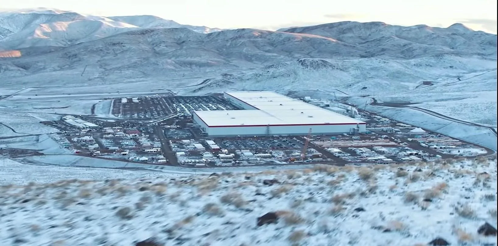

Photo: Tesla Gigafactory 1 in Nevada
Tesla Cybertruck Article: Tesla's battery acquisitions are paying off in spades, and giving rivals a lot of pain tesla-gigafactory-1

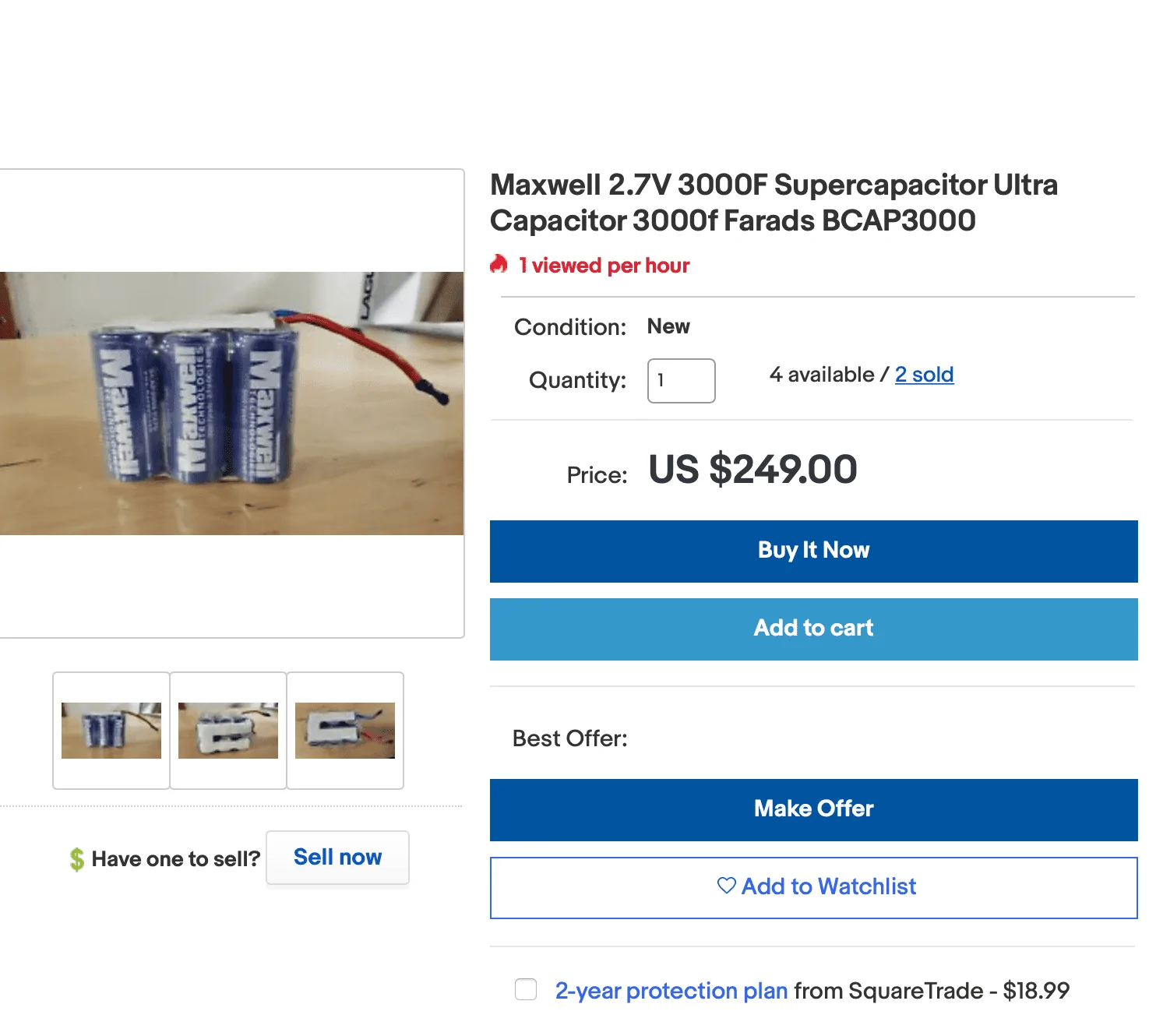

The Maxwell capacitor will extend the range of the Tesla's.
Tesla Cybertruck Article: Tesla's battery acquisitions are paying off in spades, and giving rivals a lot of pain Screen Shot 2020-02-03 at 2.10.25 PM
Not appreciably to the extent that they won't be used for that purpose. Consider the supercapacitor in the ad. It is rated 2.7 volts and has capacity of 3000 f. It will, thus, fully charged, hold 2.7*2.7*3000/2 = 10935 Joules. One watt hour is 3600 joule so one of these capacitors holds
2.7*2.7*3000/2/3600 = 3.0375 watt hours and it would take, assuming 500 Wh/mi for the CT, 500/(2.7*2.7*3000/2/3600) = 164.609 of them to hold enough charge for 1 mile. That's $40,988 per mile.
Where they might be used is to allow for more regenerative braking and/or in super sound systems but not to replace battery for traction. The value of Maxwell to Tesla is in its dry coating technology which they use to make the capacitors but which appears to be transferable to batteries. This cuts way down on manufacturing time, and thus battery cost, as lowers the carbon footprint associated with each cell.
