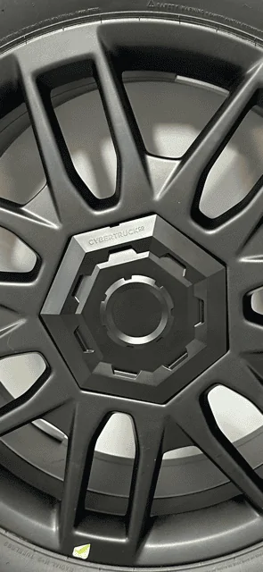

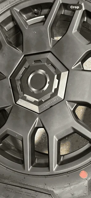

I tried fitting the Cyber wheel center caps I own, and they DID NOT fit the core wheels.
Maybe the offset is slightly different but whatever the reason the depth of the center hole (front to back) is effectively 1/4" deeper in the cyber wheels than in the core wheels. Because of this the wheel center would not "snap" in place.
In my opinion, it is the depth of the "stud face" that is different. See the pictures below. The shallower face of the core wheels holds the cyber wheel center cap off just enough to prevent it from locking in place. I think you can see this is the last picture.

the depth of the center hole (front to back) is effectively 1/4" deeper in the core wheels than in the cyber wheels.
Your pics show it's deeper in the cyber wheels than the core wheels.
