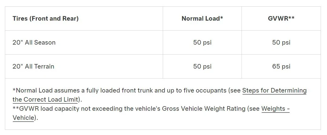

“As per Tesla in the Cybertruck User Guide, the Cybertruck's tires should be kept inflated to their recommended pressures, even if it differs from the recommended pressure that’s printed on the tire itself. Tesla also notes that when a Cybertruck with All-Terrain Tires is carrying heavy loads up to its Gross Vehicle Weight Rating (GVWR), the tire pressures should be increased.”

The AT tires are rated for up to 65 psi cold. Which means they will not explode as they warm up to 70 psi. In fact, Tesla recommends all four tires be filled to 65 psi cold for towing trailers. You also want to increase above 50 psi cold for hauling heavy loads, especially if it will be a higher speed freeway trip.

50 psi is when loaded with 5 occupants. You can probably go lower otherwise.
