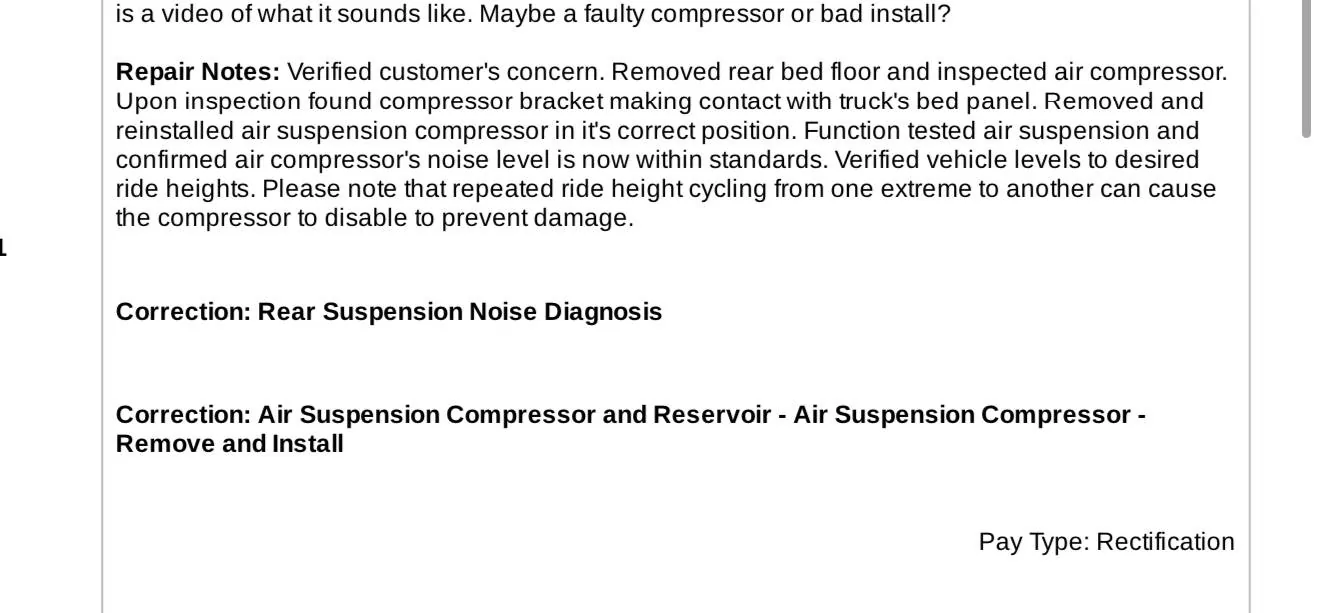

If your compressor is loud in the cabin, this is not normal operation.
Take it into service and ask them to adjust the bracket that holds the compressor.
Service invoice is attached below:
Tesla Cybertruck Compressor noise coming from rear...is it normal? IMG_4608
Thanks! I have a service appointment for 1/7 and checking the compressor noise is one of the line items.
