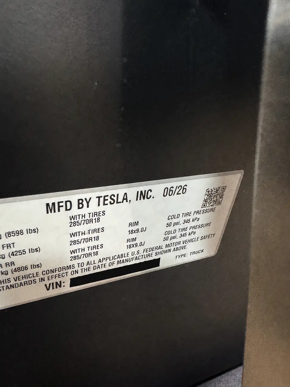

A 6/24 cannot be a 97xxx Vin
Unless you meant 6/26

if this is a CB, how come the tires are 18s? 285/70R18s?
lol that was Alpine’s MFG sticker which wasn’t claimed to be a CB. Either way it could be the core wheeled too.
