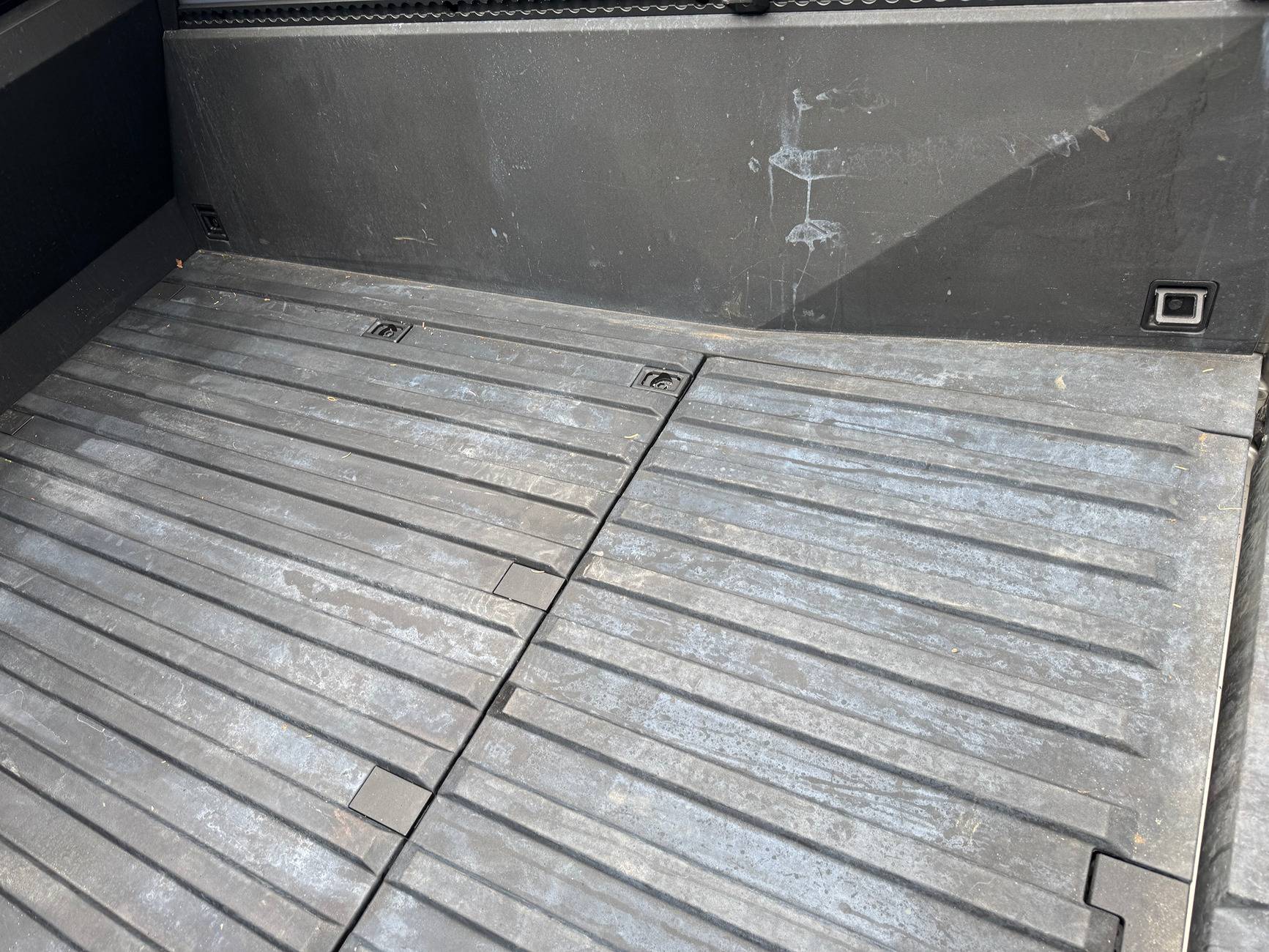

Over the winter -CT bed was carrying Poly tarp holding a stash of peat gravel for my driveway. In the spring I took it out and cleaned bed, only to find blotchy grey patches on CT bed surface no longer black, does anyone know what paint/plastic coating will match existing Tesla finish. I do NOT want to paint complete walls and bed. Thanks for your time.

A picture would help if you can attach one. I've found that the blotchy grey stains on my vault bed are water stains.
Cleans right up with white vinegar.

Thanks for your suggestion, hope this best illustrates condition.

Take normal household 5% white vinegar and a sponge to that side panel as a test. I think you'll be surprised at how easy it removes it.
If the water stain disappears in the side panel do the rest of the vault bed.
FWIW I don't even rinsie mine. Just leave the cover open and air dry. Will look like new.

Great, thanks - I'll do that!
