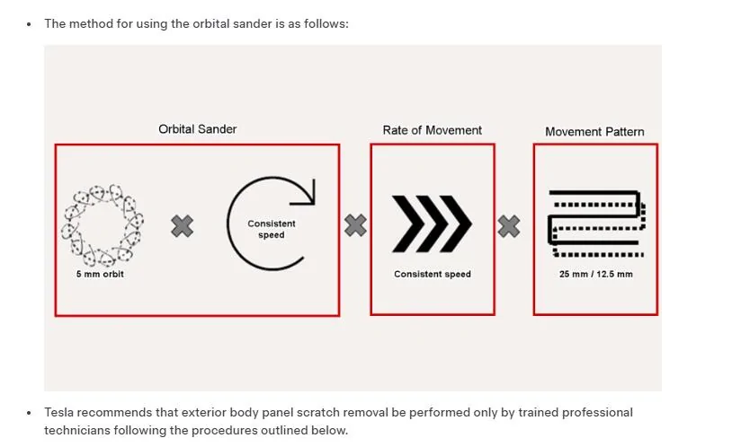

people also pointed out here that the manual seems to suggest they don't just use a random orbit sander, but rather a forced orbit sander. That would be very helpful in keeping both light pressure and having a homogenous orbit.
You can see it calls it an orbital sander, which isn't the same thing as random orbital sander. and it also says consistent rotational speed, which is something that a forced orbit sander would provide.
I don't have any firsthand knowledge into the process at the factory, but this does seem to make the most sense.

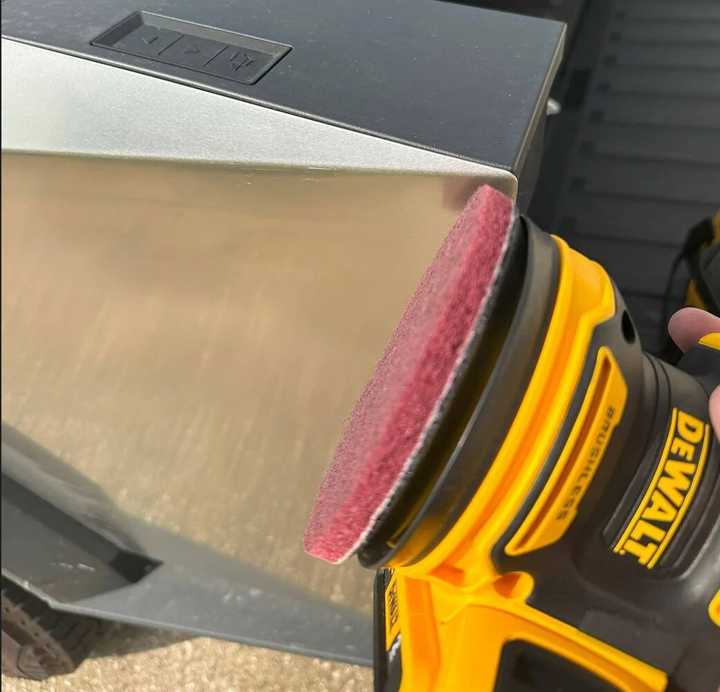

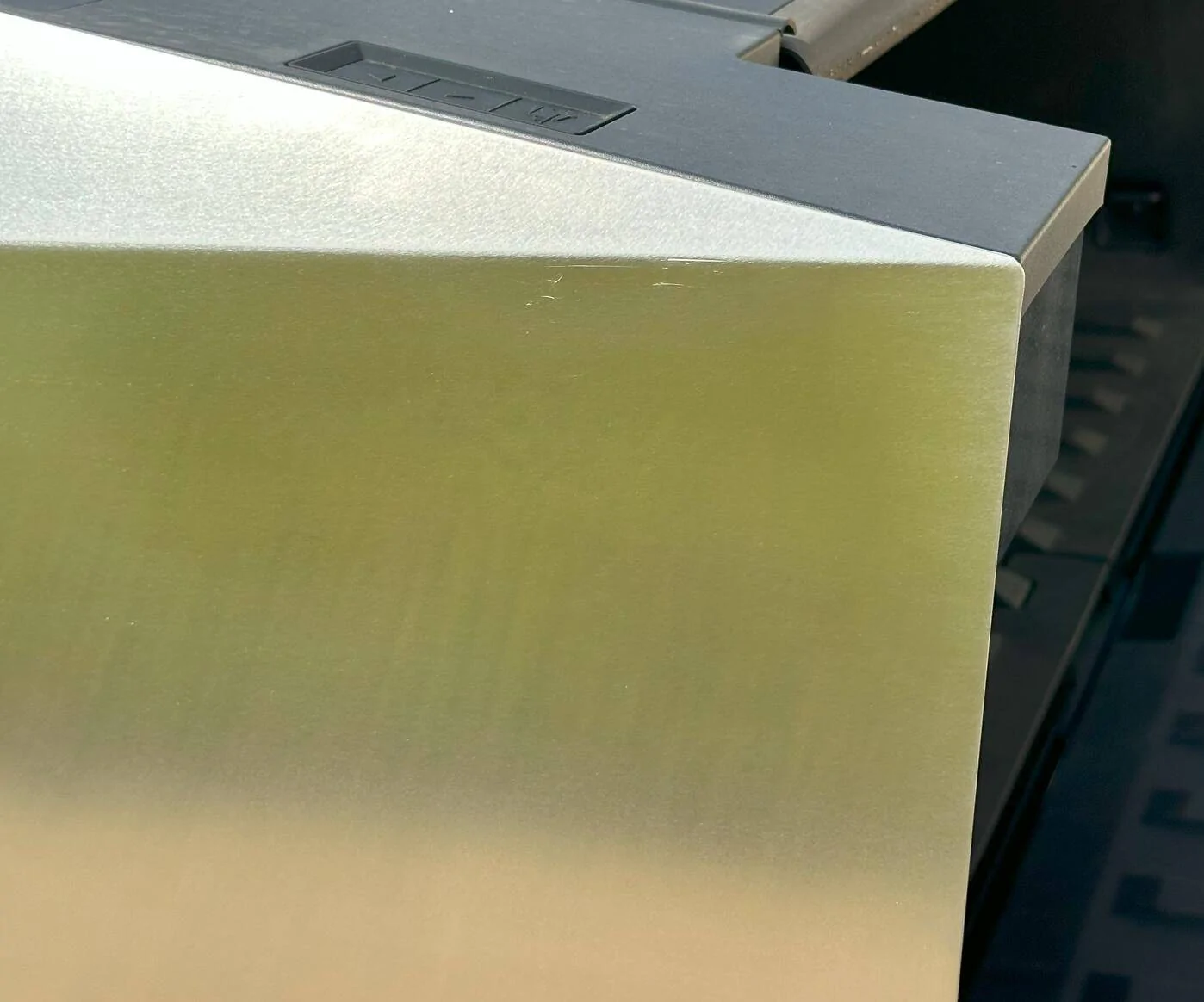

Maybe I'm not as picky, but the 5'' Dewalt orbital and cheap amazon pads worked just fine!
I used some sandpaper and sanding stick by hand to bring the gouges and surrounding area up to about 600 grit.
Then hit it with the red "coarse" pad for a few min, sprayed with alcohol to clean, then hit it with the gray "fine" pad (800grit).
Being shinny and being outside, I'll admit that it's not super easy to see what's going on... so I may need to refine this in different lighting, but it's pretty easy to mess with.
The gouges were deep, so to some degree there isn't any fixing that.
I just wanted to clean up the area and make it less noticeable and this worked! It's really hard to tell in the pics, but these pads blended it pretty nice!
Also... sorry i don't have a proper before pic, but it wasn't pretty
Pads I used - https://www.amazon.com/dp/B0CQPYWTQF?ref=ppx_yo2ov_dt_b_fed_asin_title

Those are deep gouges! I wish you weren't being so protective of the cause of them, so people could understand what it takes to get a gouge that deep in such a hard metal.
That said, those absolutely can be removed 100%. Given the location near the rear, making the panel 1/10th mm thinner will not matter at all. I would suggest a more powerful sanding tool and more aggressive abrasives will reduce the time required. Just feather the sanding around the repair area so you don't create a visible depression.
