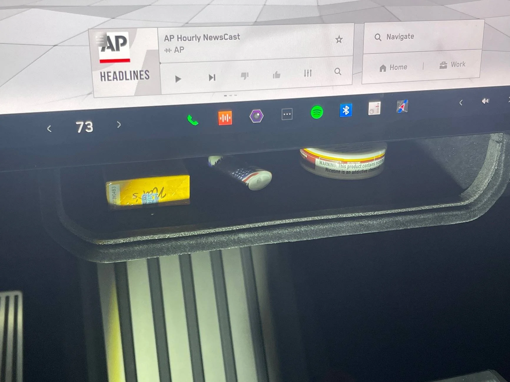

Center Console Storage by @BestEvMod(AOSK) :
For the center console storage I purchased the same one as you guys probably purchased off of amazon:
Amazon.com: BestEvMod Center Console Under LCD Screen Organizer Compatible with Tesla Cybertruck 2024+ Accessories Magnet Install No Tape Needed Pickup Lower LCD Storage Box (Flocked) : Automotive

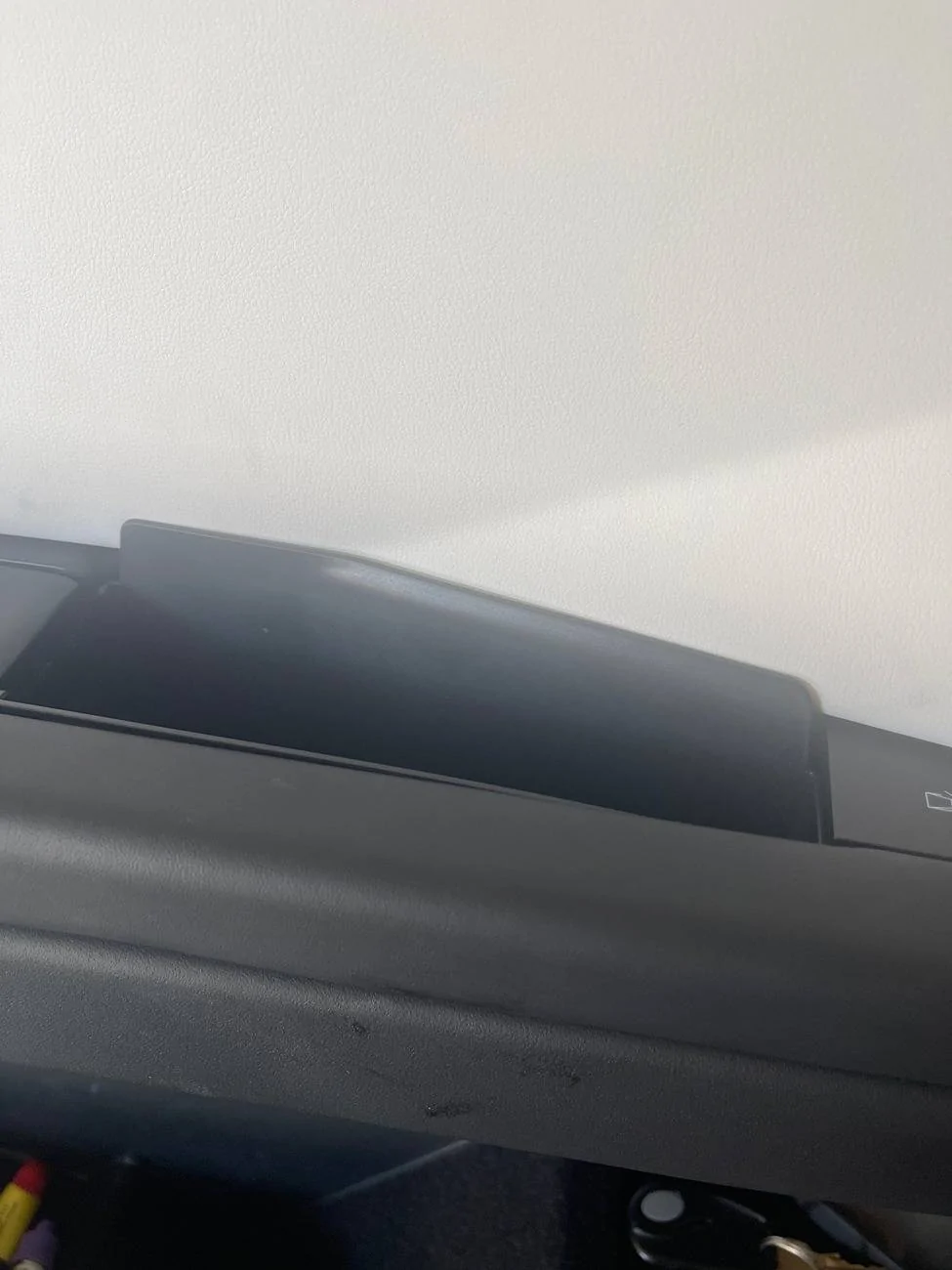

There was a couple of issues with this at first, the #1 issue is that it wasn't strong enough to hold ANYTHING or even itself up with stuff stored in the center console, and #2 everything flies out from the center storage console when you take off fast.

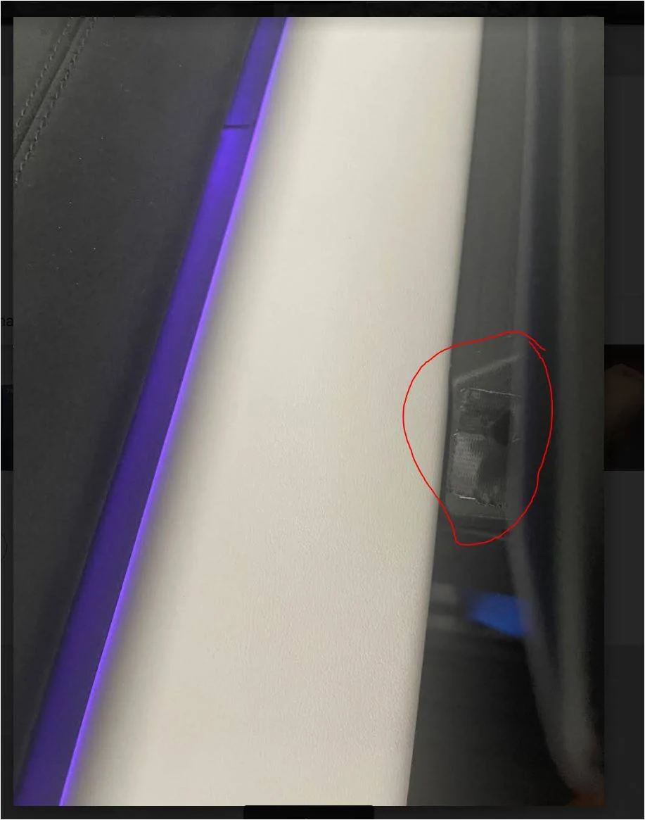

Fix #1
Drill two tiny holes on each side of the console and reinforce it with (50lb) picture hanging wire and tape it over with some black tape to hide it. (thread the wire to the top and twist it with some needle nose plyers and then put a piece of tape on it:
Cord link:
OOK 50 lbs. 9 ft. Durasteel Stainless Steel Hanging Wire 50114 - The Home Depot
(image shown with tape over the twisted cord)
Fix#2
To stop things (or most things) from flying out of the center storage, use some weather stripping tape again but the thin one: Frost King 3/4 in. x 7/16 in. x 10 ft. Black High-Density Rubber Foam Weatherstrip Tape R734H - The Home Depot

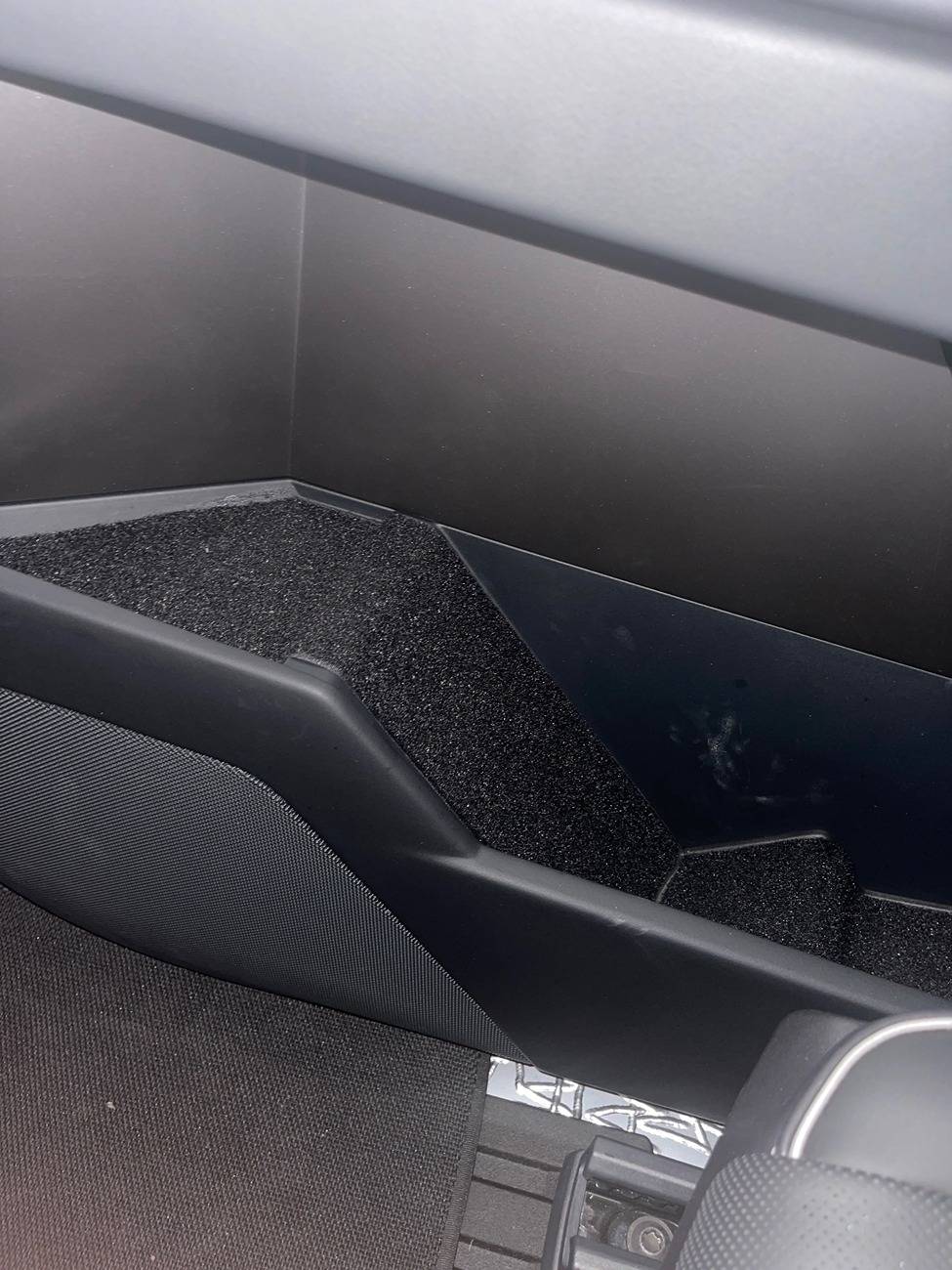

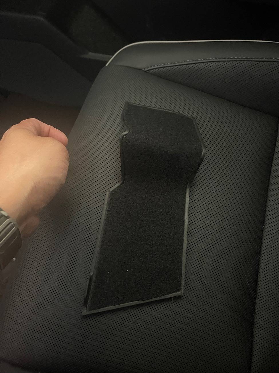

Vibrating Door Storage fix:
So when I first purchased my CT I noticed that anything in the doors would make noise and it was very (super fucking) annoying, so I implemented the fix on my BMW M4 to resolve this, the M4 basically has "loop" padding in all the storage areas (the soft spongey side of velcro essentially).
So with a hobby utility knife (I want to say these were called exacto knives, back in my day, also GET OFF MY LAWN!!!) measure and cut the "loop" piece and stick it into the door, below is the link and pics (dirty I know) of how I did it (for both doors):

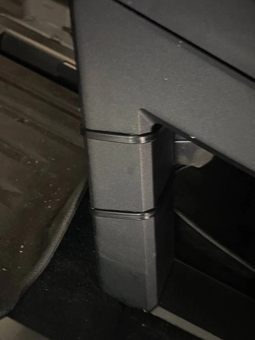

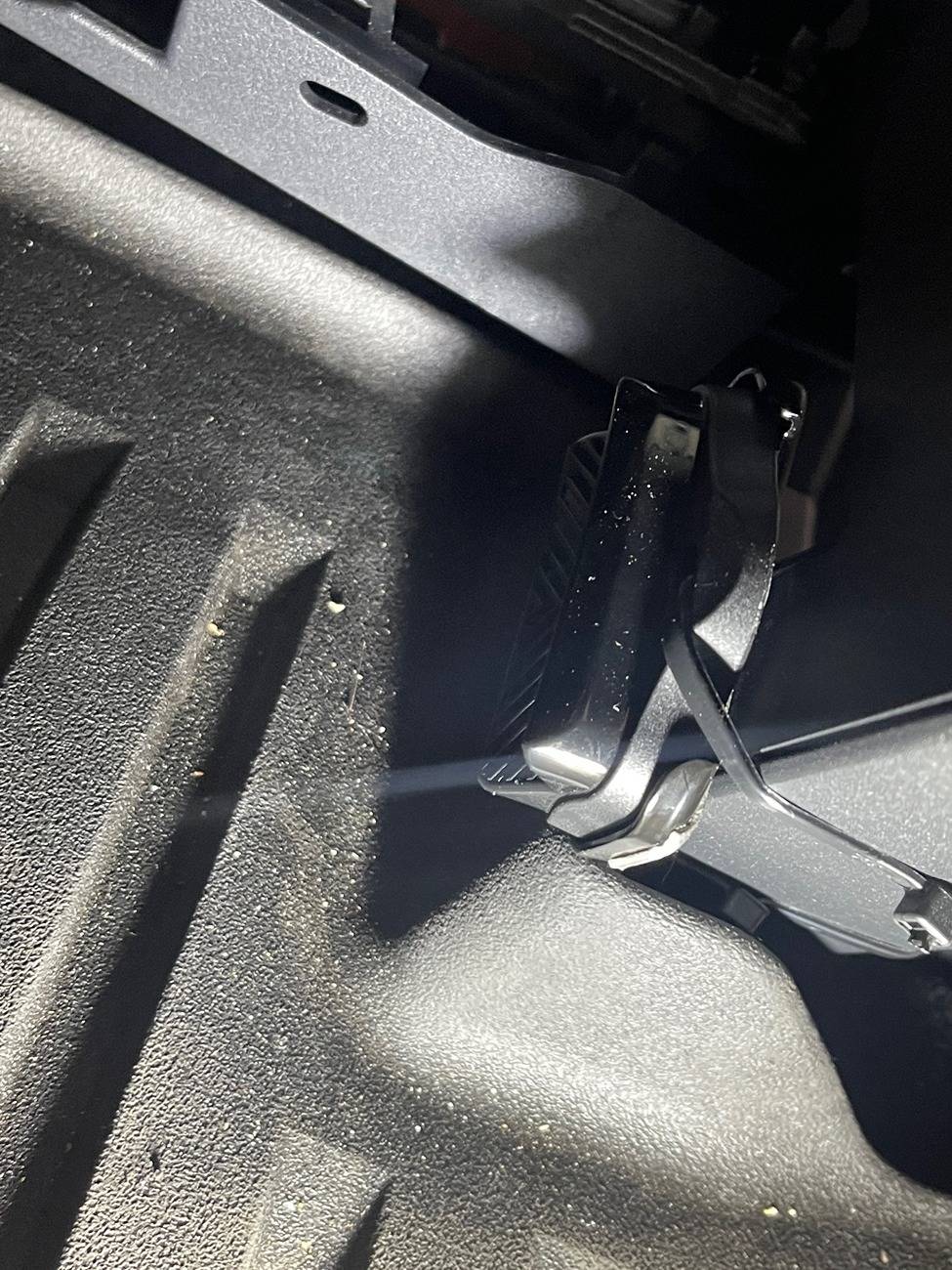

I used a magnetic gun mag mount and two long zip ties to tie the mag down to the driver side "front seat post" I dont know the name but it worked out well, I have kicked and moved the firearm and it has never pulled off the mount:
Door view of Mag. Mount with zip ties
Under seat image of the mount:

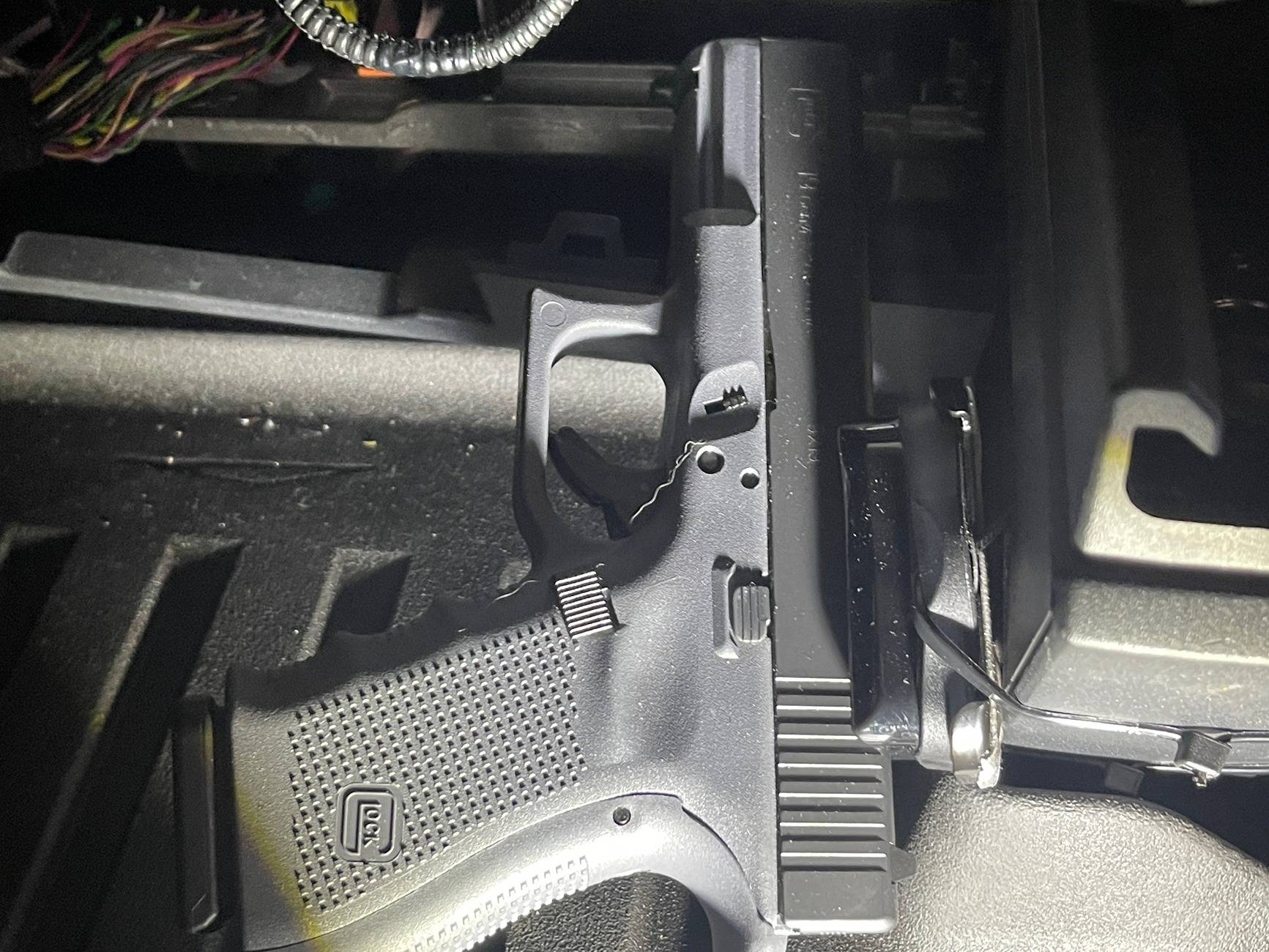

Image of the firearm mounted to the mag. mount, moving the seat forward or back doesn't seem to move the firearm or under seat storage shield
