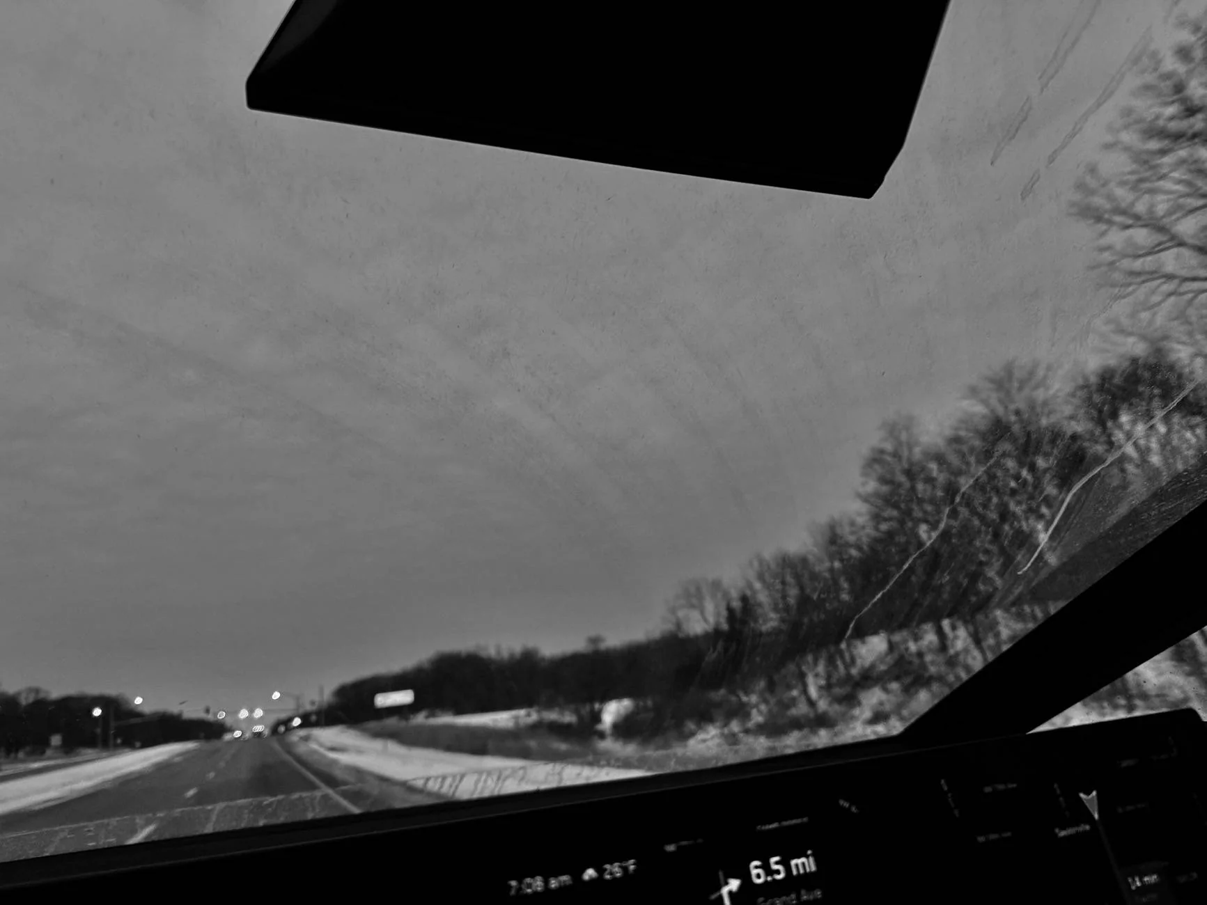

I got the wiper blade recall update done in October and noticed that I wasn't getting any fluid spray so took it back in and they said the pump was bad, in December they replaced that but hadn't really needed to use it much until recently and my pattern looks very similar to what is shown here that no matter how much I spray or when in the cycle I try to spray it, I get the areas that get cleaned and the areas that just get streaks. Hopefully, a new design or update will come out to fix this.
