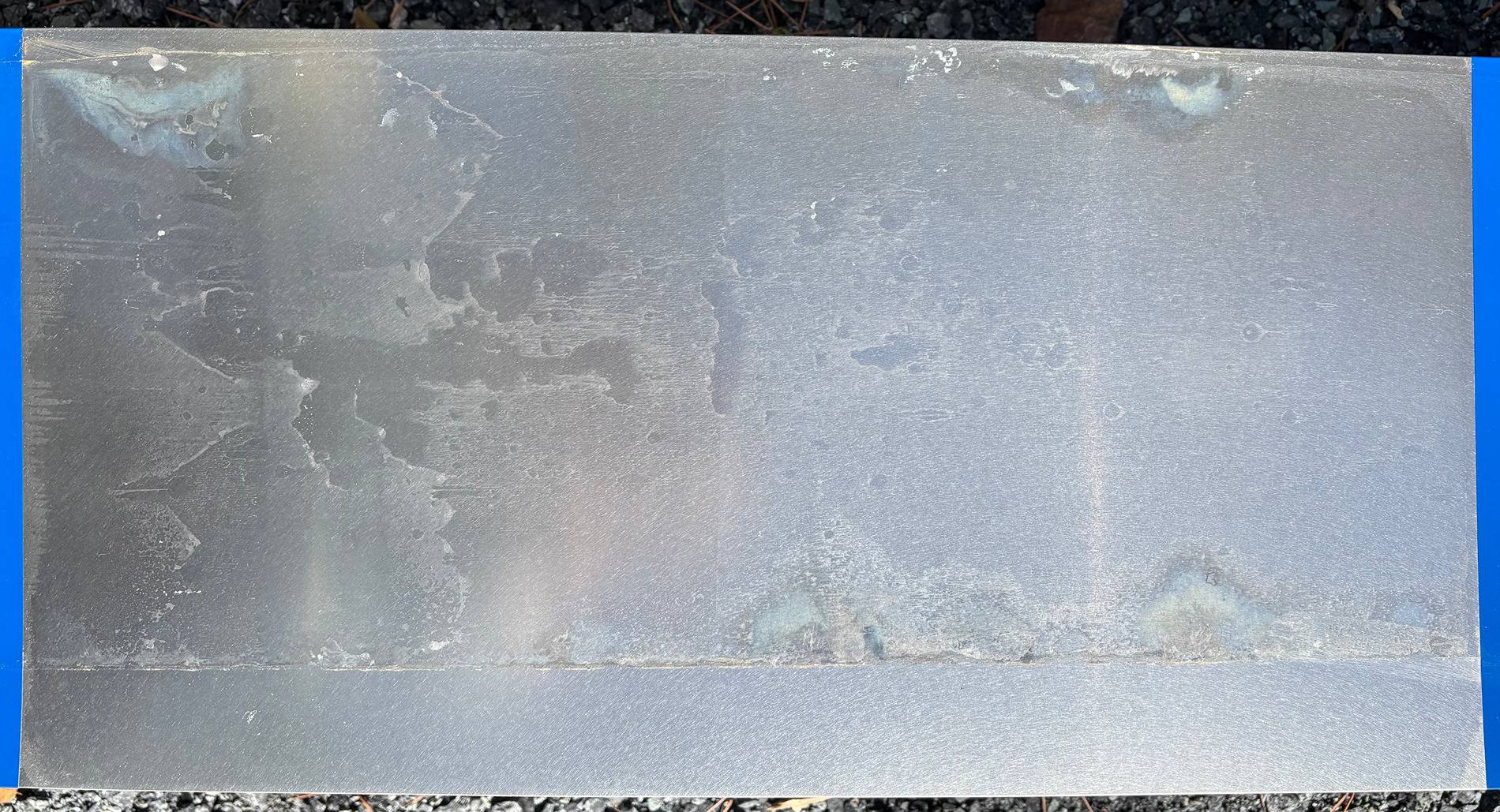

First image is the corrosion damage with a minimal coat of pre-treatment:

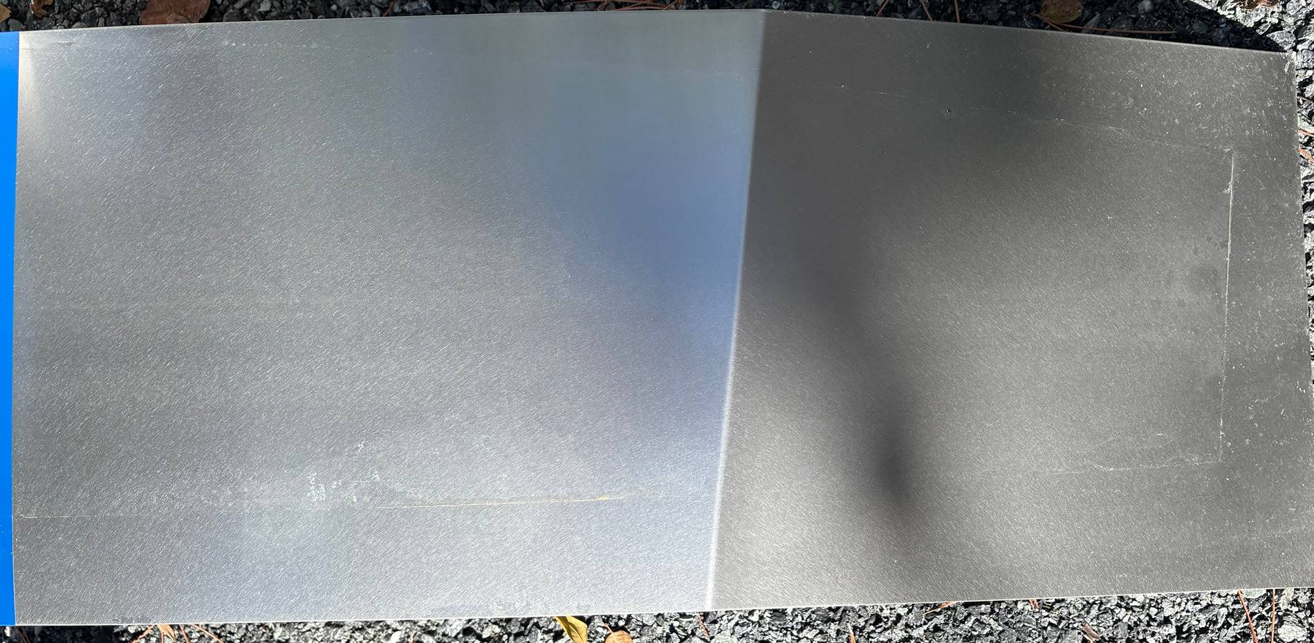

Second image is the corrosion damage with no pre-treatment at all:

Nice, looks like a test sheet of stainless. An interesting experiment at this point would be taking 1/4 of the panel (half of each test section) and trying the standard barkeepers friend polish to see what it could be brought back to.
