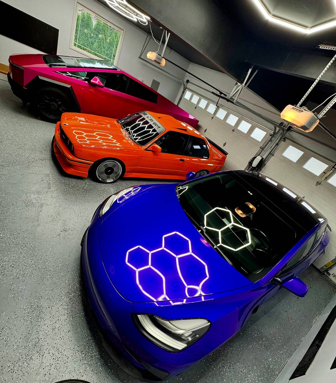

amazing pop.. can you share where you bought the wrap from? between all 3 cars, the color combo is fire.
I bought mine from Metro Restyling, they had a better price than Amazon for the specific color I wanted and free shipping. Ordered on a Thursday and it arrived Sunday, installed that day! Finished at 1:30am ?

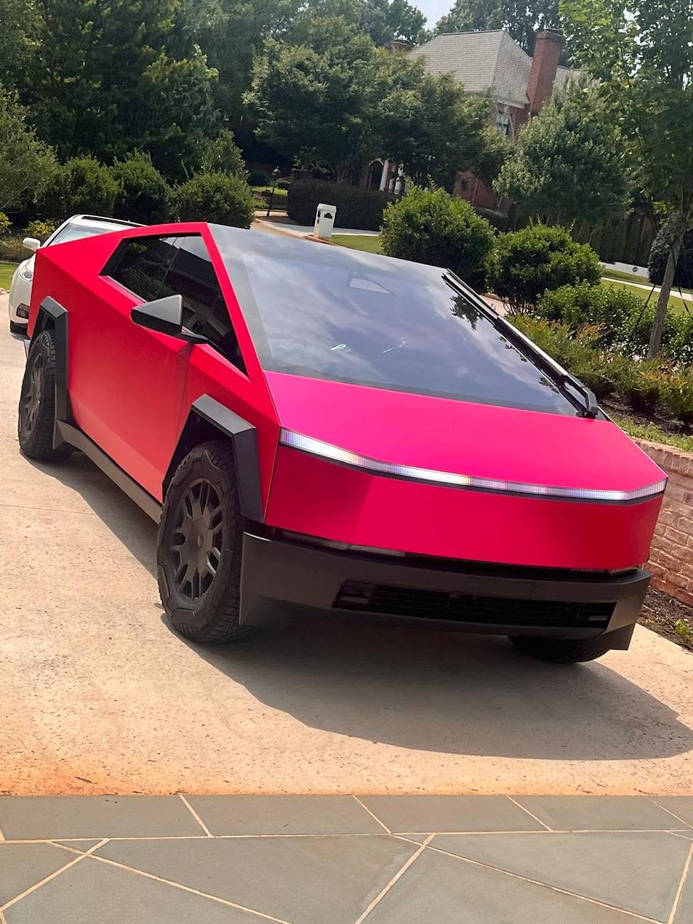

After watching a few videos I decided to try my hand at DIY vinyl wrap. I have had some experience with vinyl wrap on smaller things but this was the first time doing a whole vehicle. I bought a full roll (75ft) of KPMF vinyl from Metro Restyling and got to work right away. I bought a roll instead of a precut kit for two reasons: 1) the roll is about half the price of the precut kits I've seen and 2) the alignment seemed like a pain in the butt from all the videos I watched. I just measured each panel and cut it to size, adding 6" to each dimension to give 3" leeway on each side. It never failed me and I didn't cut a single piece short or come even remotely close to running out.
I pulled the wheel arches and removed the mirrors, that's it. Tsportline's videos were helpful here so I didn't break anything. It took me about 12 hours, full coverage (around the edges) wrap but the second side went so much faster, I bet with the experience I now have it would take 8 hours or less a second time around. I did buy some 3M adhesion promoter sticks that I had to use twice in areas where I wasn't getting good adhesion.
I started with the driver door. In retrospect I think I should have started with the tailgate as it's the easiest to wrap IMHO.
Driver side fender, doors, and rear quarter done. That fender was a bit tricky, my advice would be to make sure your alignment is right after you cut out the hole for the tire/wheel arch. I relied heavily on magnets for this part.
The rear quarter is daunting because it's so big, but pretty easy to wrap. Just takes a little time to work out the bubbles to the edge because it's such a giant piece.
