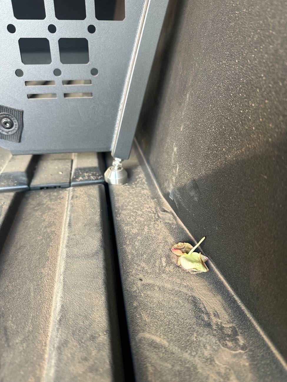

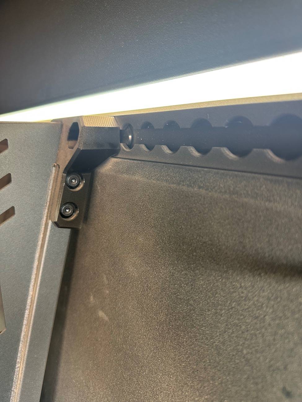

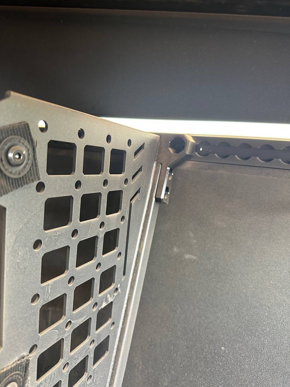

It is a screw and bow tie setup. The screws included are probably 5mm too short to be easy, but if you fiddle a bit they thread in. The piece that attaches to the l track actually has the circles machined into it, so once they are in the l track and tightened… they sit solidly in there (also make it a bit harder to line up). The legs on the bottom just stabilize it all.
