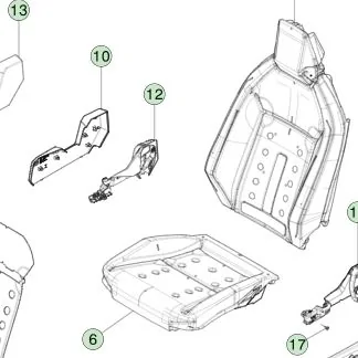

The squeaking piece is labeled (12) - FIRST ROW - RIGHT HAND CYBERBASSET - 1700358-00-F
Spray some lube down the side of the cushion and no more creaking!

Im guessing this will help passenger seat?

Can you show a photo of the seat with the lube point illustrated?
