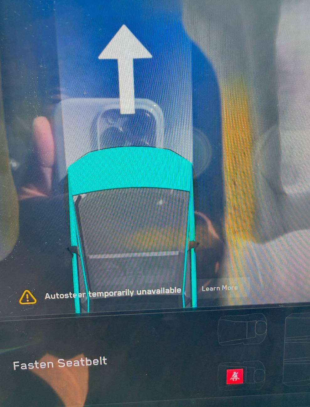

I went in to get Wheel Hubs installed yesterday (BTW the truck looks awesome) and since then FSD and Auto Park is not working. Anyone experience it too? Any remedy?

What error do you get when attempting to park? After service I attempted auto park yesterday and got “take over immediately “ message. I thought it was because the space was crowded and it wasn’t comfortable operating with people walking around..

Is there a little incomplete circle in the upper left of your screen? (I think it was - can't remember for sure).
It's possible your cameras need to recalibrate for FSD/autopark. It took my truck ~30 miles or so of highway driving after my last service before FSD was enabled again.
There might also be a little message on the Autopilot settings page saying it needs to recalibrate, and what percentage it's currently at.
