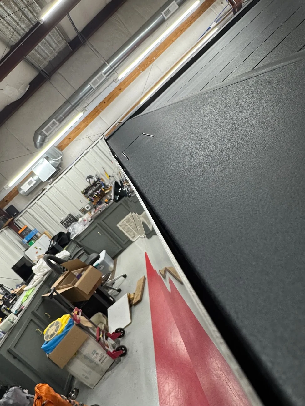

Frunk alignment on one side is slightly off from the other, still not huge, this is me TRYING to find anything less than perfect.

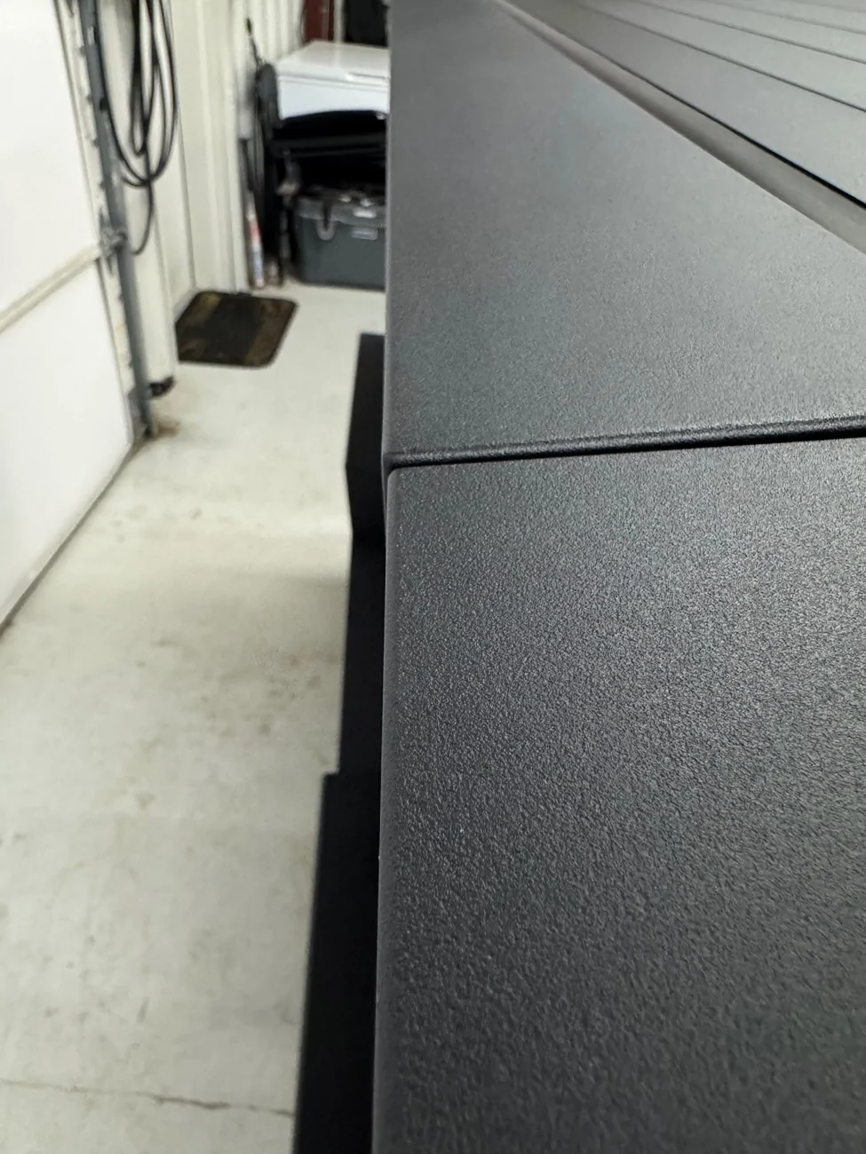

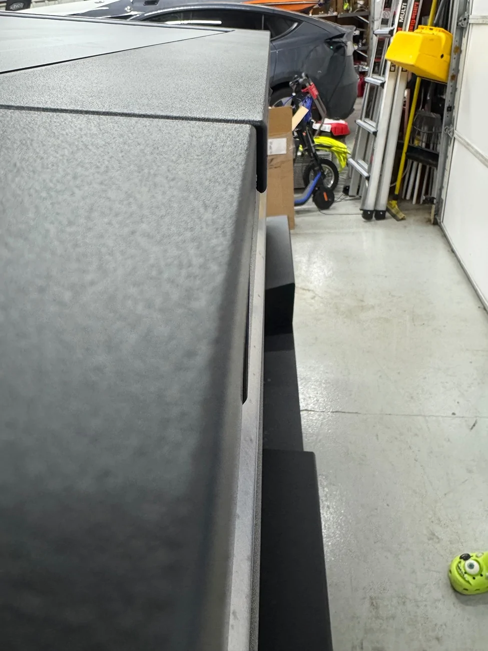

Passenger cantrail joins the front fender just a tiny bit off. Looks like a piece of rubber gasket may be caught up under it slightly.

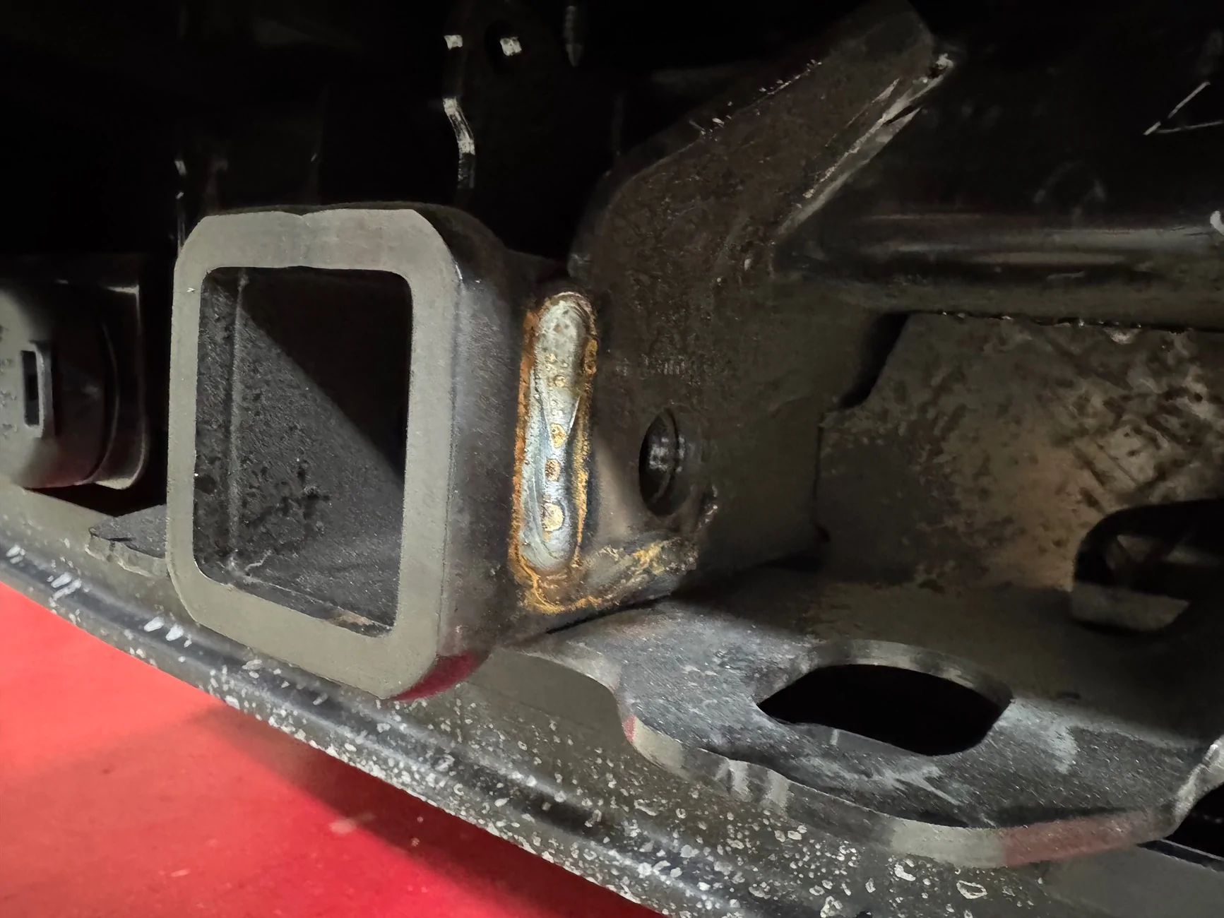

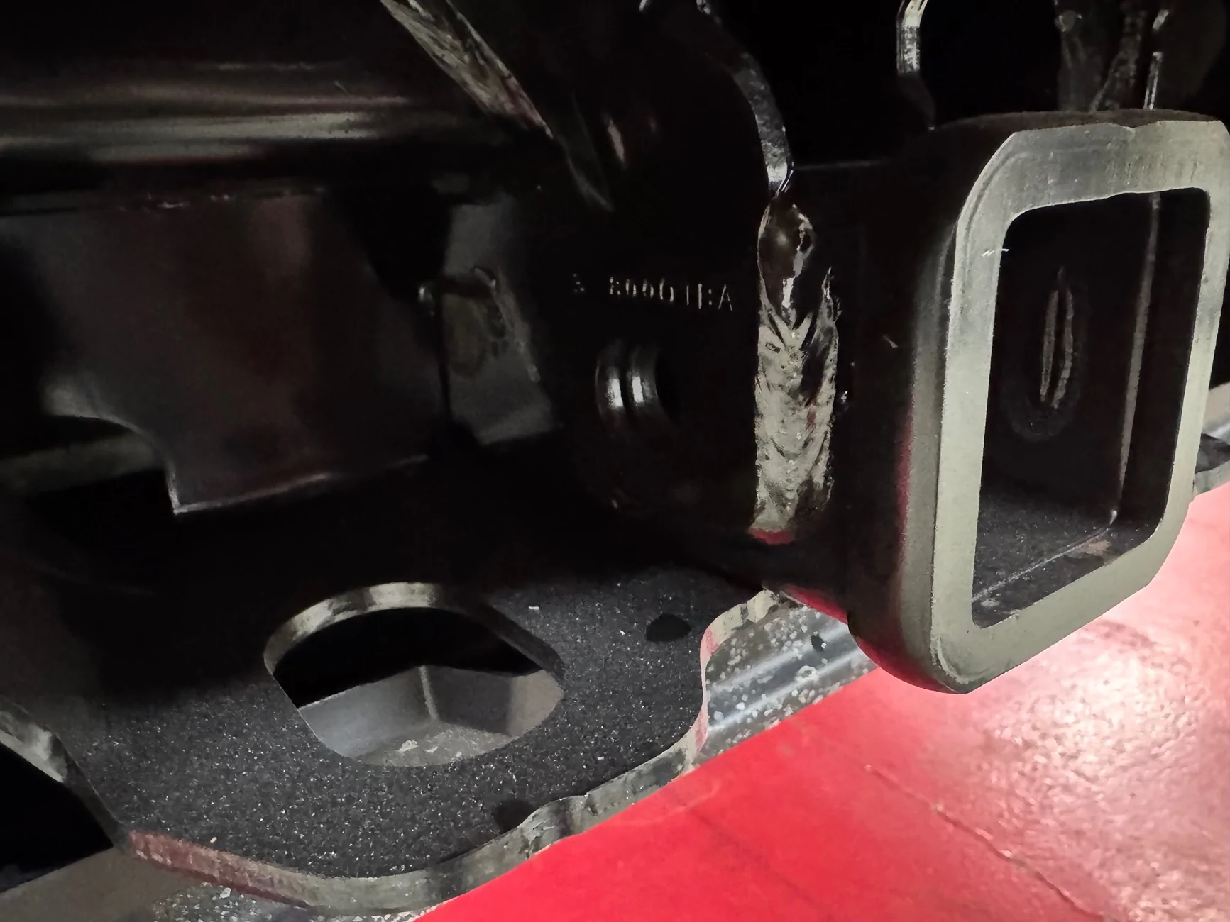

Trailer hitch receiver has a weld on one side that appears they didn’t like and rewelded. That doesn’t have the black protective paint on it so there’s slight surface rust around that.
And a small plastic clip broke at the front of the frunk the second time I opened it.
I was planning to have an alignment done after delivery anyway so I’ll have them replace the plastic clip and inspect/neaten up that hitch weld then.

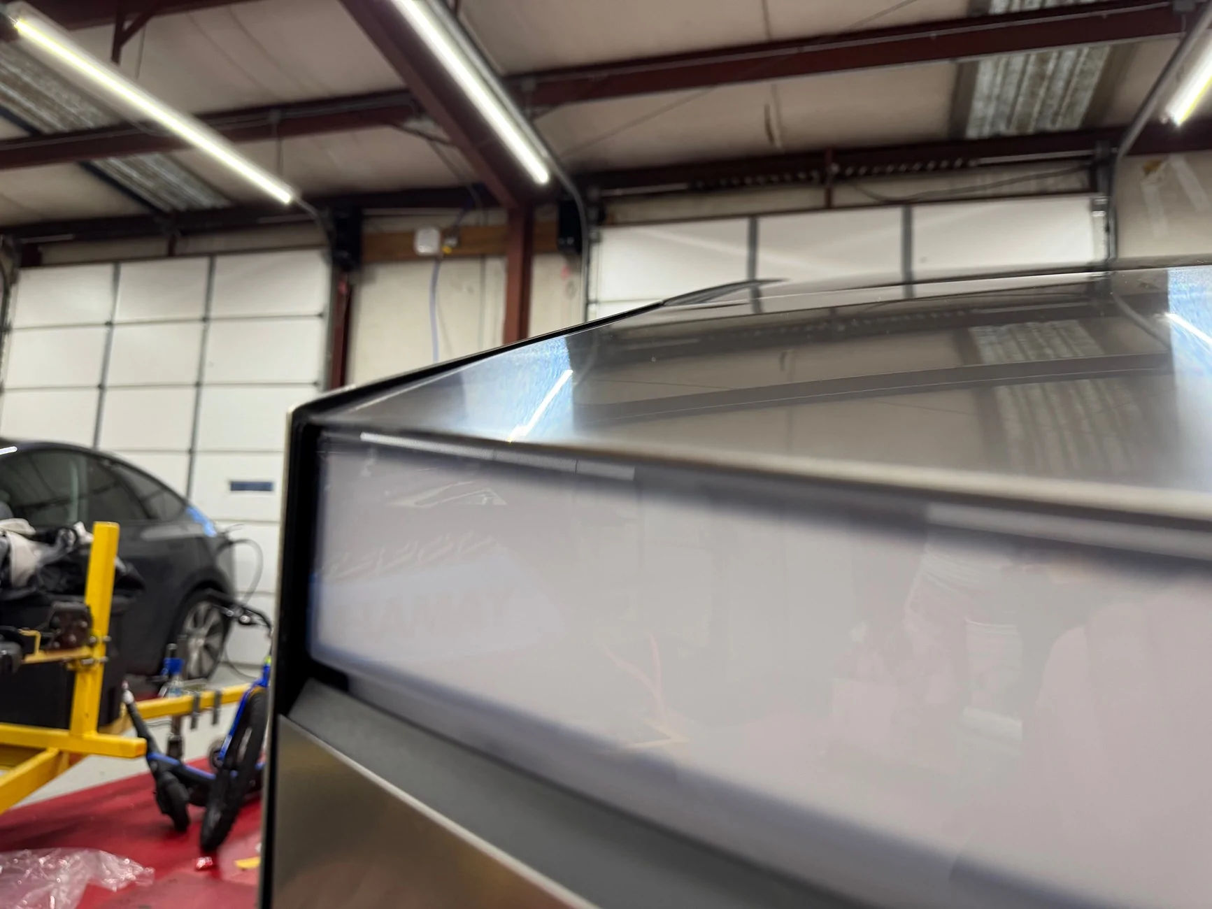

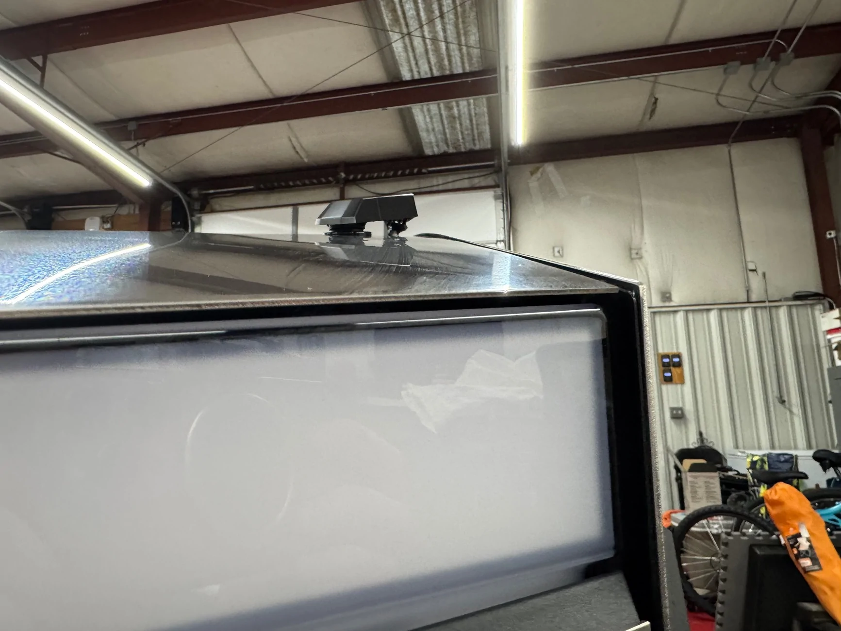

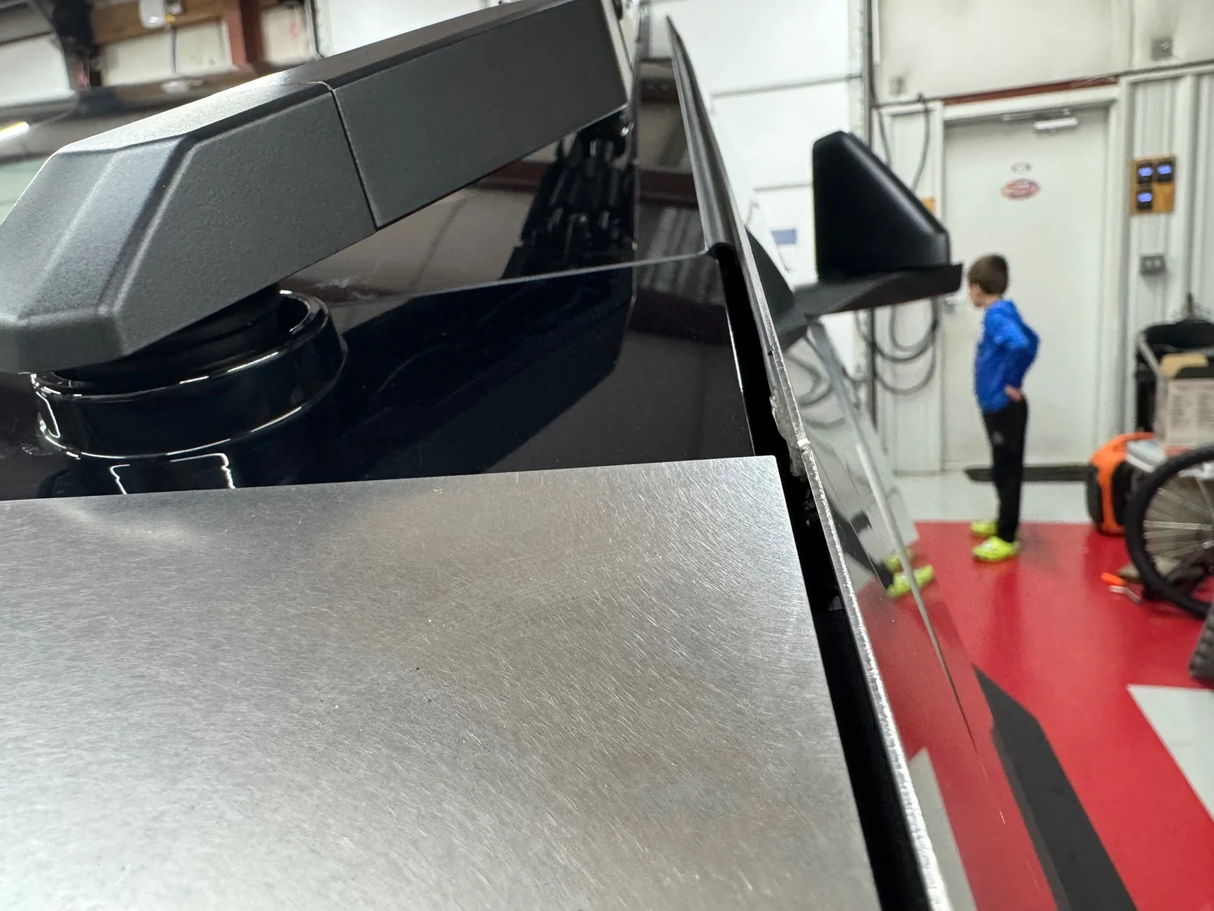

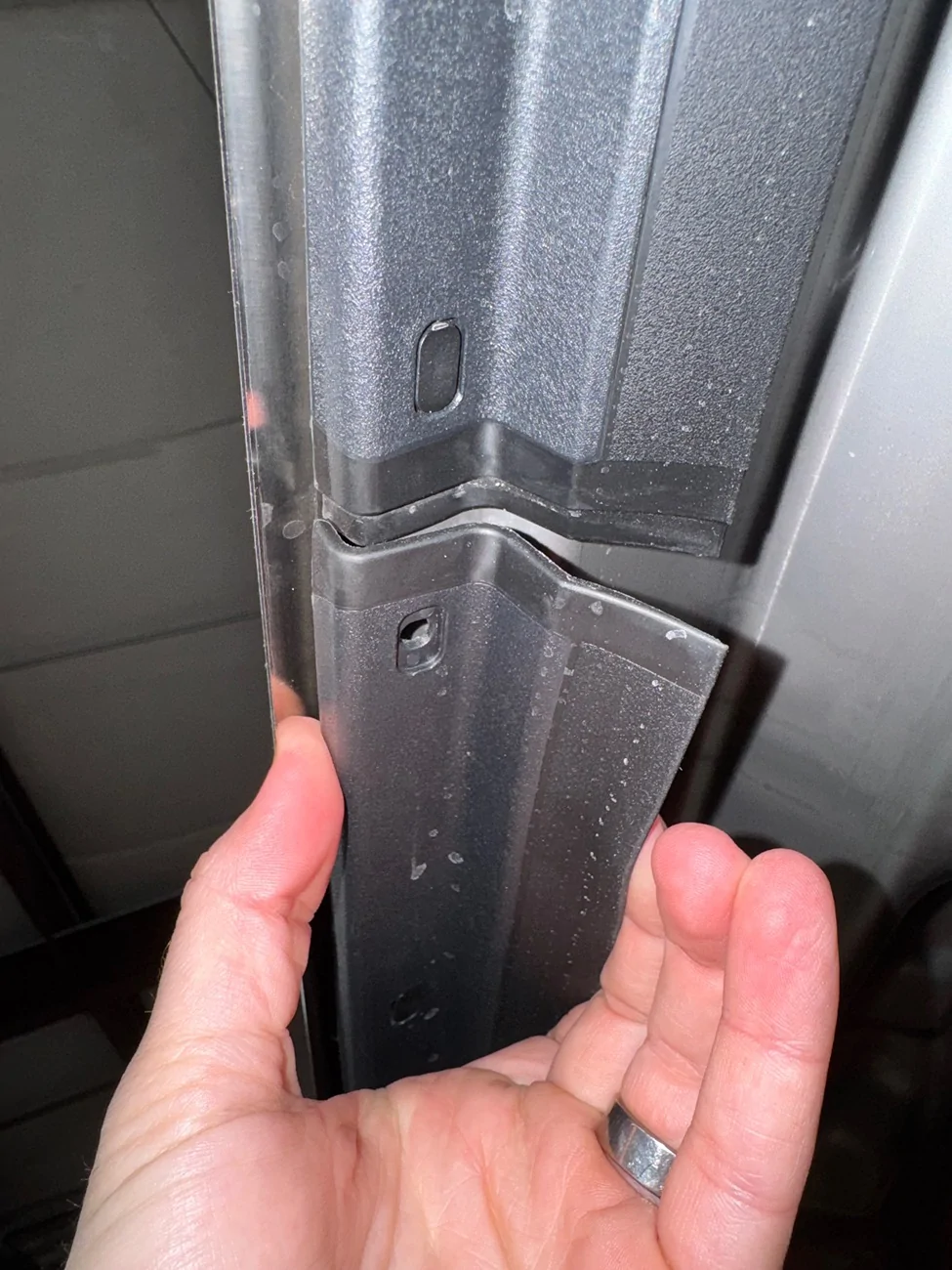

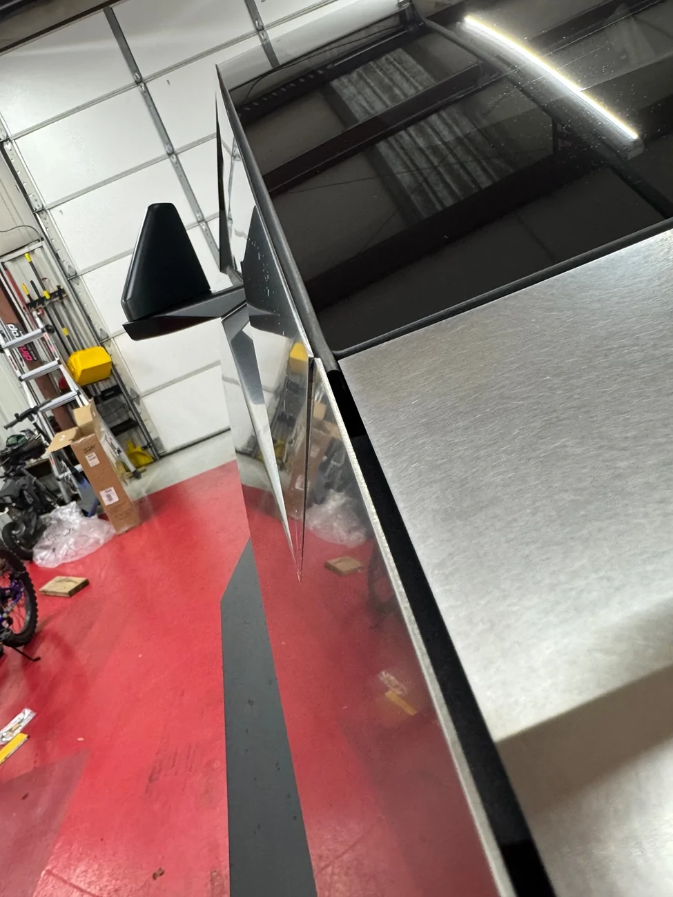

Photos of my “imperfections” mentioned above. It’s very hard to get a photo that shows these well.
Of course they uploaded out of order and I don’t know how to change it.
Driver side of upper frunk
Passenger front cantrail
Driver front cantrail
Passenger side upper frunk
Passenger side tailgate
Driver side tailgate
Driver rear cantrail is a little wobbly at one spot if you look right along it.
Frunk clip
