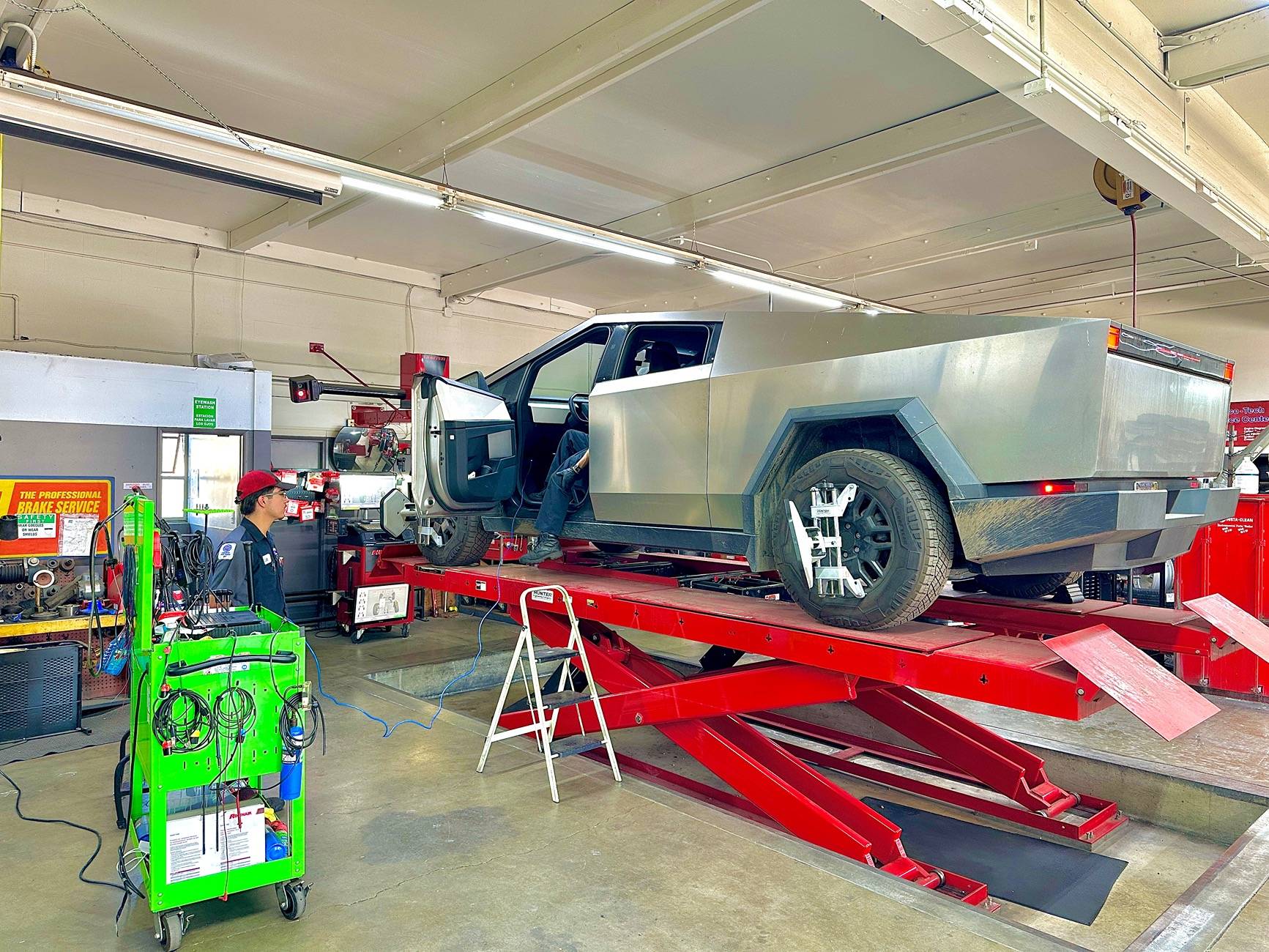

Many thanks to fellow CT owner Scott @TorqMonstr and his team at Connie and Dicks Claremont for the speedy and very capable work on my alignment. After chatting with him for a while, I realized Scott is an expert on all things Tesla and I only wish I had more cars to take to him to work on! I think he probably knows more about Teslas than most Tesla employees. Seriously, they are now the only shop I would consider taking a Tesla to for alignment needs in the Los Angeles area (among the many other things that they do and all the other auto makes they work on).
Scott showed me that from the factory the driver rear wheel had significant toe in, hence my uneven wear, along with some other numbers being off.

Thanks for the kind words and I’m happy we were able to get your truck set up. Thanks again!
