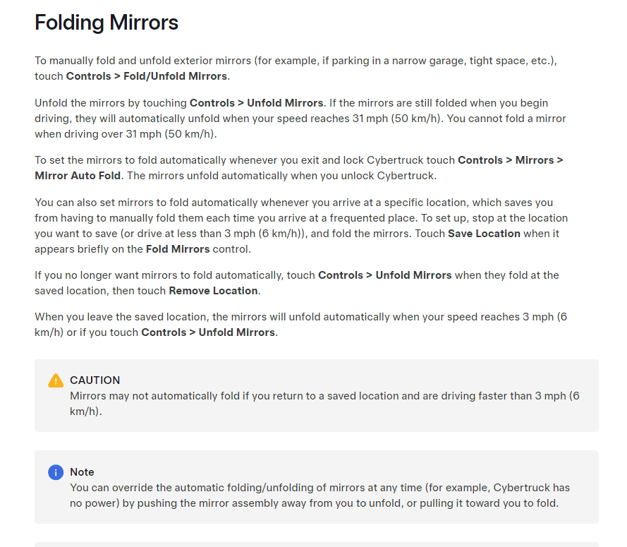

On the controls setting instead of mirrors , you will text called “remove location”
Once you click that
You will see text changes to fold/unfold.
That’s it , you are done … save

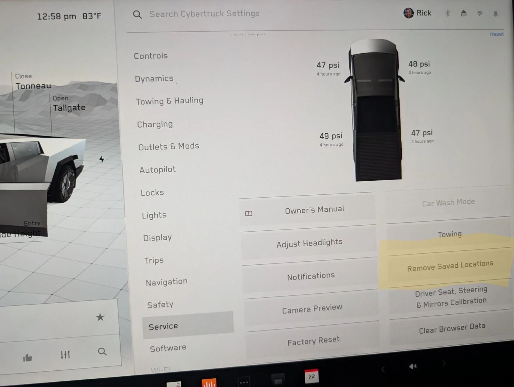

Someone else might beat me to this, but you can also delete all saved locations for either mirror folding, air suspension, or both...at any time without having to wait for it to pop up.
I believe its under "saved locations" in the service menu, or maybe in safety...I need to confirm once I'm back in the truck.

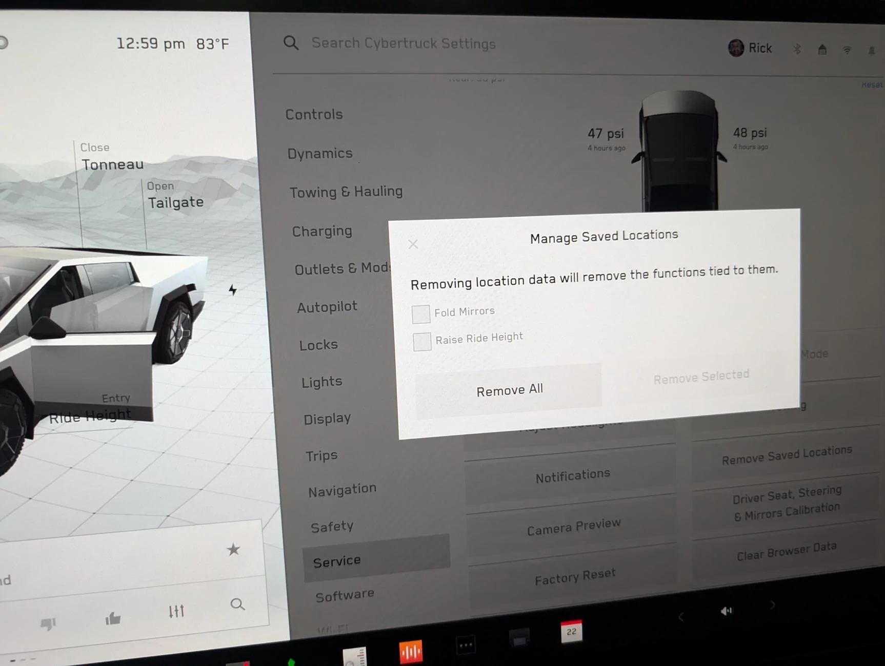

Here we go, got some screenshots. Of course many people may not want to delete all their saved locations, I really only have one for my mirrors so it's easy for me if I accidentally add one to just erase all.
Hope this helps!

I knew someone would have the best answer in the end!
