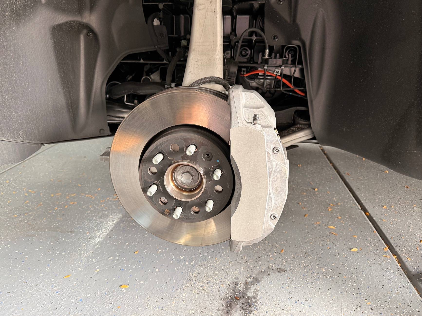

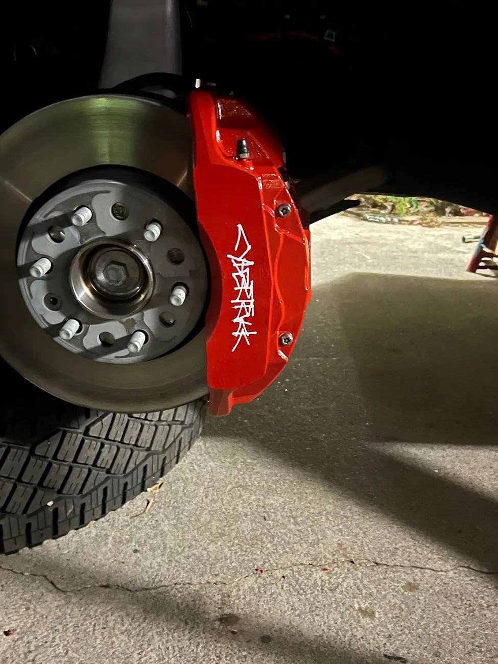

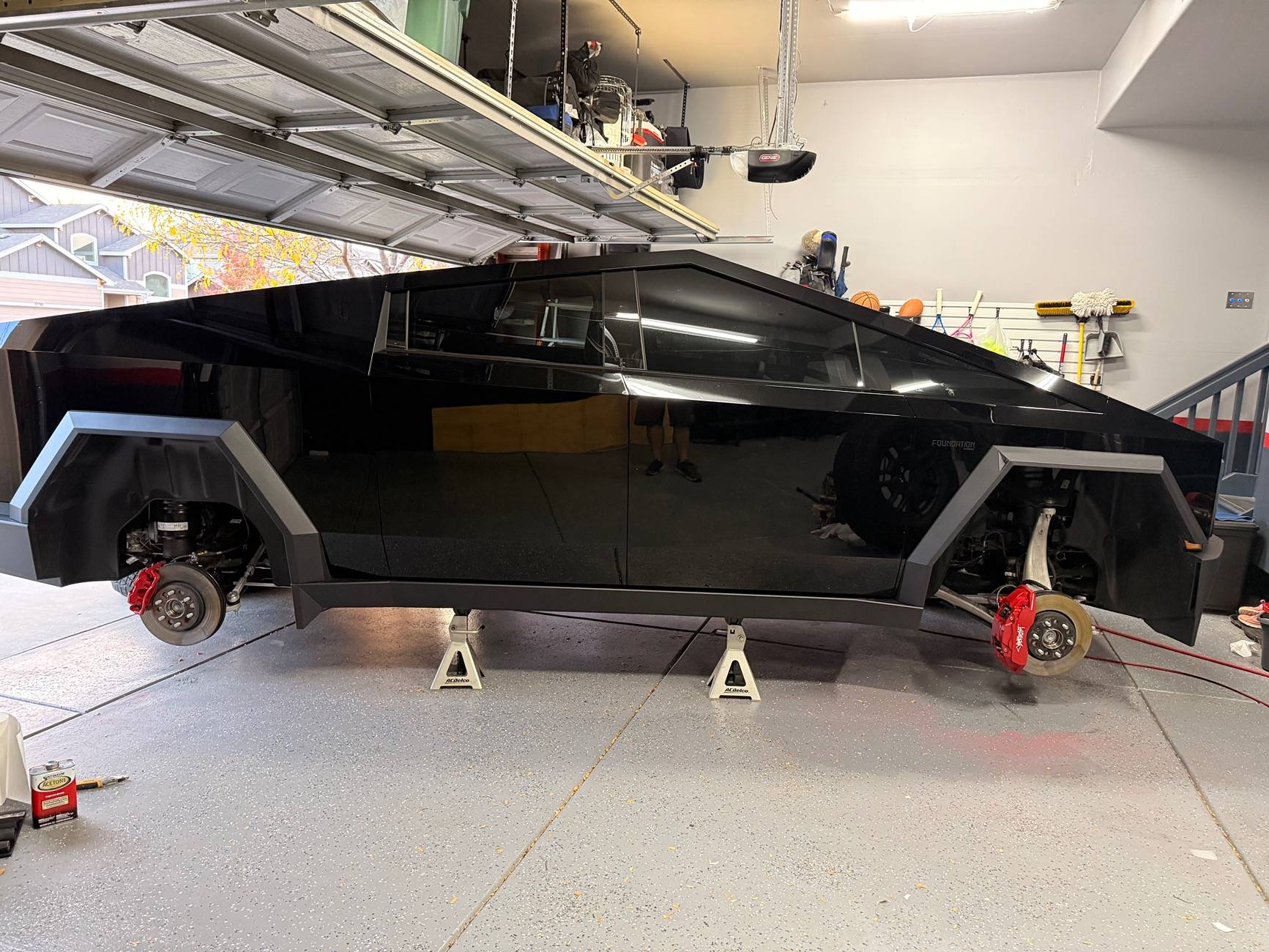

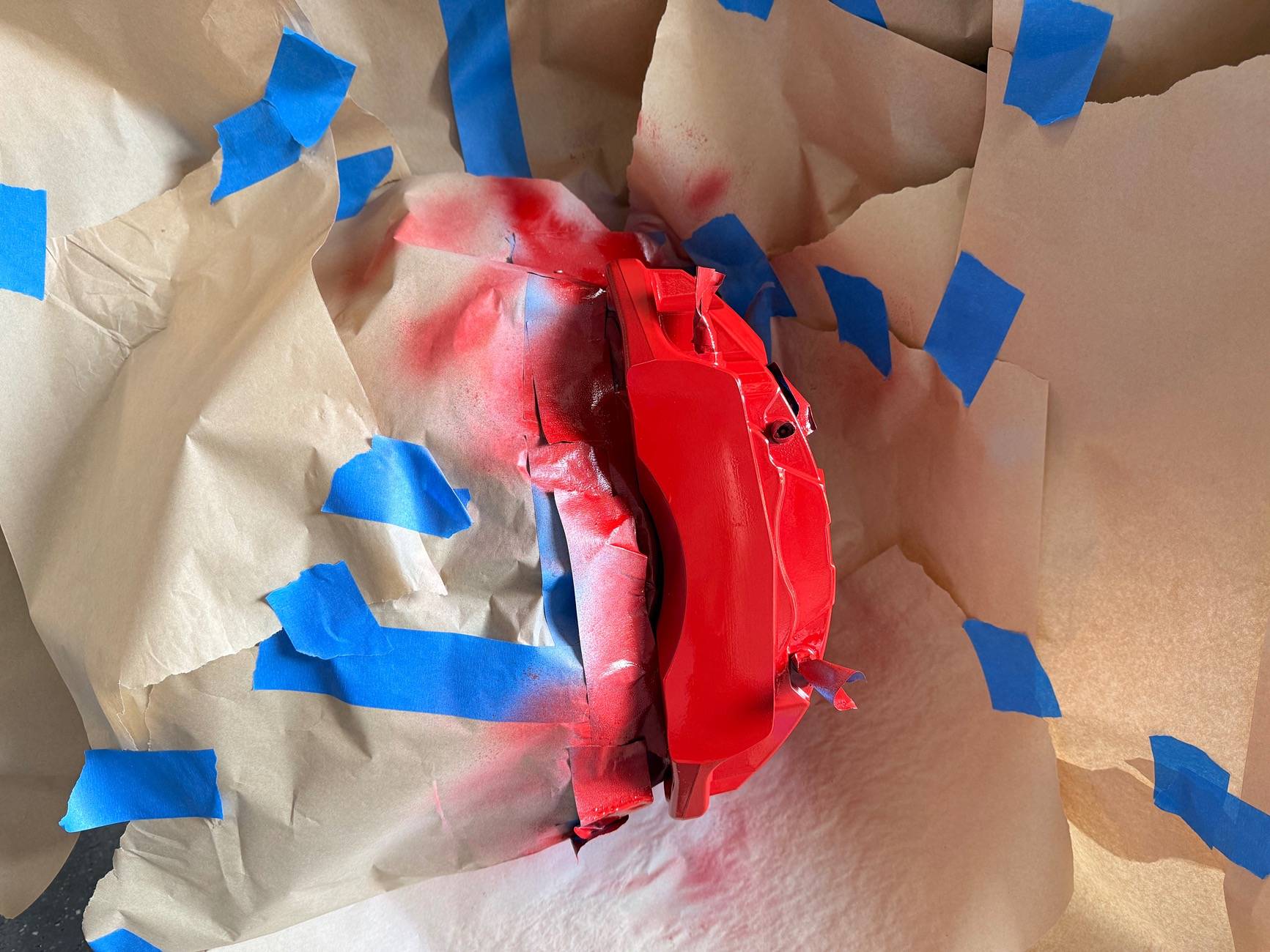

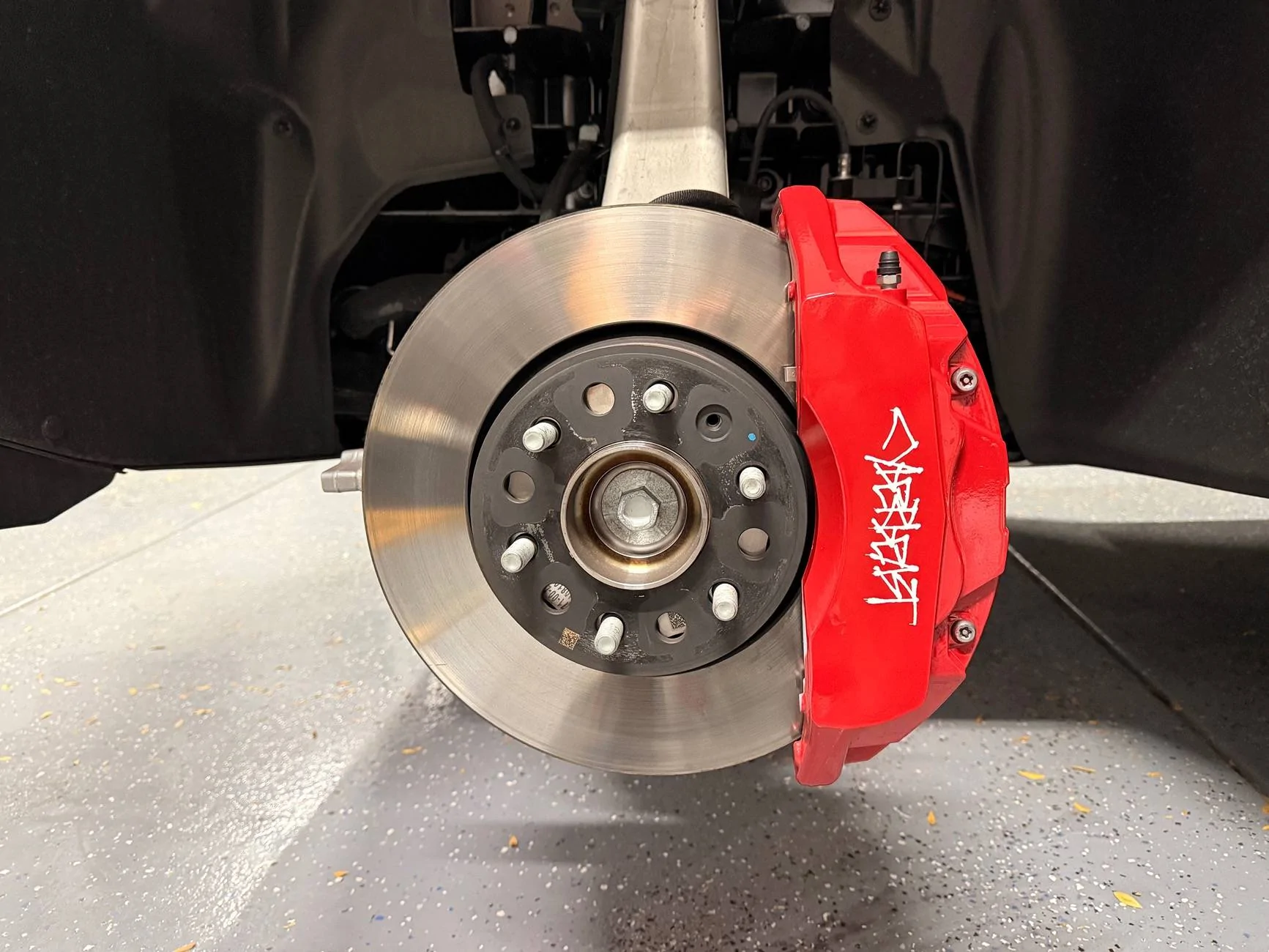

I got tired of looking at all the caliper covers, and how expensive they are, and took the plunge and started painting them myself. I say started, because only got one done today, but looks way better than any cover Iโ€™ve seen so far, and no risk of it falling off and causing damage while driving.
Tesla Cybertruck Painted Calipers DIY ๐ŸŽจ๐Ÿ–Œ๏ธ[updated with steps] IMG_0124
Tesla Cybertruck Painted Calipers DIY ๐ŸŽจ๐Ÿ–Œ๏ธ[updated with steps] IMG_0130
Tesla Cybertruck Painted Calipers DIY ๐ŸŽจ๐Ÿ–Œ๏ธ[updated with steps] IMG_0131
Tesla Cybertruck Painted Calipers DIY ๐ŸŽจ๐Ÿ–Œ๏ธ[updated with steps] IMG_0137
The sticker is a Tsport caliper sticker.
Tesla Cybertruck Painted Calipers DIY ๐ŸŽจ๐Ÿ–Œ๏ธ[updated with steps] IMG_0140
Tesla Cybertruck Painted Calipers DIY ๐ŸŽจ๐Ÿ–Œ๏ธ[updated with steps] IMG_0139

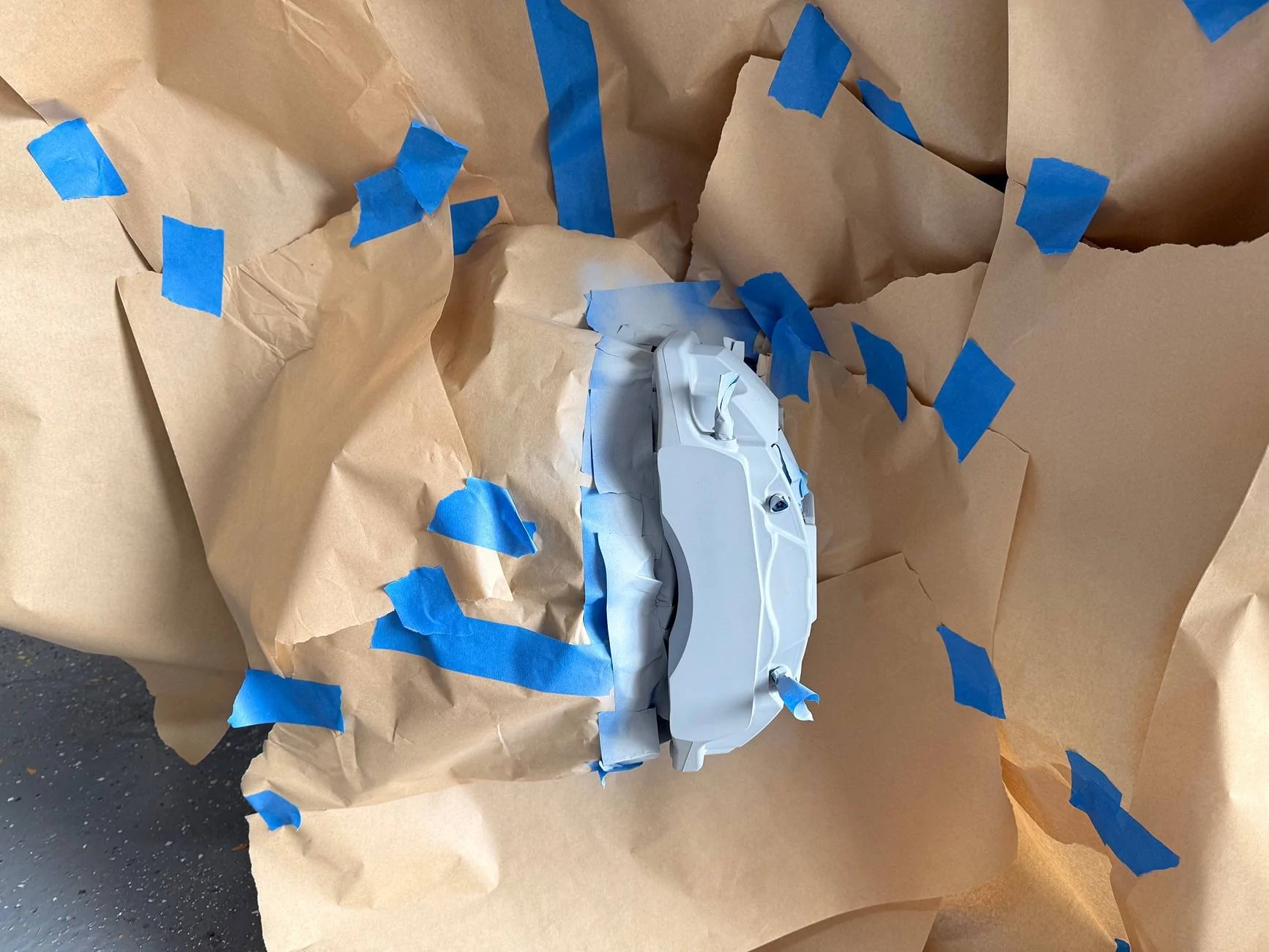

Steps:
1. Clean the calipers, I just used store brand brake cleaner. Worked well. Used a lot
2. Sand the calipers with 220, I didnโ€™t do the rear ones, it wouldnโ€™t have helped the overall look at all.
3. Tape off, this is the worst longest part of the whole thing. It took about 15-20 minutes per wheel.
4. Primered the brake caliper with high temp caliper primer. 2 light coats 10 minutes apart, then wait one hour.
5. Sanded with 440p. And cleaned, water and alcohol
5. Painted with high temp caliper paint. 2 light coats, and one medium wet coat, 10 minutes apart, let dry 1 hour
6. Put the stickers on.
7. 3 coats of high temp clear coat, same as the paint.

nice, how did you clean them prior to painting?
Caliper Cleaner, a lot of it. Then sanded all the flat surfaces with 180g, then caliper cleaner again. Then sanded with 600g after the primer.

These are the biggest calipers I think Iโ€™ve ever seen on a vehicle, at least the fronts. And I used to work at a TA fixing semi. (Doesnโ€™t mean I think they are the biggest). But I do think the bolts holding them on are the biggest.

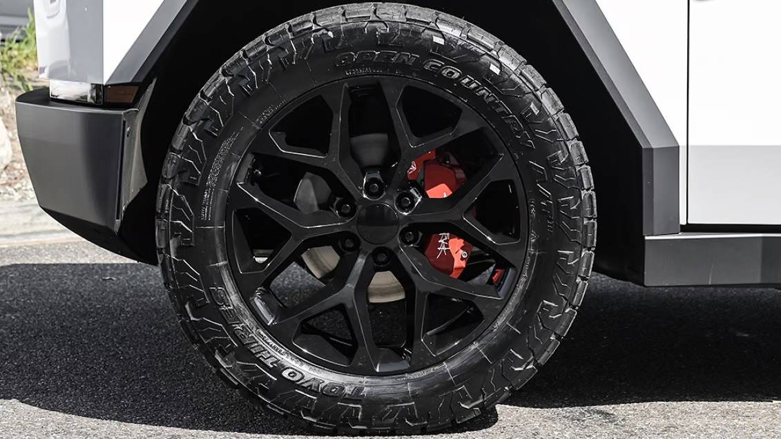

Good stuff you should include what you used and how it worked as well. I did mine. I used
G2 High Temperature Brake Caliper Paint System Set RED G2160 - High Gloss
https://a.co/d/8WPPQOR
Worked great anyone can do it just take your time and prep itโ€™s all in the prep, the ct has larger then normal
Face surface so it worked best to do some sanding on that face for the paint to take nicely I split the mix in half so I could do the front wheels then put them back on and do the rear after plenty of paint I did like 5 coats Way cheaper to do your self! I think with the stickers this me me total about $120 !Donโ€™t be intimidate you can do this ?

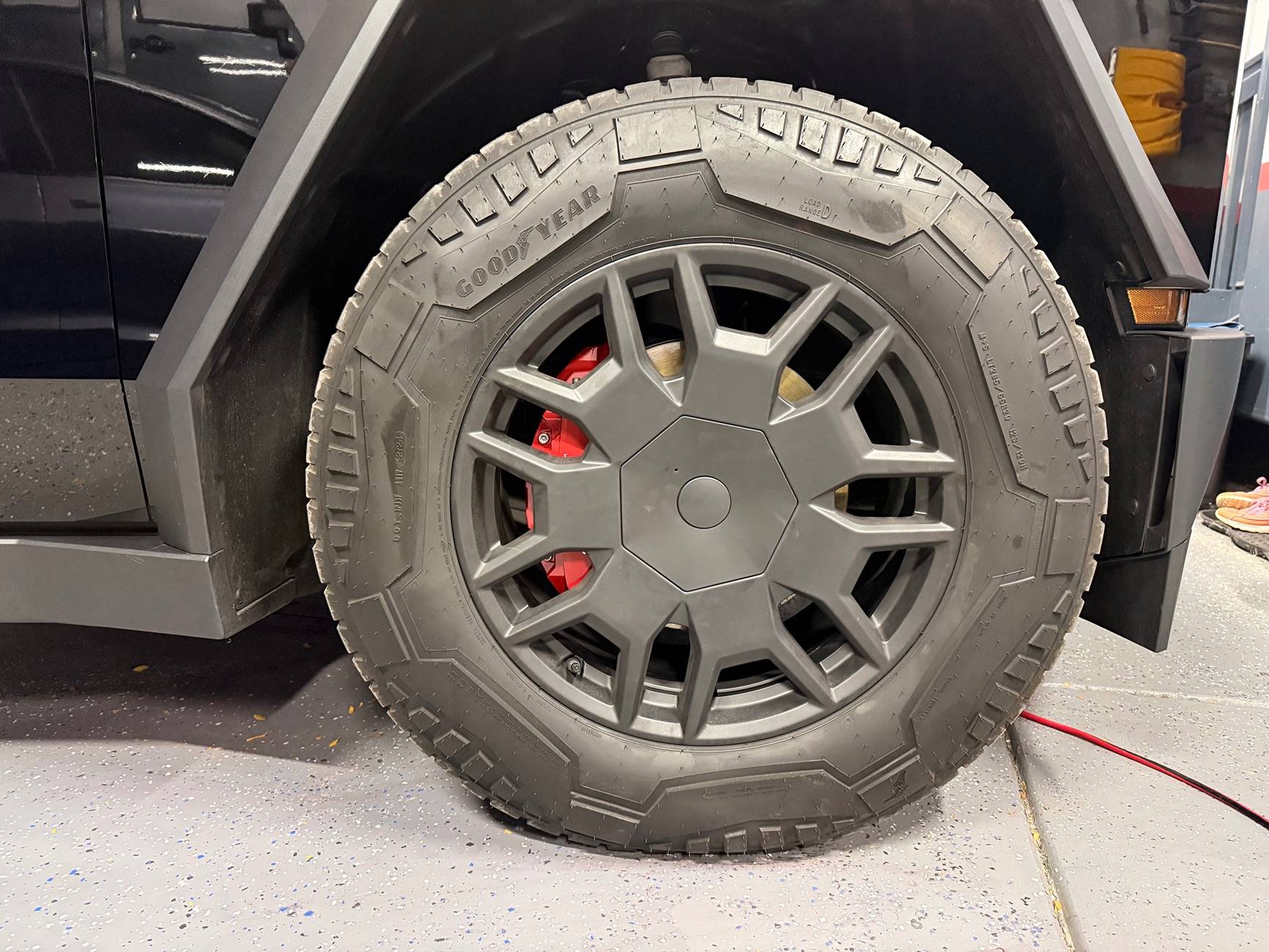

Iโ€™ll update with all the steps and more pictures once I finish all the brakes. But yes, prep takes the longest by a long shot. I now need better wheels to see the brakes better.
