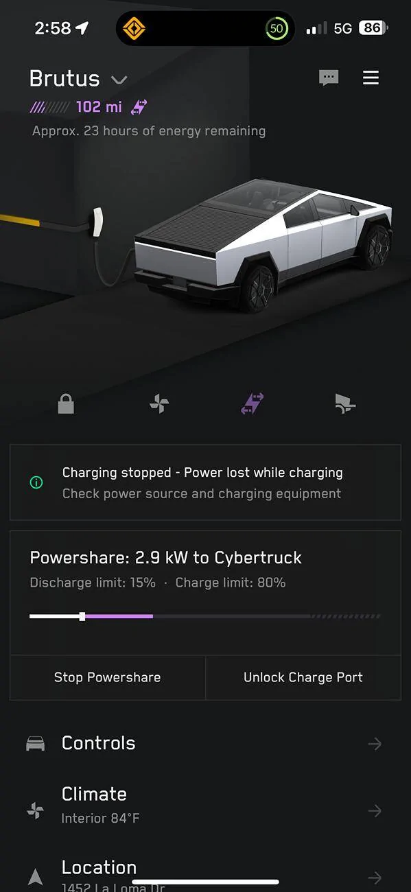

Everything seemed to work for me. They dropped the new solar circuit into the Gateway instead of the main panel, and when we cut the power to the grid Solar kept working and the panels were both feeding backed up circuits and charging the car.
And an earthquake just hit here in OC - hope I don’t need it.
Tesla Cybertruck Powershare Update - Solar while islanding without powerwall IMG_9541
